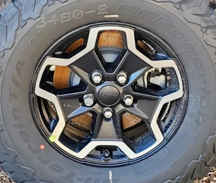

Not to deviate from your original questions, but in case you didn't know, there are a lot of people that sell their new Rubicon wheels and tires and you could pick up a set of 5 with tires and TPMS already installed and included for cheaper than buying 5 of the wheels you mentioned above.
To answer your question, a 2023 Rubicon wheels looks like this:

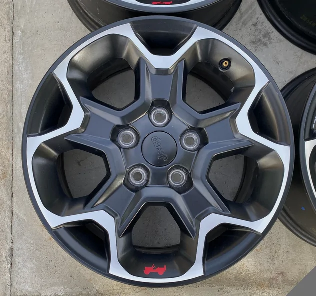

Subtle difference, but my '23 Rubicon wheels look like this:
Jeep Wrangler JL Are these Rubicon Wheels? 23RubiconWheel
