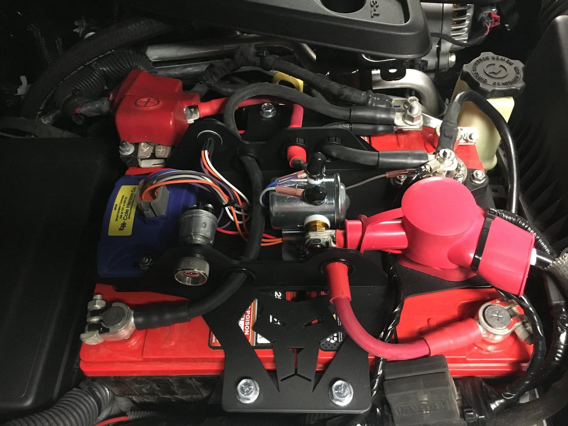

Jeep Wrangler JL ARB Under Seat mount issues E6663345-3E43-4845-A34C-0F39B8C2AD25
It is possible to use the drain plug under the seat, I was extremely careful in running the power cables and they were long enough. I have a dual battery set up and they are still long enough to reach. You can see the fuses in the lower right of the photo.
