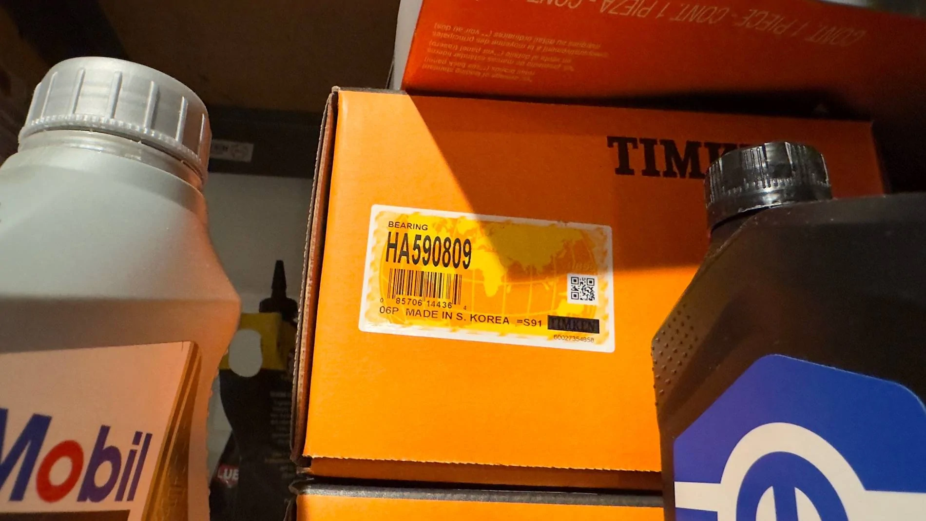

I had a tighter budget with lots of things needing addressed. Used to, I’d use Moog but it seems I’ve had newer cars for a while and didn’t know that Moog is crap these days. Damn shame. They had the problem solver series improving factory designs and everything. Sad.
After some research into lower priced aftermarket, SKF and Timken seemed to have less negative comments. Seems hit or miss what the origin country is from model to model.
Here’s the Timken part number going into my 21 Rubicon.
Can you please take a picture of the actual bearing and any labels they might have? Very much interested if they are actually made by Timken. I know sometimes they re-box other brands. These are for a JL correct? Seeing as the box says "Made is S Korea" tells me that likely these are the same as the ILJIN OEM as that is where ILJIN manufactures theirs
