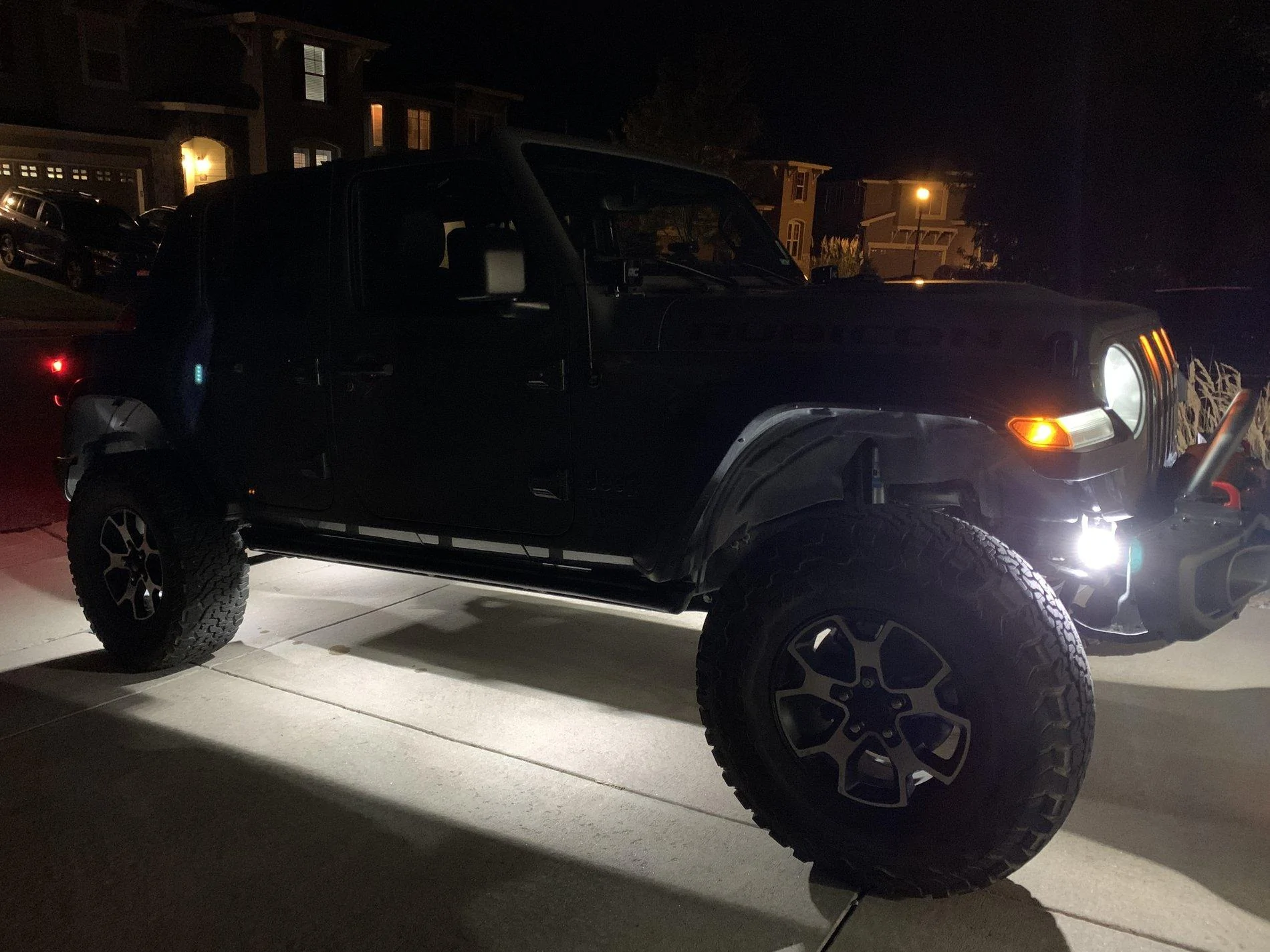

Where did you end up sticking them? Are you running single color white lights or RGBs? If RBG where did you end up putting the control box?
Single color, no control box. One is centered below the rear cargo area (I have a muffler delete so its open). Two along the front and rear of the rock sliders on each side. One on the crossbar right below the front of the motor, and two on each side of the winch Mount I have on the bumper. If I didn’t have that, it would be tricky to find a good spot up front since it’s mostly plastic. The light coverage is great all around.

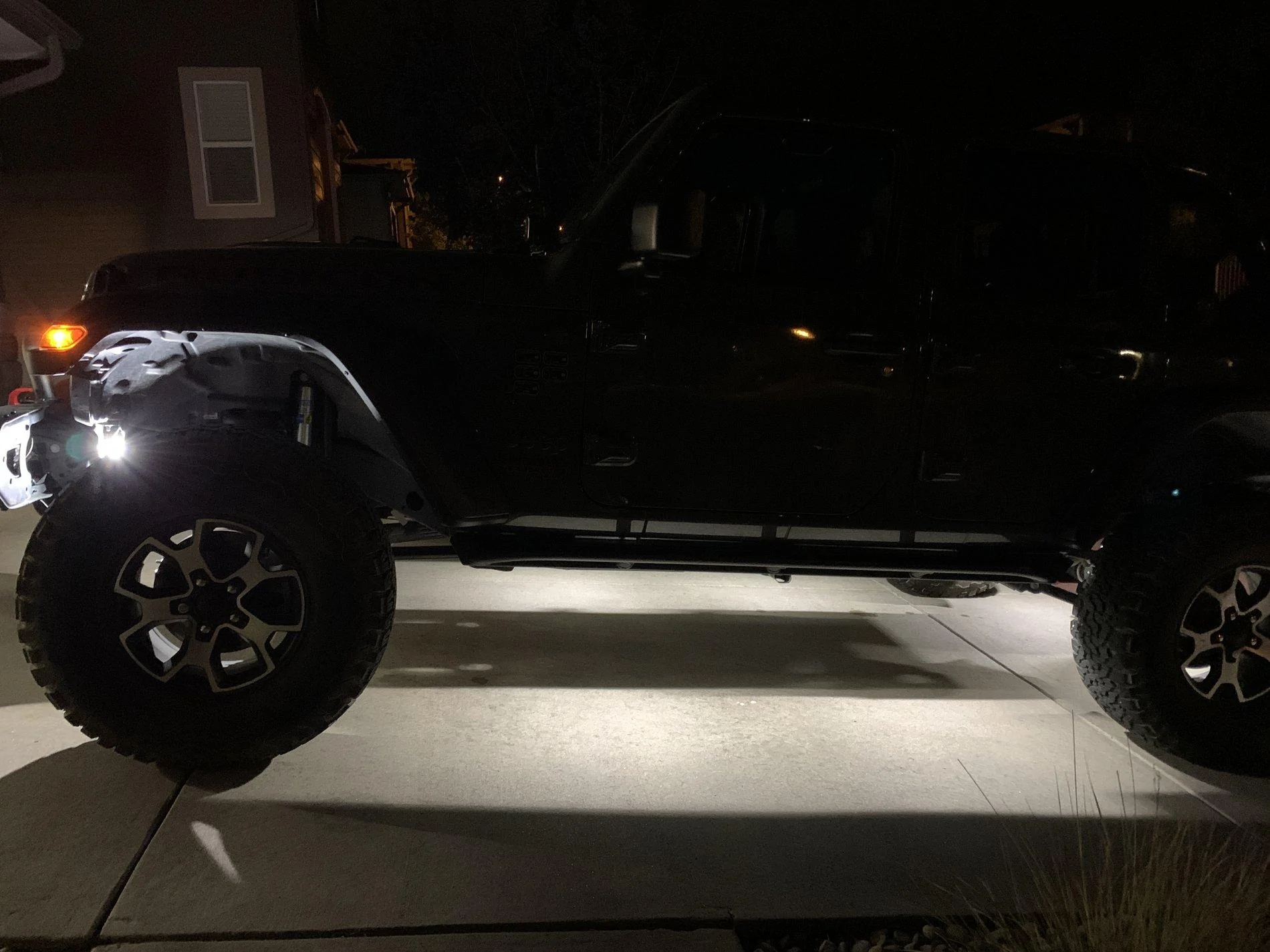

I just got mine in..what I didn't think about is the wheel wells are plastic so the magnets don't have anything to attach to. You can put them down low but the lights shoot straight out. Lux does sell the metal brackets so I just ordered one for each wheel well. Hope this helps somebody when you order.

Where did you mount yours in the front wheel well?
I mounted one on the frame in front of the front wheel and another under the bumper alongside my shackles (so two on each side for the front wheel). I actually have 12 RGB's (overkill), I'm running them in two zones. Zone 1 is the two under the front bumper and the two under the rear bumper. Zone 2 is the two on the frame in front of the front wheels, then the 6 under the rock rails (two behind the front wheels on the rock rail mounts, two in the middle of the rock rail mounts and two in front of the rear wheels at the rear of the rock rail mounts). I'm actually going to run two white Lux lights on a separate switch on zone 3 for under hood engine compartment light. I was originally going to use two of the RGBs for under hood light but zone 3 is designed to use white lights.
