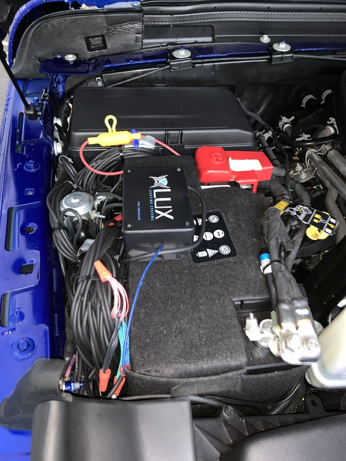

I used a piece of adhesive hook Velcro on the bottom of the control box. That sticks right to the battery cover. Don’t mind all the extra wiring, still a ton of slack (trial mode) to make sure the lights are where I want them.
