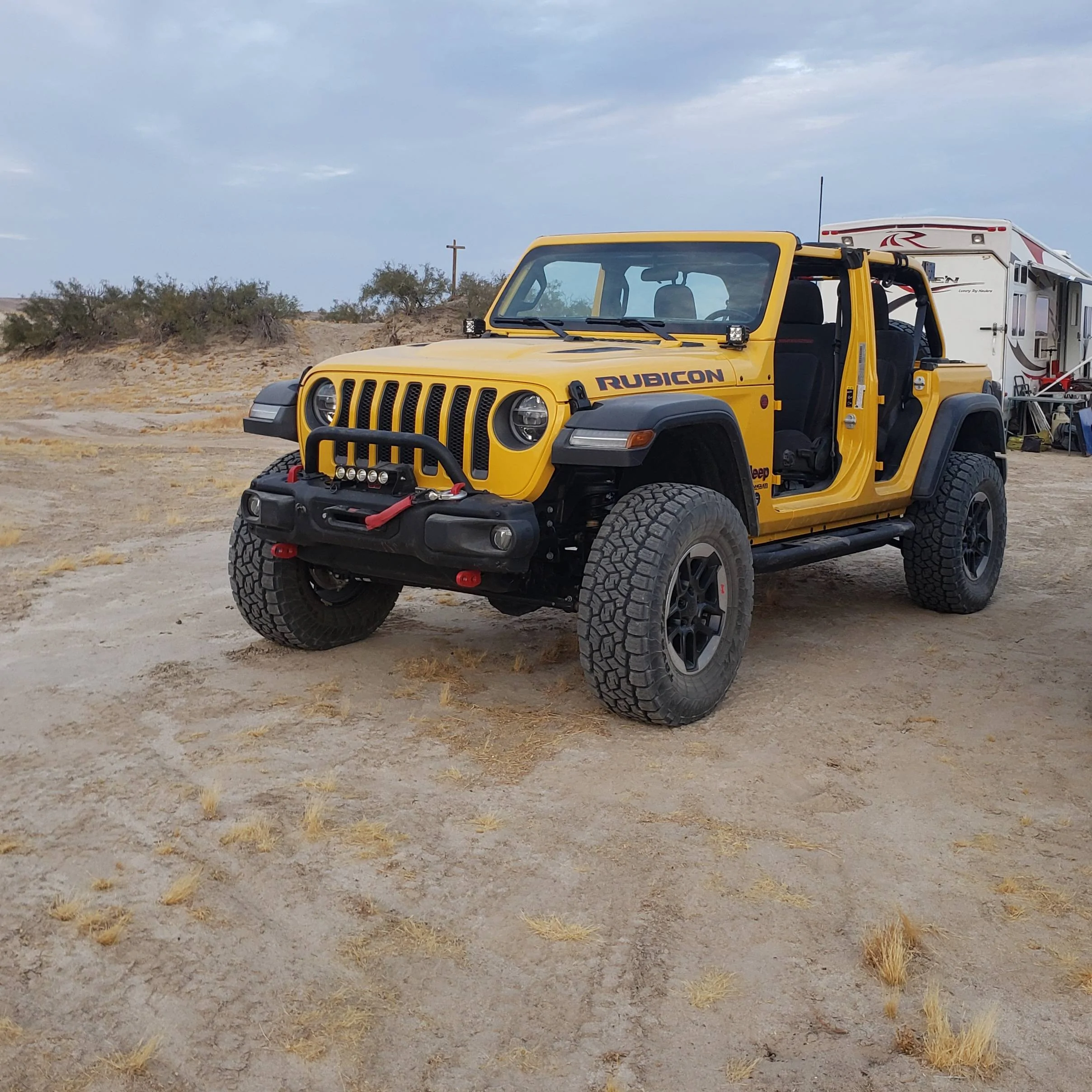

Ran 35x12.5's for a couple years on my Rubi rims before getting new rims..... seemed to work good for me (little bit of crowning but not too bad, ran them around 32psi).....but, everyone is different and runs tires and rims for where they like to primarily Jeep.

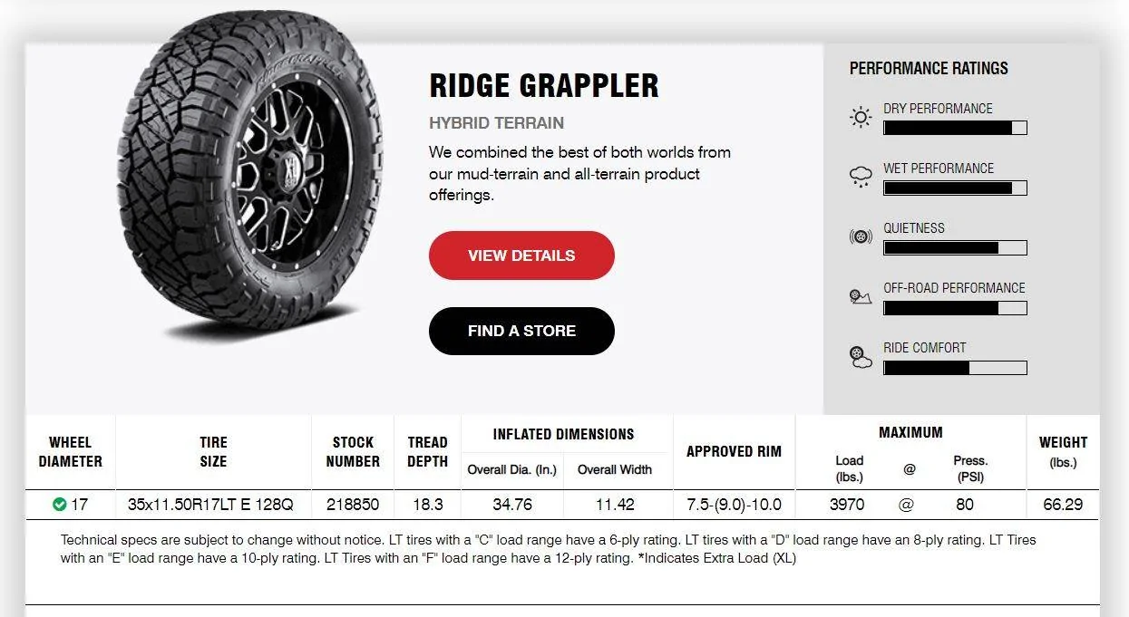

Nitto has a 35x11.5 in both their Trail Grappler and Ridge Grappler. I, too, have the same concerns as you and would like to keep the Rubicon rims when my Jeep gets delivered. These could be worth looking into...
These have an E load rating which from my understanding is better for towing and would be a pretty stout ride on road and off road...the Trail Grappler and Recon Grappler both come in the same size with a C load rating though...
Can someone answer if E load is too much for the Wrangler (if you're not towing)?
I asked this same question on Reddit the other day, most people made it seem like E didn’t matter if you just adjust tire pressure.
