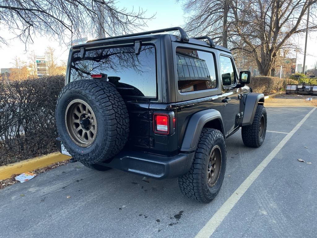

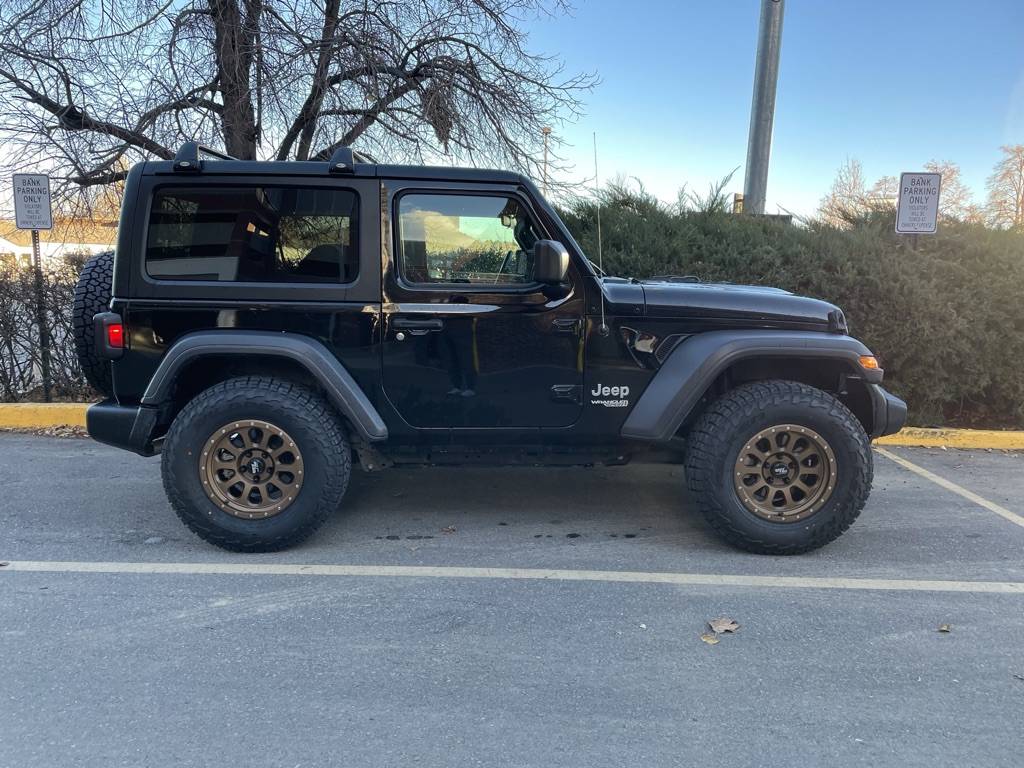

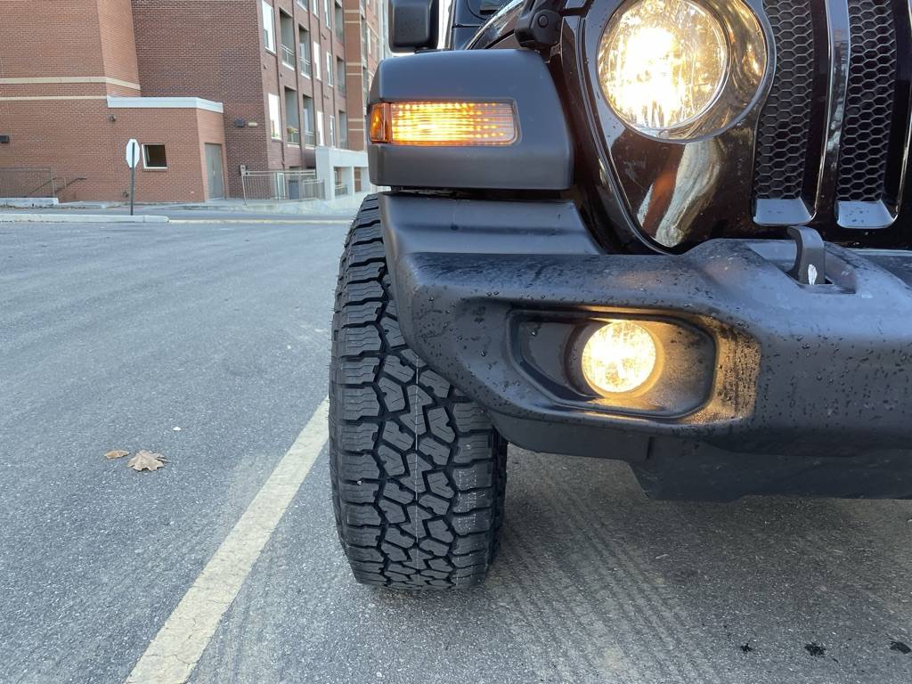

I currently have the RockTrix RT111 on a completely stock 2018 Wrangler JL 2door with no lift or leveling kit. Full specs are below for anyone looking for similar fitment. I personally went with the positive offset as I did not want the wheels to stick out too far, but there is a negative offset option that would have your wheels poke out a bit more if you prefer that look. I've been driving around with the 33in tire set up with no rubbing or concerns so far. Only note is that your stock lugs won't fit the wheel so I purchased a set of black lugs instead.
Trim: JL 2dr Sport S
Wheel: RockTrix 17x9 RT111
Offset: +12
Lift/level: Stock
Tire: Falken Wildpeak A/T 285/70R17
Lug nuts: 1.25 inch with 60 degree conical taper

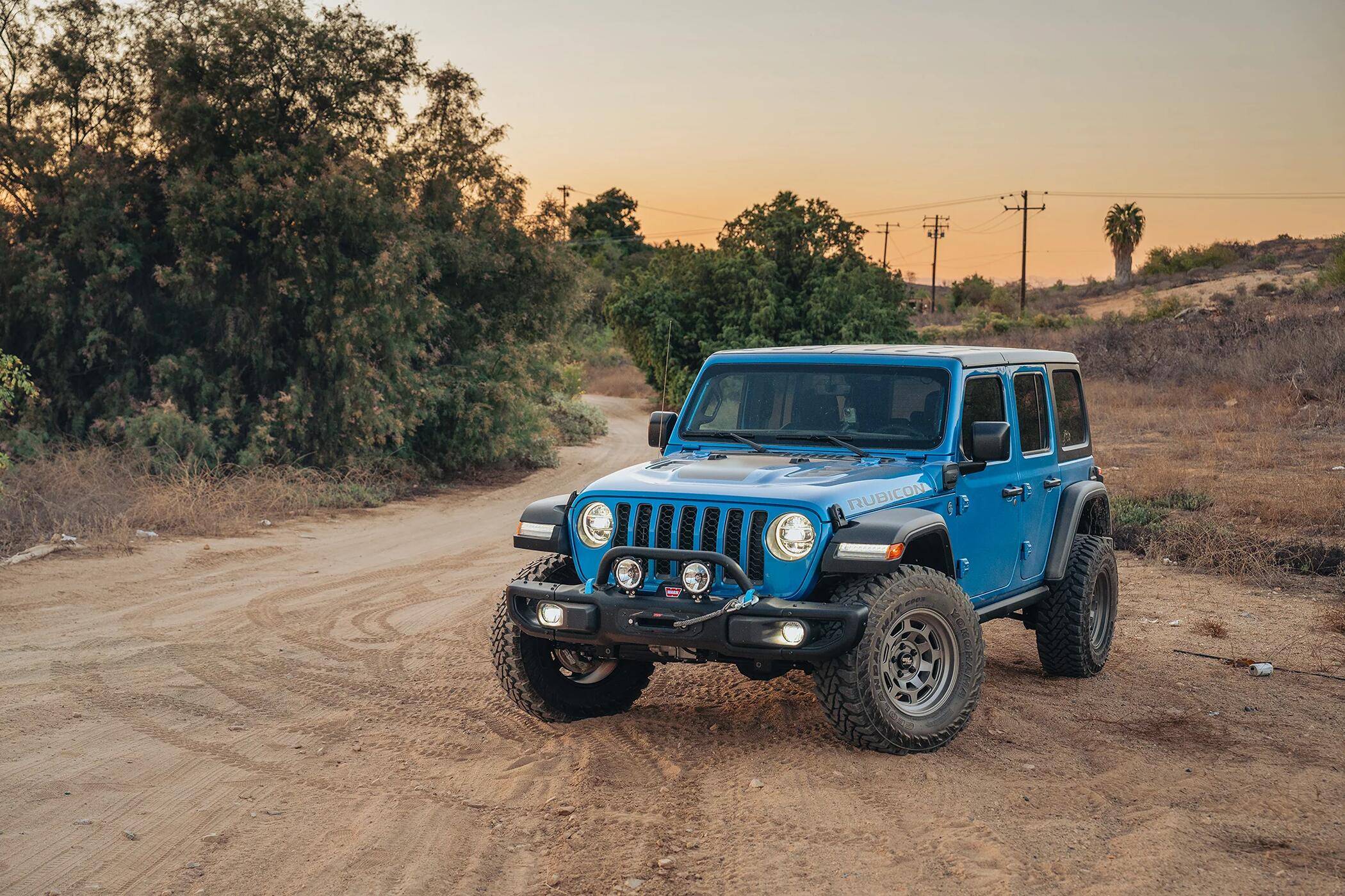

Yessir you're 100% right! Stock camera on the spare tire you won't have an issue but you will have to remove the outer cover. Most of our customers go with the -12 and this is kind of what it would look like: (The 4XE has a slightly wider track about 1"-2" so it will look less aggressive than this)
Jeep Wrangler JL Anyone have Rocktrix RT108 wheels? 1719010940035-
+12 would also work for a more conservative fit, it'll still poke a little past the fenders but not as much as the -12's would. No problem at all, it's better to ask questions and get it right the first time rather than getting it wrong and that's what we're here for! You're absolutely right though with what you said~ Yes, if you have anymore questions please feel free to ask before purchasing! We'd love to make sure that you get the right one that fits for you!

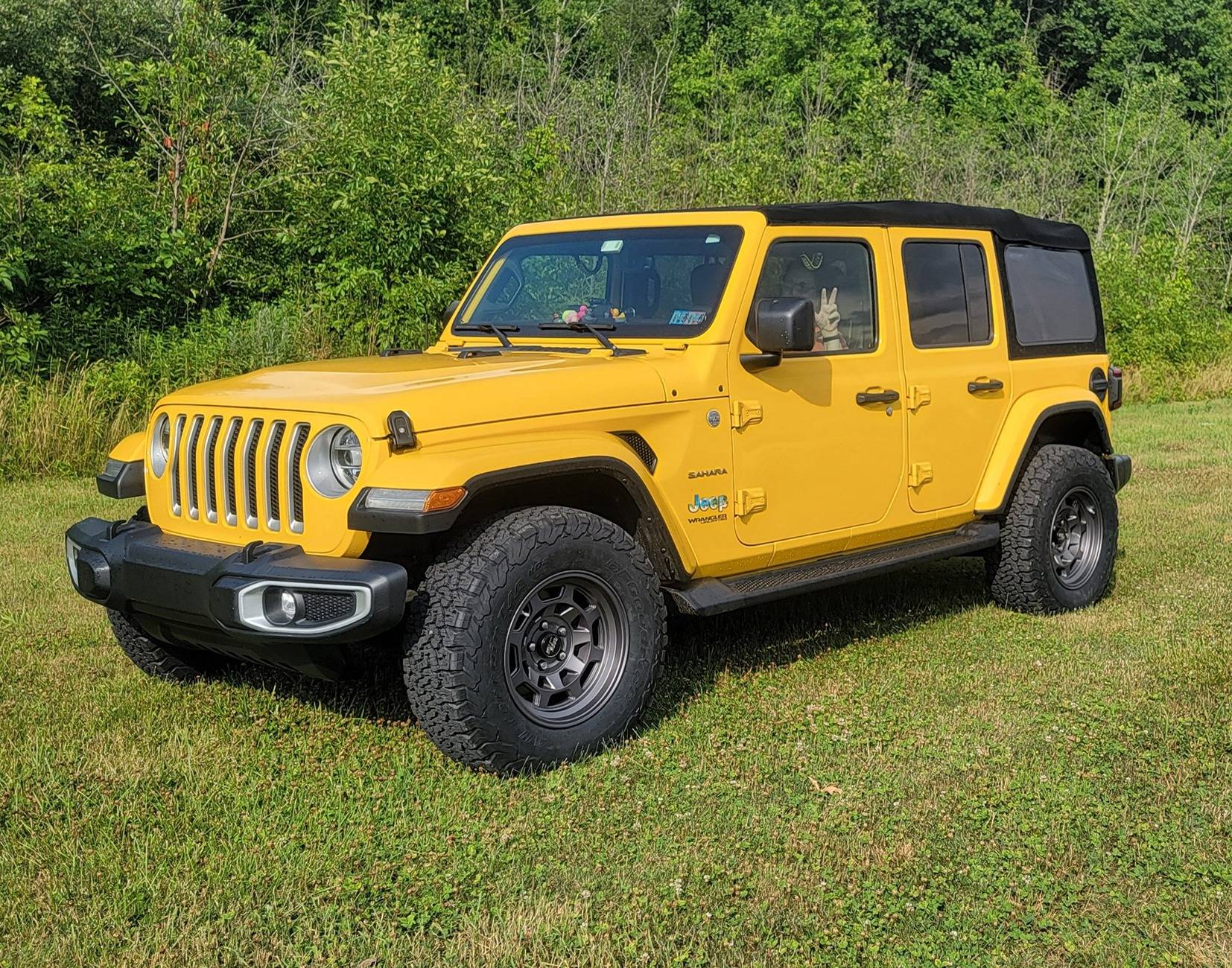

Well, got them mounted with BFG KO2's, balanced, and installed with all new sensors. And they look awesome. And like we discussed, the -12 offset only shows one tread out from under the fender. Not too aggressive, not to timid either. They are a nice looking addition.
Now for the issues during and after the install. Start with after. And this is seriously a non issue. The two bumpers for the spare tire on the tailgate. They have to have spacers and longer screws installed. Again, this is a simple fix. The other, those center caps. Man, it is almost impossible to get these things to mount without snapping a tab. Of the 5 I received, two of them had a single tab snap during installation. They finally mounted, as to how secure, I kinda hope they don't exit the Jeep while driving. One center cap is simply not useable. It snapped a pair of tabs, and simply not worth trusting. But from the looks of things, everything appears to be solid.
Thanks for answering all the questions (and fears). The RockTrix 117's absolutely look awesome.
