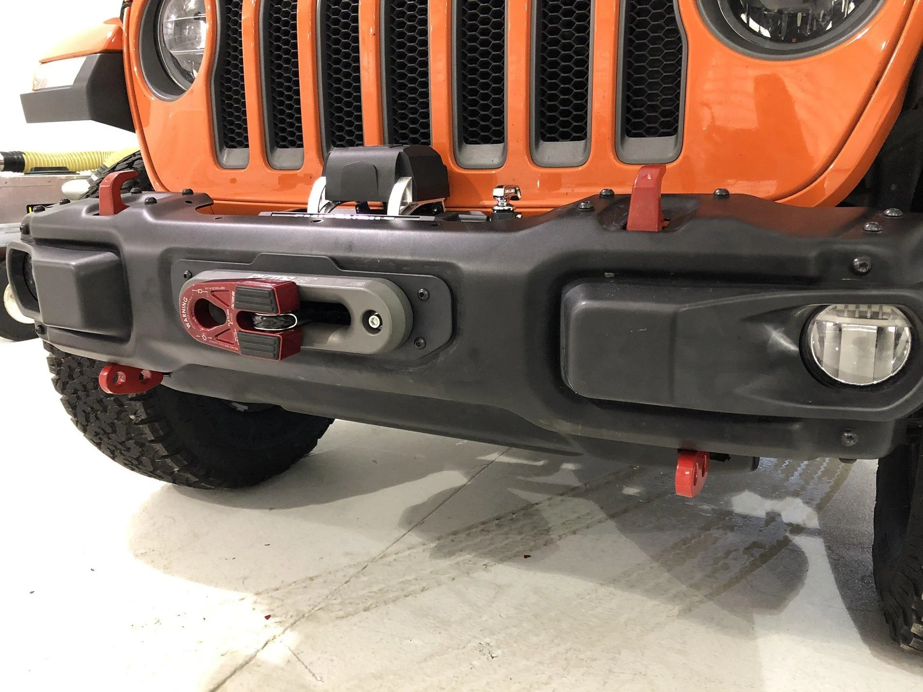

No lift as yet, but, I do have 35’s. I have towed a JK before and went with the Maximus-3 tow hooks this time on my JLUR. They were easy to install with minor trimming of stock steel bumper. I used the Mopar flat tow harness for wiring and everything works great!

I’m reusing my Blue Ox tow bar with adapter ends from Maximus-3 to fit the tow hooks. FWIW, the Maximus tow hooks are the least intrusive option on the market. I’m also reusing the safety cables from the Blue Ox kit as well. All that with the Mopar flat tow harness is the perfect setup IMHO.
PS, I don’t have any pics yet with the towbar and safety cables on, but will try and post some next week when I get home. Hope this helps.

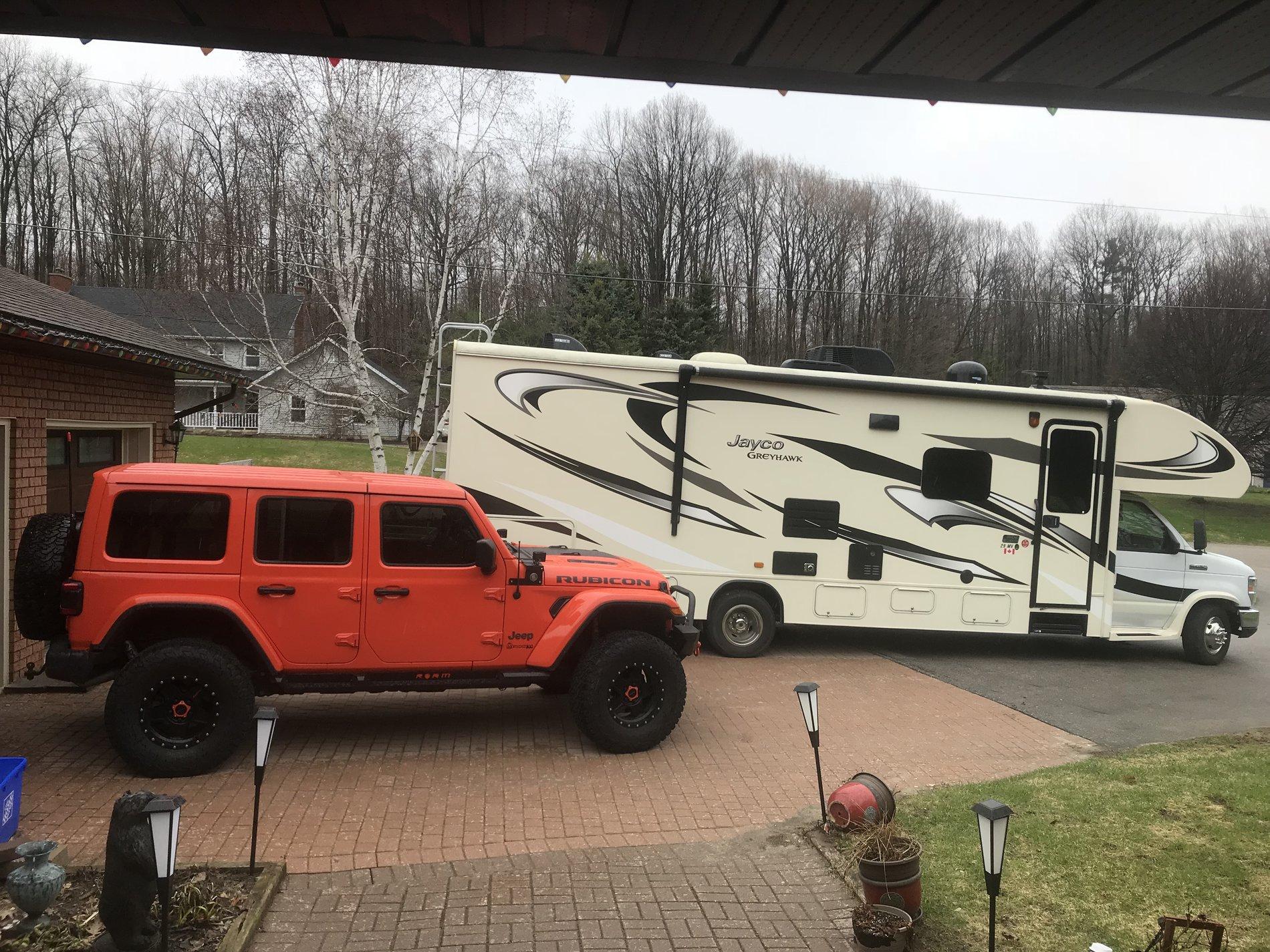

Well I am getting ready to go on my first trip in a couple of weeks. I will be towing my 18 JLU Rubicon with Mopar Lift 35 inch tires. I Have a LOD bumper set up for towing. Just got the Motorhome out of storage today.
List of my tow equipment.
Blue ox 6000lbs Tow bar
Patriot Brake System
Cool tech wire harness for lights.
Still have to install brake away safety cable
Hoping to get some nice weather this week so I can lay everything out and maybe make a couple of practice runs. Must admit I have pulled many boat and snowmobile trailers behind my pick up but I never have pulled a jeep behind a Motorhome.
