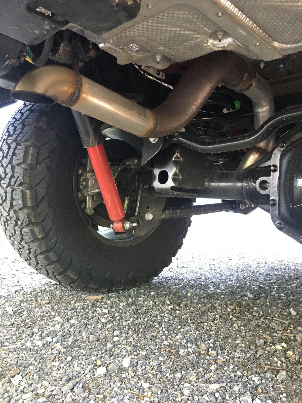

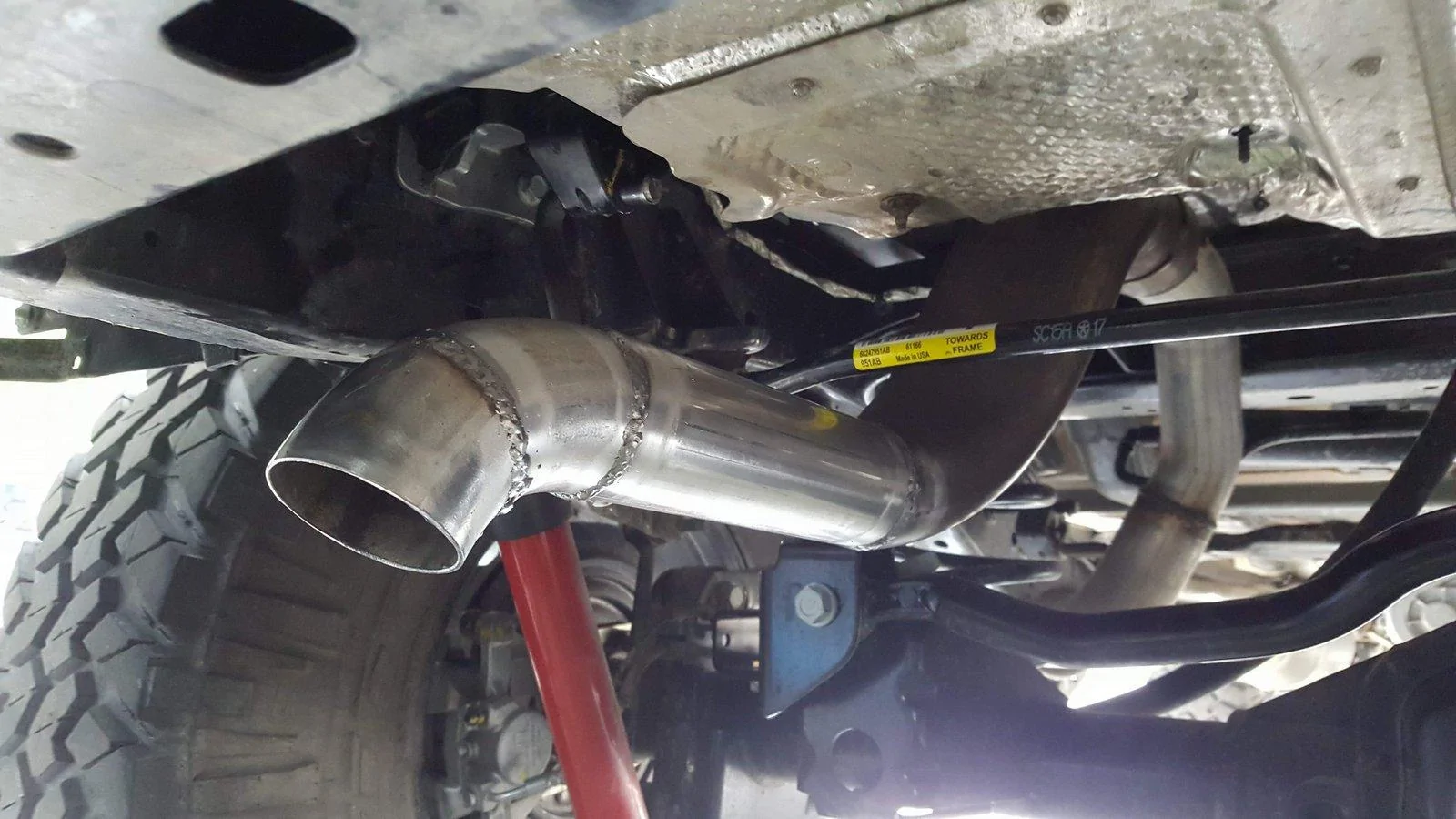

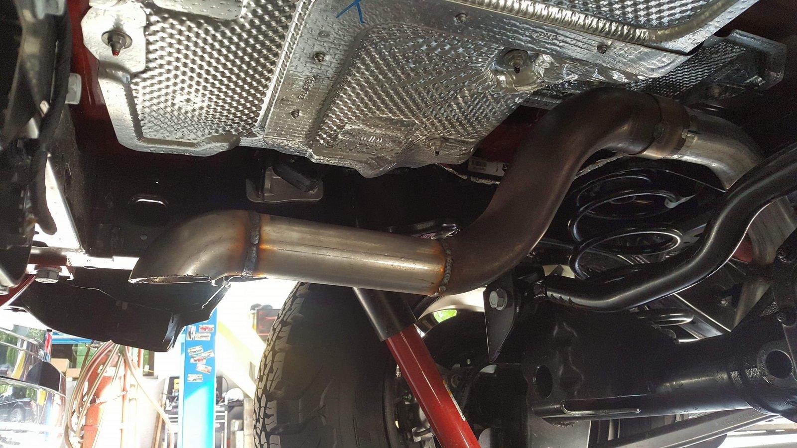

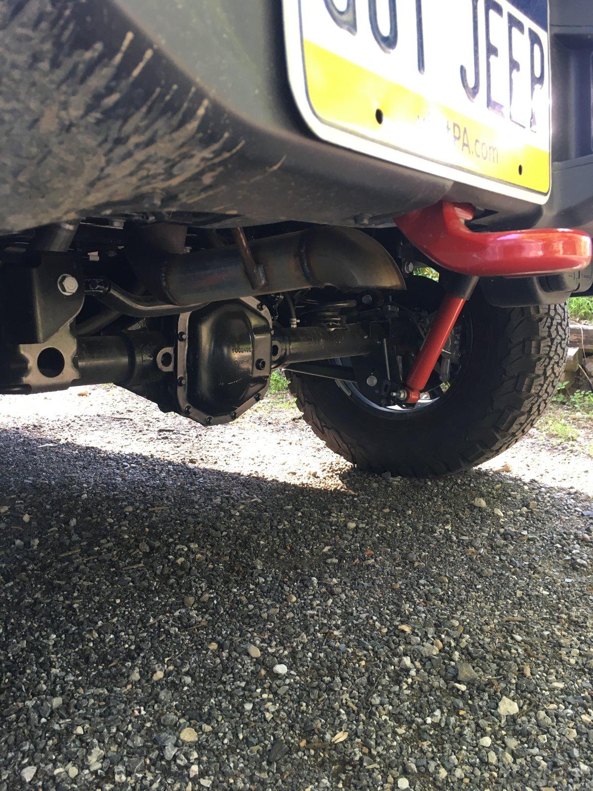

I had my local buddy bend up some tubing and make a turndown for me and another buddy we just decided to cut off the stock pipe off the muffler and use that and add tube from there it sounds good in my opinion and tucks the exhaust up high and gets it out of the way and it was super cost effective

Perfect! I'm thinking I may do the same. Worried it still may be a tad loud w/o a muffler or resonator back there. I could give it a try and always squeeze one in if it is too loud. How about drone?
BILT_JL
May 16, 2018
Pennsylvania
Drone really isn't bad, hardly noticeable I have an 8 speed so it might be a little different than yours but for the last 3 weeks I have had the top and doors off and you really do not notice it then. I honestly was surprised it wasn't louder when I first did it because I was originally planning on adding a muffler up under the driver seat if it was but I like it how it is. When you get on it its definitely noticeable but normal daily driving it isn't annoying in my opinion and like I said before the price was right.
