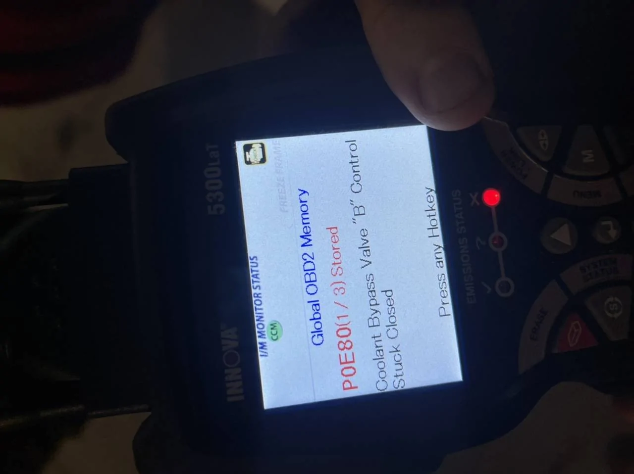

Any insight on a CEL code?
Mgg253
Michael
Apr 14, 2021
435
778
2021 JLUR 4xe
21 JLUR 4xe 11k miles
P0E80
auto store and google are coming up short. It’s min of 2-3 days just to get diagnosed at the dealer then parts and time to fix. If it’s something super easy I’d rather just do it myself than wait. Anyone had this or know the remedy??

So this is a common issue with the JLU 4xe. There is a few things you can check before it hits the dealer and keep in mind they will want to change the valve but it might not solve the problem.
Check circuit at connector XY230A #30 PIN to bypass valve #261, if ok then possible PIM module failure or Inverter problem. Most likely it will be the inverter however the Gen 2 inverter solves the issue. I would demand them to change it with the valve if the valve is changed or you will be back in a few days!
Hope that helped

Exactly my fear, the valve only half the problem. Thanks a bunch

It's a long shot but you can also check the routing of the valve. It's a 3 way valve for the batteries. We saw 2 so far piped in wrong from the factory believe it or not lol. Swapped the 2 outlet hoses (one was in one was out) and solved.
