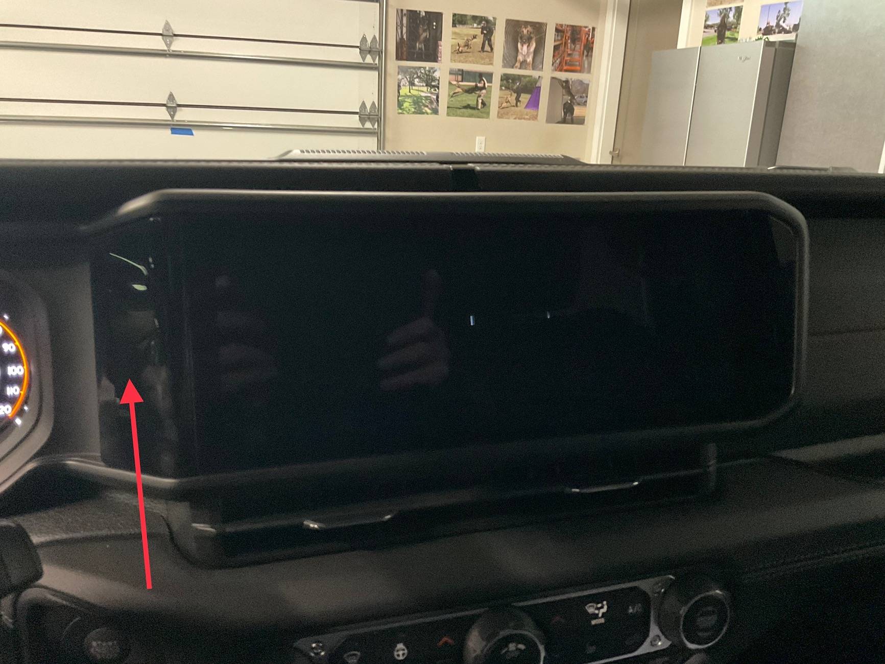

On a semi related topic, my 2021 Raptor has two interior cameras. They said it is to detect inattentive drivers. A buddy with the DEA told me, with a court order, they can conduct live surveillance…..sound and video, via the cameras. The owners manual indicates the cameras record to the EDR on a 30 second loop. My friend told me the cameras can be remotely operated. Naturally, I looked at the UConnect screen inside my new 2024 X and like my Raptor, it has a black plastic, for the lack of a better word, window, attached to the left side of the main screen. I am totally anti big brother and had my Raptor torn apart. Black Duct tape now blocks the camera on both the GPS screen and door. Wrangler doesn’t have it on the door. Does anyone know what is behind the black window next to the GPS? If the DEA can do it, so can a 12 year old with a computer.
