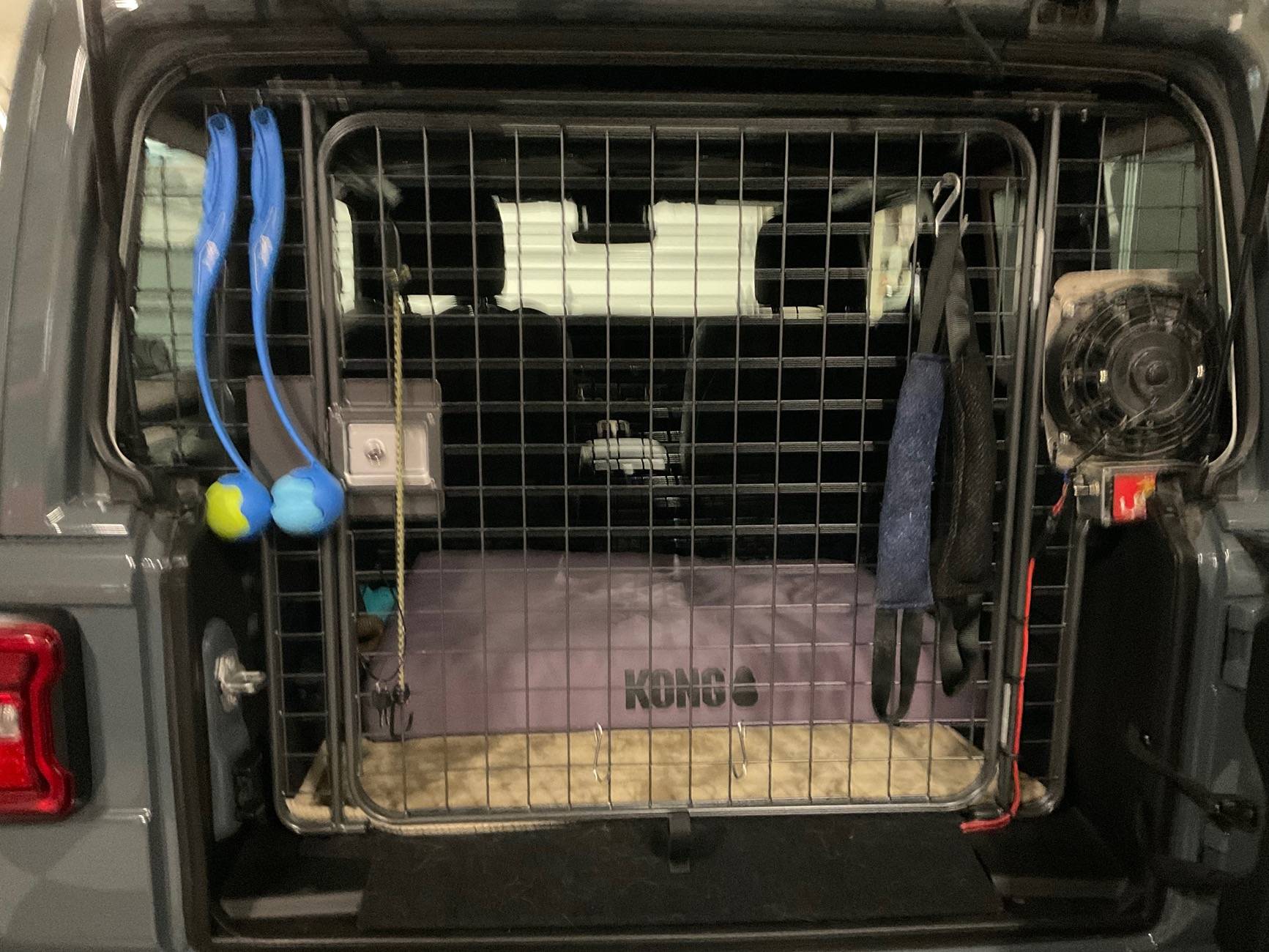

Truth be told, I can replace the Jeep, I just don’t want the thing stolen with my dog in the back. The dog can take care of business, but I have him caged front and rear.

Uncage the front, problem solved.
