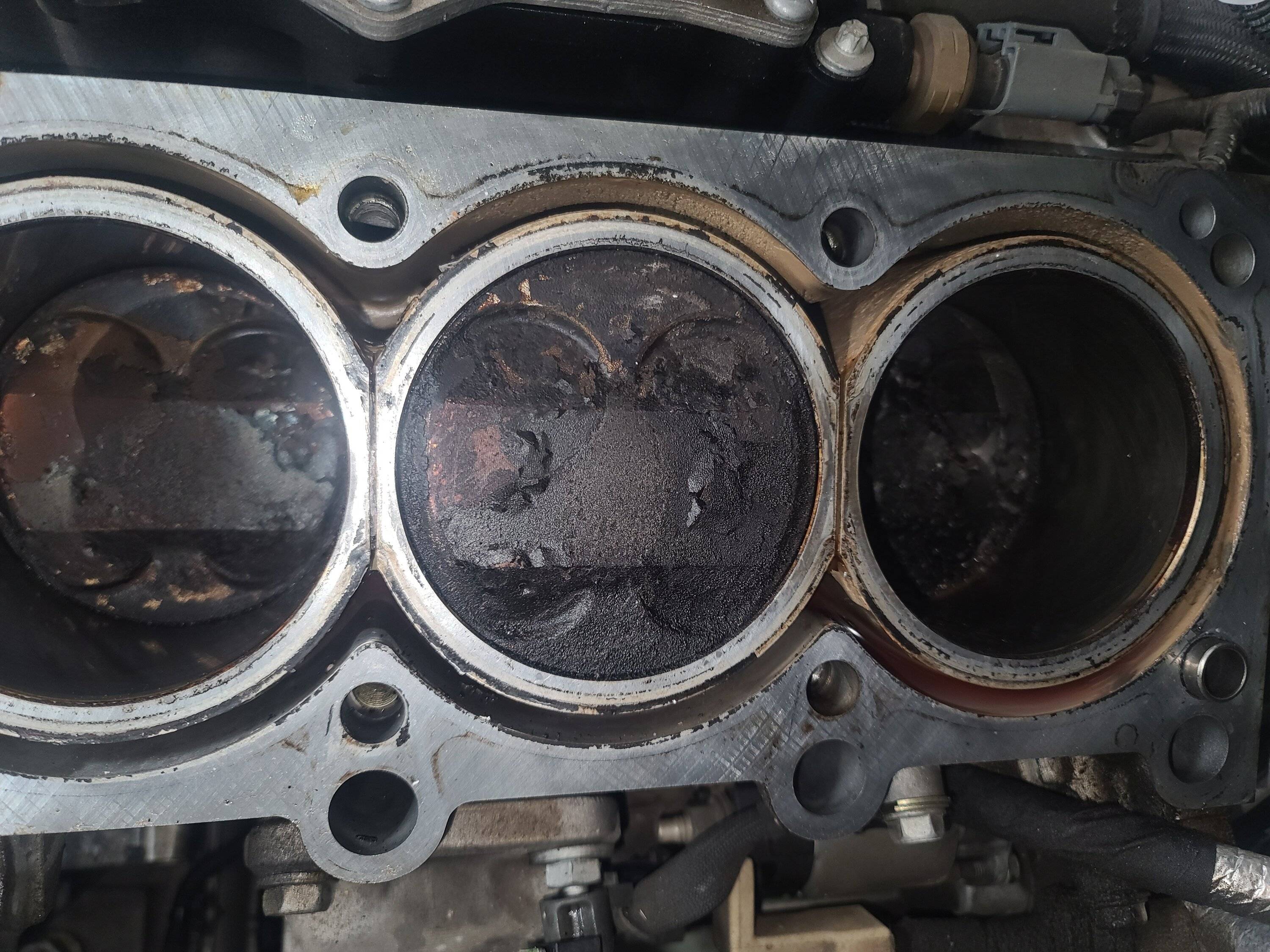

dstrahm
Doug
May 12, 2021
110
67
USA
This is what they found when they performed the TSB repair. So far so good but it hasn’t been in the trails yet.

UncleJimmy
James
Mar 22, 2019
691
671
AZ
2020 JLUR; 2016 Toyota Tundra
That is awful. What was the mileage and how long did you have knocking before the service? How is it running now?
I had LSPI develop on mine at 40k and did some Seafoam treatments with WOT (crankcase, induction, fuel), followed up with Techron and catch can and haven’t had any more knocking.
