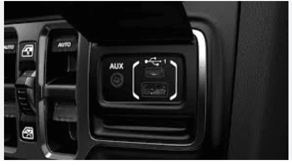

hI so this cable is for the USB connection below the radio aka MEDIA PORT?
Fix is for center console USB port. DO read the pdf above over very carefully.
And this fix indeed works. I have a friend that is a Tech and last month (Feb) he told me he had done the cable replacement twice with positive results both times.
He told me that even though the two JL's he did the work on were out of warranty, that the dealership General Manager said do the fix, regardless... and the dealership would eat the cost.
Apparently, both vehicle owner's had purchased many vehicles at the dealership over the years.

Here ya'll go. It took them half a decade to release an actual fix for this. Kinda crazy in my honest opinion
Part number 68658437AA
My center console port hasn’t worked since day one, and I can’t believe there’s finally a fix. I hate using the front dash ports and adding clutter to the area.
My passengers always manage to tangle the cables up or let them hang in the footwell and step all over them. Drives me nuts!
