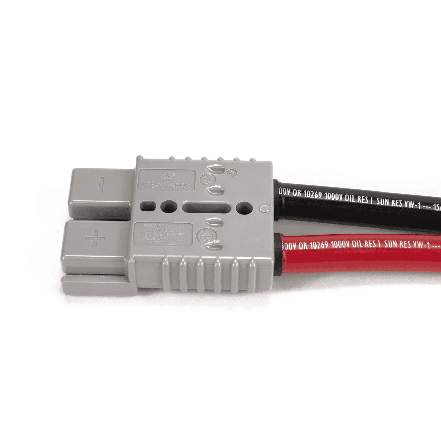

No...not a 4 pin trailer harness, a 2 pin Anderson Connector. It looks like this:

I want to mount an Anderson Plug at or near the hitch receiver, which is at the front of my jeep. It is thicker than a 4 pin which is why the linked hardware in my original post of this thread probably won't work.

Probably will require some fabrication but is this similar to what you’re envisioning? Scroll about halfway down this page.
https://powerwerx.com/anderson-power-powerpole-sb-connectors#?specs=315
Saw that Terry in my searching and like, thanks. Definite candidate. :)

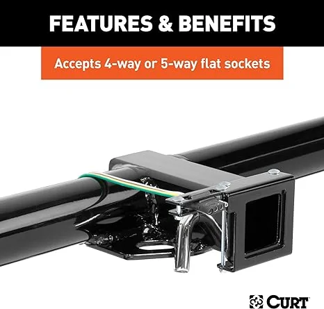

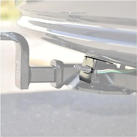

Thinking of using this https://www.amazon.com/CURT-58000-E..._1_1?keywords=Curt+5800&qid=1703647794&sr=8-1 to mount the item in your link. I already have my linked part on the rear hitch for something else; works great.

Small piece of 1/8 plate. Bolt Anderson plug to it. Weld to hitch or bolt to hitch.

Seems easy enough, I would do something like what GtX suggested. A small plate or angled steel to weld on or you could use aluminum if you're going to drill & tap/bolt it on.
