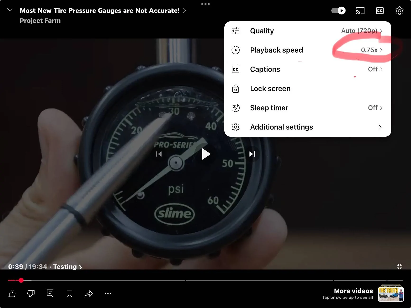

It's not often that someone does a comparison of something like tire gauges, but this guy tested a slew of them. The one I put inline with my Kraken / dual ARB is about 1.5 PSI high when airing up, so based on this guy's testing I went with the Jaco 100 PSI digital in hopes that it'll be a bit more accurate and precise. https://a.co/d/5YbTjFG
Yeah, his voice and style can quickly grate on your nerves, but there's some good details in there.
