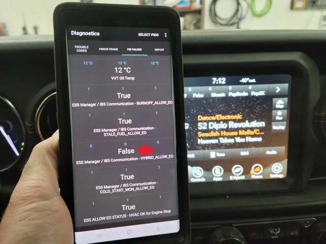

My test was to artificially cool down the ambient temperature sensor and observe the PIDs to see which one would change and make the vehicle use the ICE engine. I would then heat up the temperature sensor and watch the PID change again allowing Electric only mode.
I was able to cool the sensor down to -40c I wasn’t really trying to get it that cold but using compressed air it wasn’t the most scientific method. As soon as the temperature updated the following PID changed to FALSE
ESS Manager / IBS Communication HYBRID_ALLOW_EO went from “TRUE” to “FALSE”
True = Electric only operation
False = ICE Operation
This PID is part of the Hybrid Control Processor in the vehicle

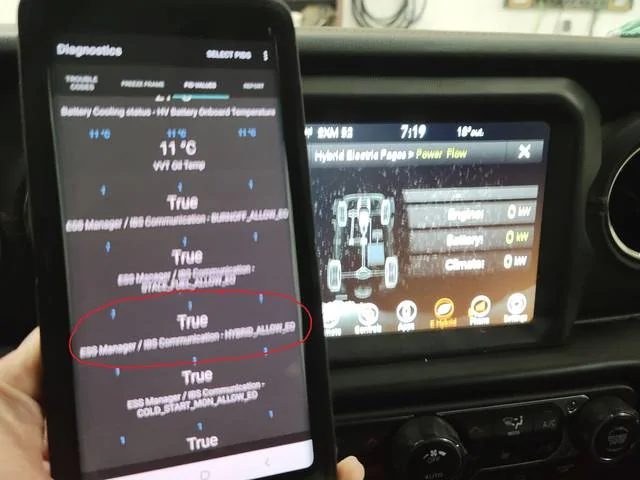

I then took a heat gun and warmed up the temperature sensor. The first temperature to update was 18c once that updated the Hybrid Control PID went back to true. (sorry for the blurry photo)
Upon the ICE starting up the message “Electric Mode temporarily unavailable” Message popped up. When the Hybrid operating PID went to true the ICE turned off.
