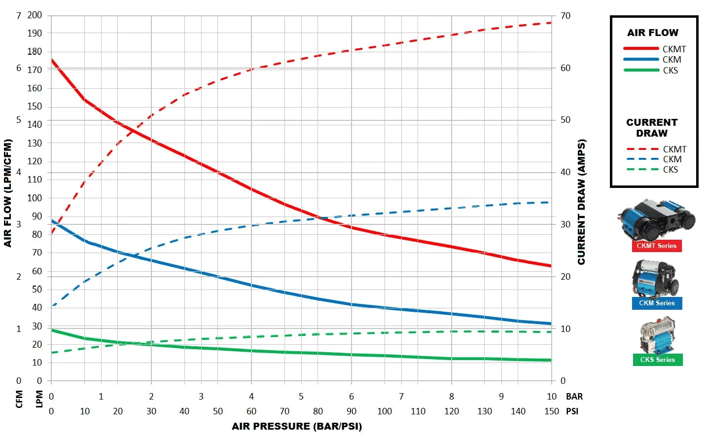

Since we are getting a little techie, here's the ARB flow chart. I believe at some point, a single Schrader may become the limiting factor.
Moreflate recommends only using their 4 tire hose kit with their twin 10-6 compressor. I believe it's for exactly the reason you mentioned; the schrader valves limit the flow volume, so with the excess volume, you can fill more tires. Also, filling tires one at a time causes more line/manifold pressure and reduces the duty time before overheating.
