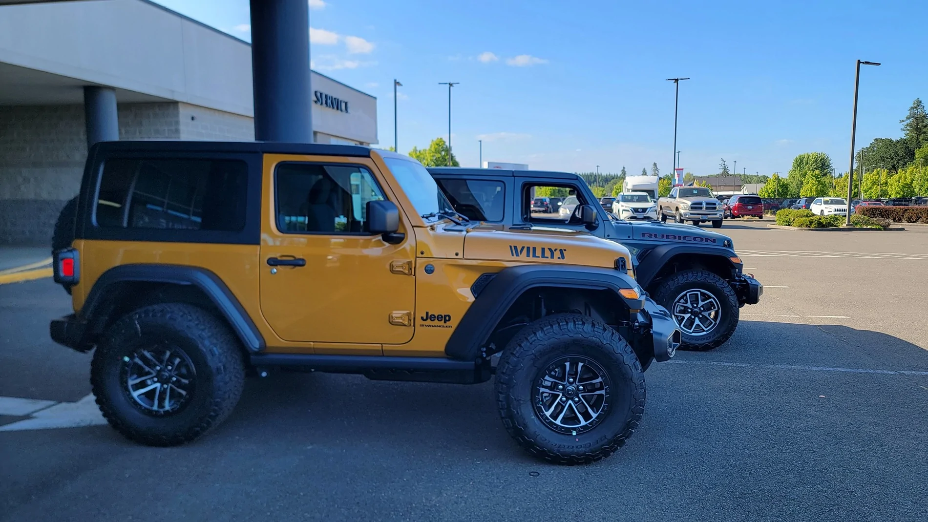

Looking at the AEV RX Gen 2 or my Warn Zeon XD 10S to live on my 26 Willys. It's spendy but I love the OE Plus look, the no drill install and the lighter weight. Who has personal experience with these ? Especially the gen 2. Thanks 👍
