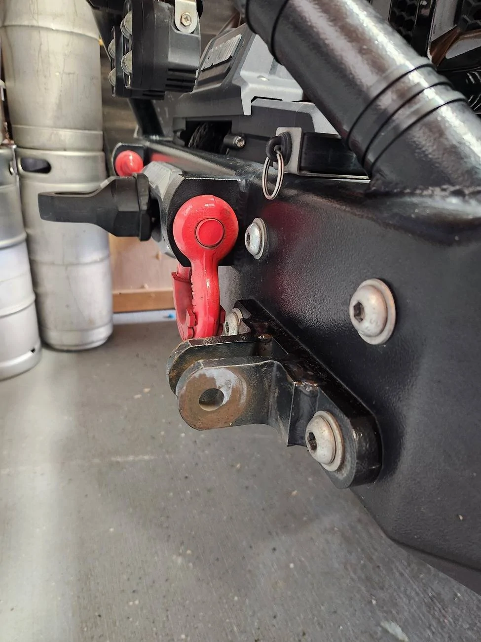

Hello all!
I want to buy a 2023 Rubicon 392 and have AEV do a buildout with the ex bumper. I’m a full time rv’er, so need to flat tow. I know there are adapters for the tow bar, but where can you connect the safety cables? AEV does not have a solution, but they have their hands full and aren’t giving it much thought. Thoughts on solutions?
Thank you!

I have a Rockhard 4x4 bumper that is made for towing. I have the Blue Ox adapters. Safety cables attach to D rings.
Jeep Wrangler JL Flat tow safety cable placement on AEV Bumper 20240906_152054
