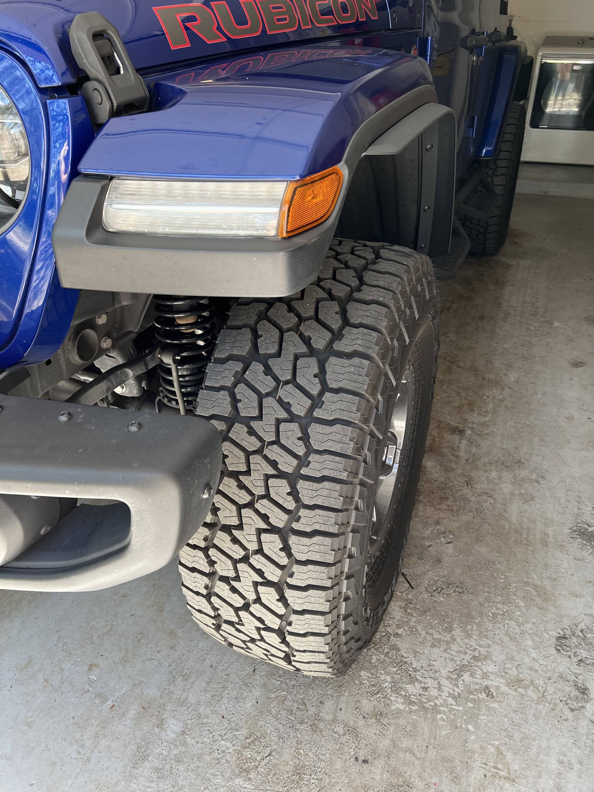

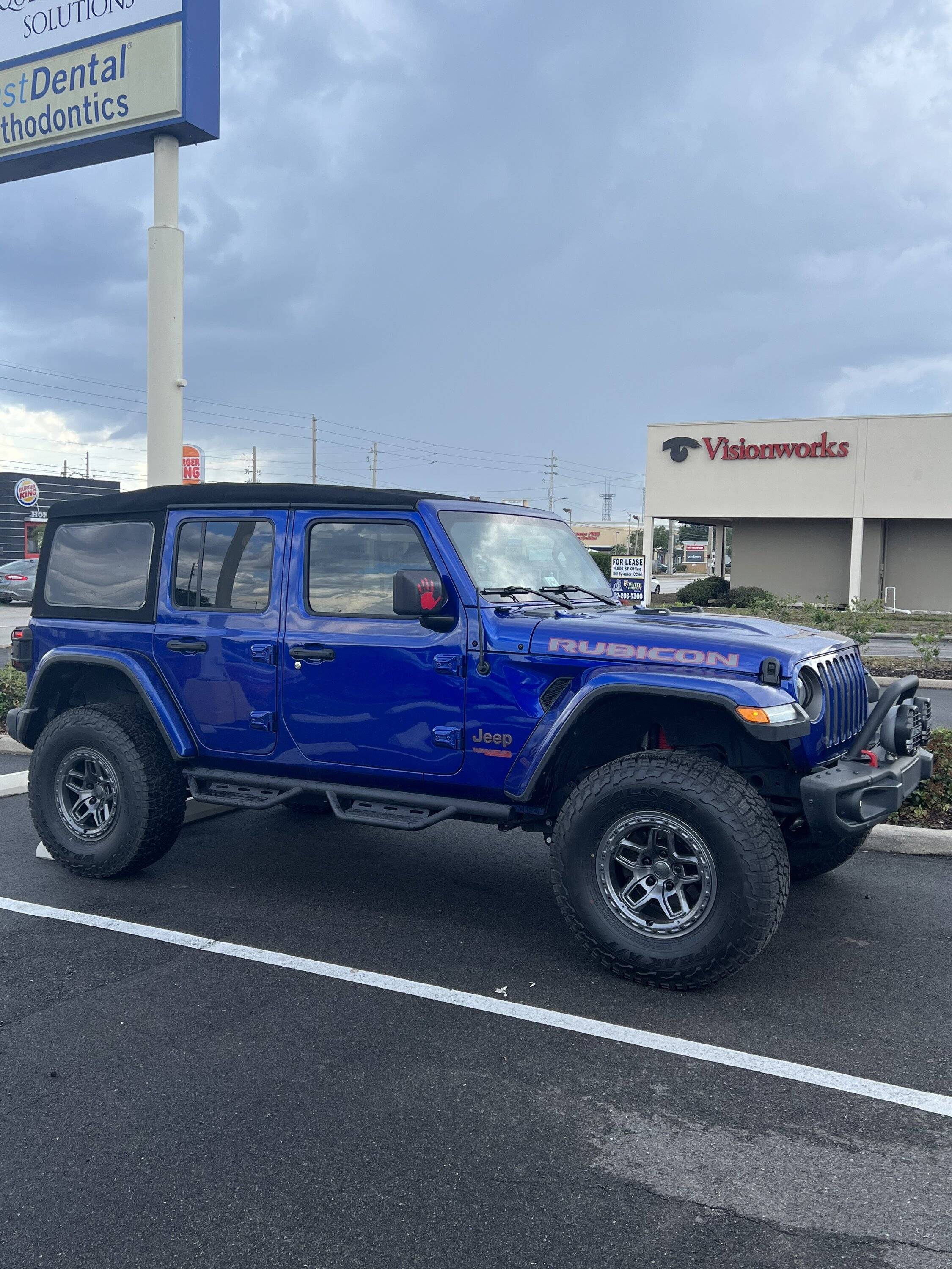

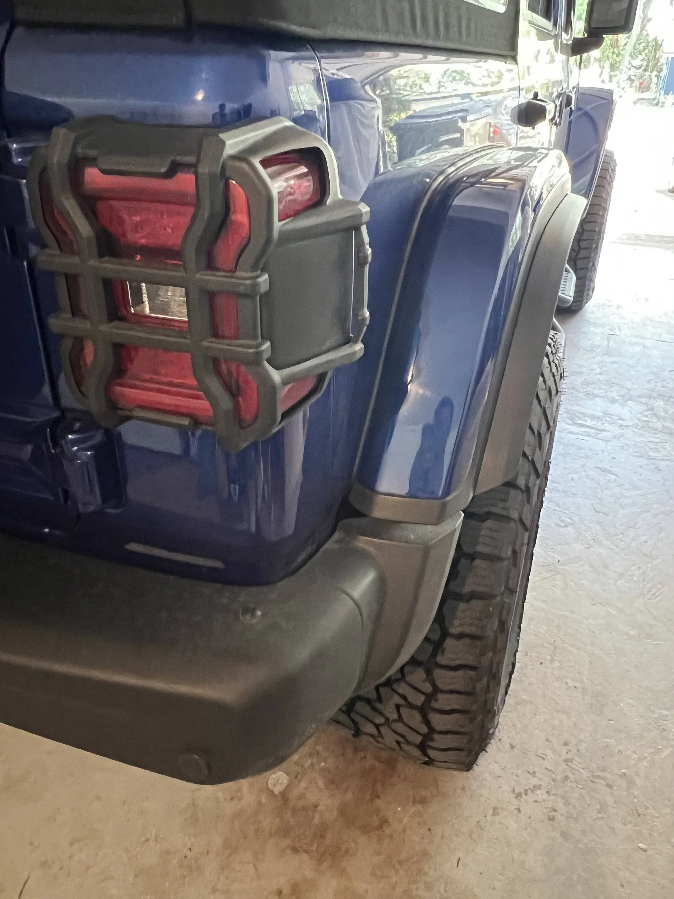

If you are planning to eventually go Clayton, I’d recommend going JK like I did for the Borah wheels. They have close to the recommended 4.5” backspacing to keep rubbing from happening. I am running 315/70R17s (35x12.5 equivalents) Wildpeak AT/3s

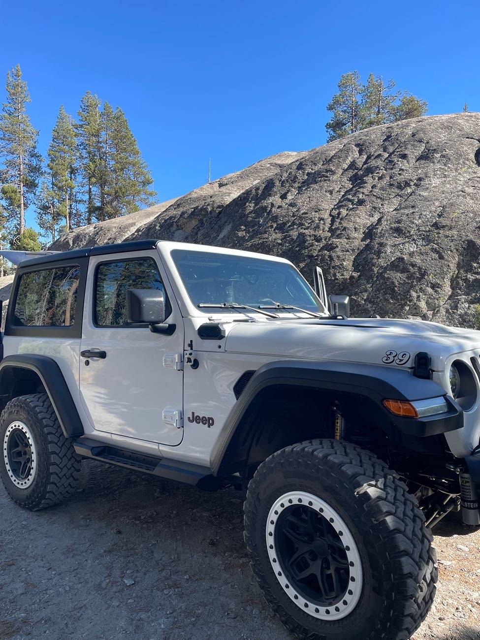

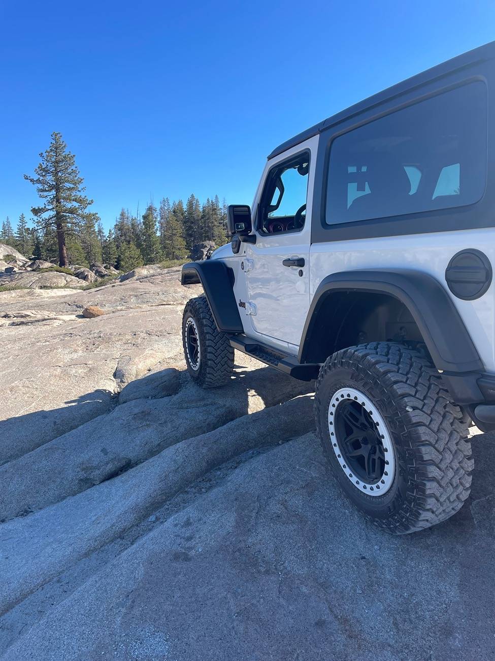

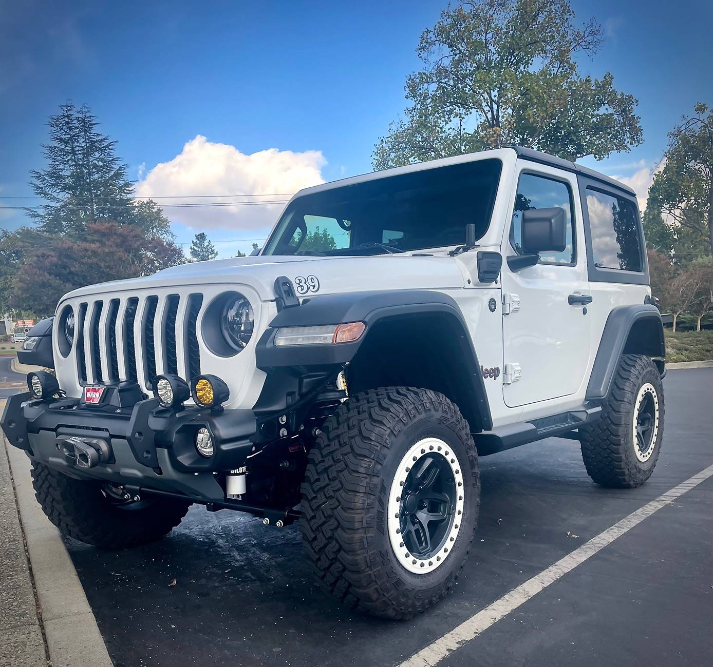

Im running the Clayton 1.5 overland kit along with The AEV reservoir shocks and Borah wheels on my 23 Rubicon. What a fantastic combo. Excellent ride on and off road. The Clayton lift took my 2 door Jeep 2.5 inches up with my heavy bumpers. 35 inch tires will not rub cause the Clayton lower control arms are made with a built in radius.
