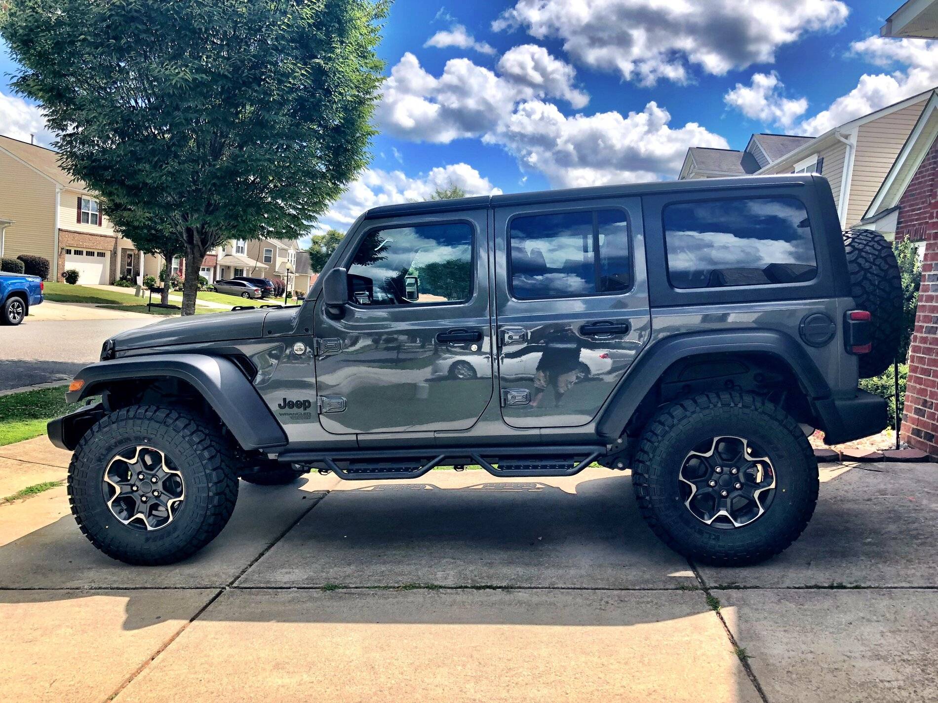

I just did the AEV 2” spacer lift with Rubicon shocks/springs and the Mopar extended LCA’s on my Sport S. I put 35” Kendas on my stock wheels. Steering is spot on. It drives better than stock.
I didn’t end up using the ProSnap. I opted for the JScan, and have been very pleased with it. But if all you want to do is set tire size, the AEV module will do the trick. Install is a little more involved.
