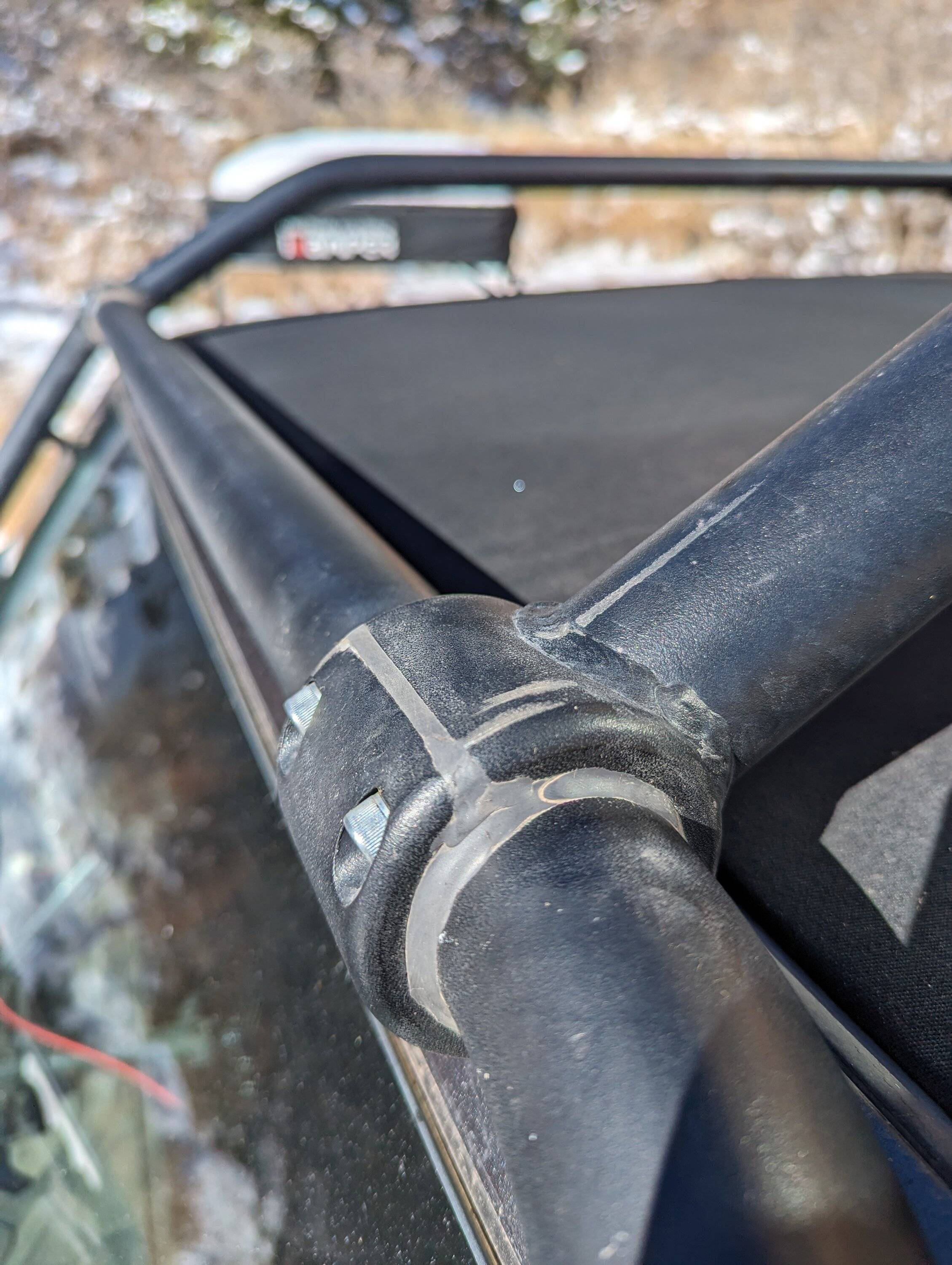

Thank you Ratbert! If possible, can you post up some pics what you did with the Sugru? I'm sure others might have a similar interest. Thanks man!
It doesn't look quite as good as it did last year, but it's still very functional:
Jeep Wrangler JL Adventure Rack Systems Rack Review 1000008901
