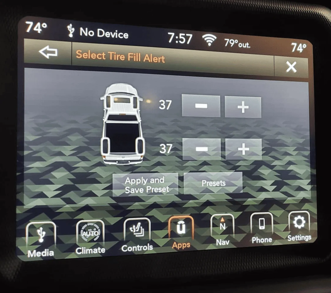

I saw this on a Gladiator Forum. Apparently, you can adjust the tire pressure direct from the screen if you have the upgraded 8.4" screen. I checked on my JLUR and I do not see the option. I have a 2020.
Anyone have this on theirs?

Yep. Thats a gladiator only feature but, I believe, will be on certain 2021 JLs (along with a front camera option - again only currently available in the gladiator).

It’s a tire fill alert system. It honks the horn when you reach a specified pressure when airing up.
Wife's Honda Pilot has it. Seems like every TPMS car should do it, shame they don't.

If it’s just software, how is that not updatable on the prior year models??? The same with the off-road+ feature. How can that not be updated in the computer?

TPMS would also have to be changed. Not just software in the Jeep. TFA option takes a different TPMS.

Like just the sensor in the wheel? That’s easy, right?
