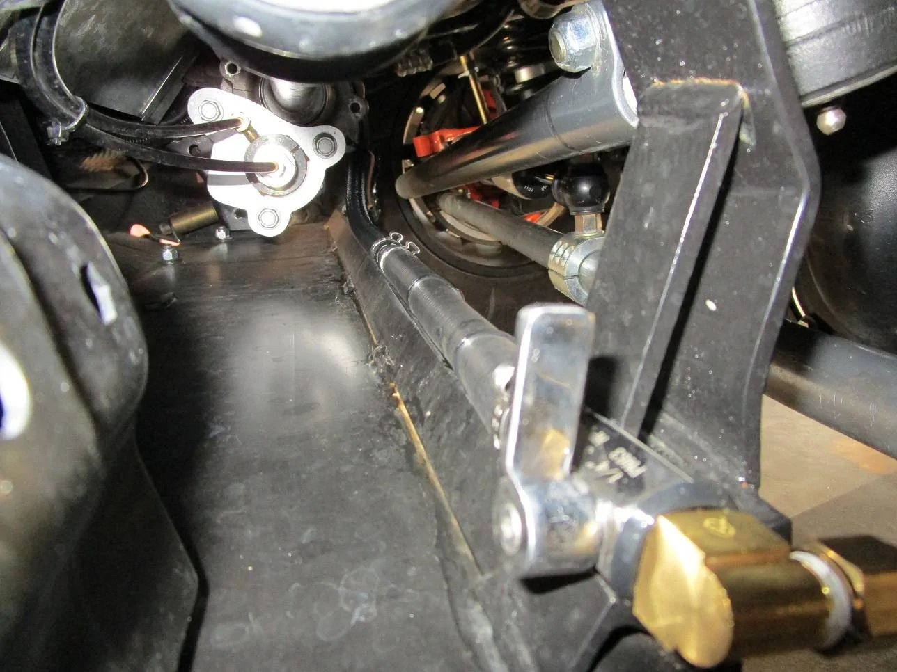

I did the same on my 2020 Willys put added a pneumatic cylinder to connect and disconnect Using my onboard air compressor with a regulator to lower the pressure to the cylinder.
One of the issues with the factory setup is that some times they do not reconnect so I added a larger spring. I made all the part to retro fit.
It has always work perfectly.
