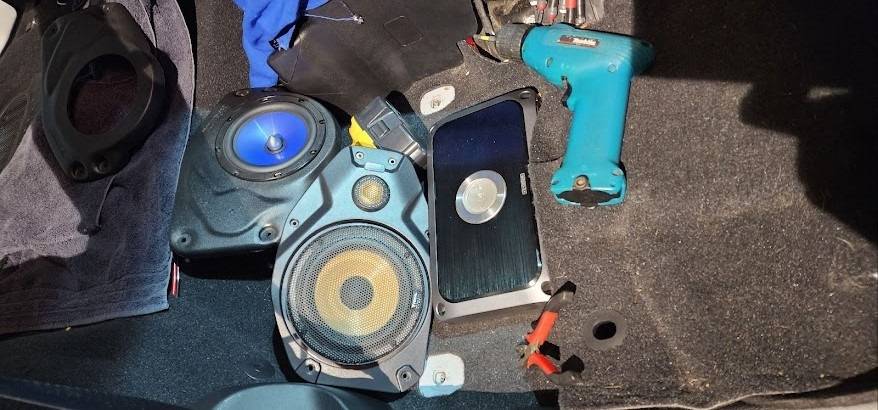

For anyone that has replaced the lower knee panel speakers.
Is it a noticeable improvement over factory? I don’t mind putting in the work if it makes a big difference. I’m already replacing the top dash with focal and upgrading the sound bar with with 3 way focal components. I will be adding an amp and pac. If I only replace the upper speakers I will power them off the factory amp. If I end up doing the lower speakers as well then I will need to add an additional amp. Also looks like to me the lower speakers would be restricted by the factory grill if I go larger. Thoughts?
Rscx4
Jul 19, 2021
178
339
Tampa, FL
21 JLUR 392
Yes, much better. I replaced all except sub.

Not as bad a task as it looks but still a lot of work.

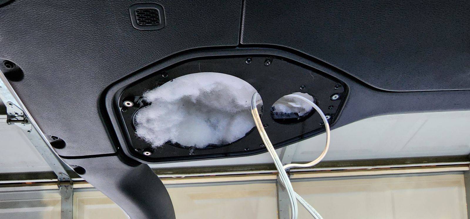

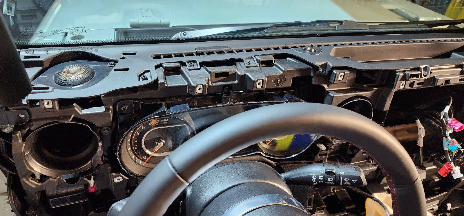

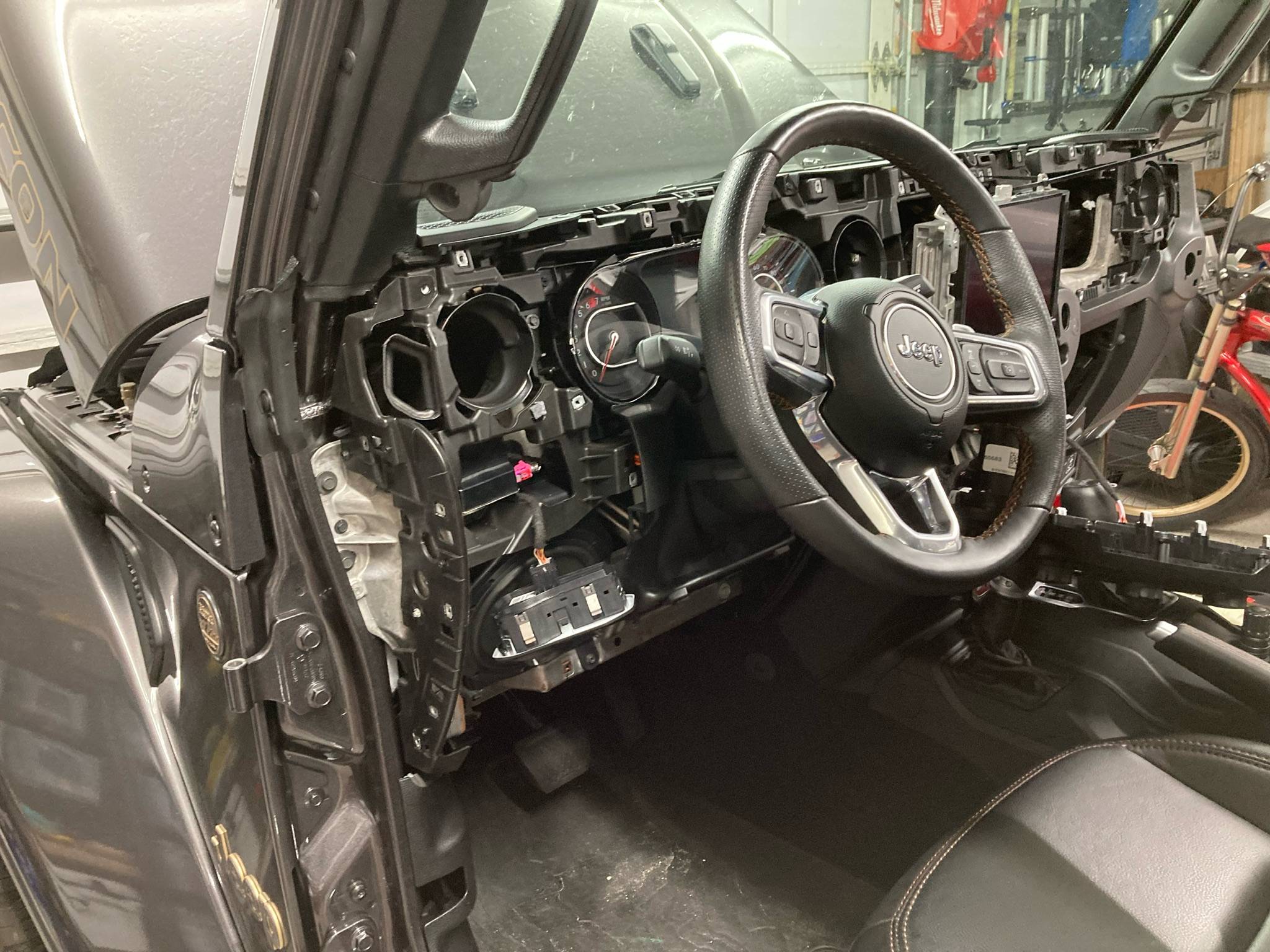

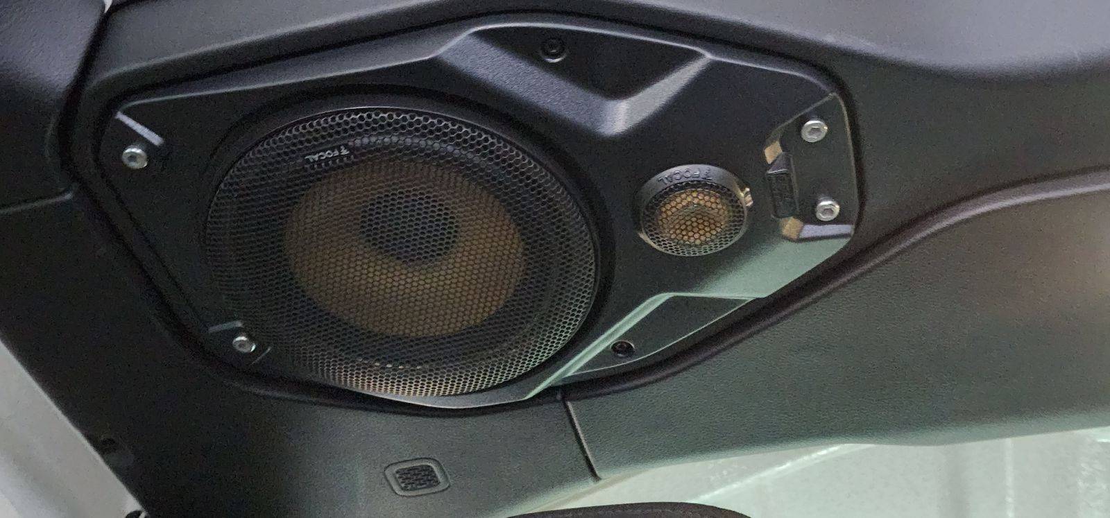

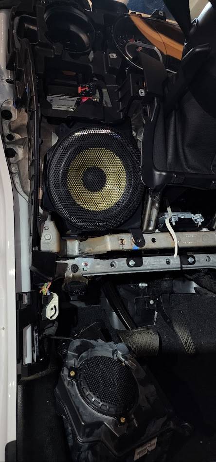

Yes, it makes a difference.... but the difference is relative. My Alpine system was adequate with the top on and doors on but once ya lost the freedom panels or dropped the top I wasn't satisfied until I switched to aftermarket speakers and amps.
Jeep Wrangler JL Adding an Aftermarket Amp(s) 1674363033085
Jeep Wrangler JL Adding an Aftermarket Amp(s) 1674363123255
I went with Focal component speakers all around but if you wanna try running any focal speakers w/ the factory amp it's just a waste of money on the speakers. You will actually get less volume out of the focals. They need solid, clean power to push them to efficency and factory amp won't cut it. Nor will a 3000 watt pyramid amp that weighs 6 oz. Factory speakers are designed to be more efficient with factory amp but have a quick cliff of sound degradation.
