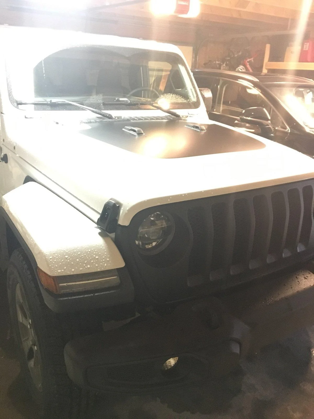

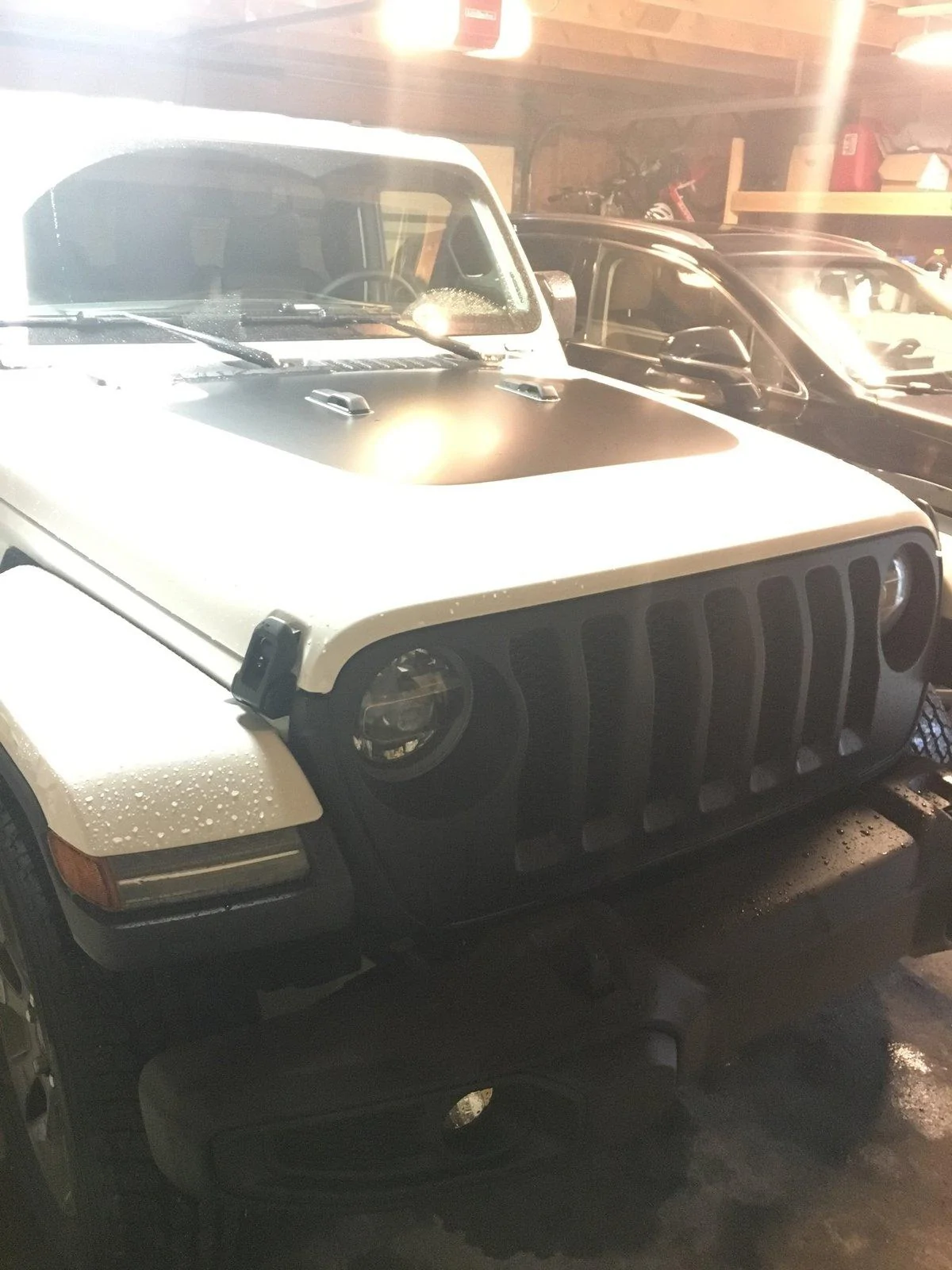

I have an all white Sahara and I just bought the primed black grille. You can still use the mesh backing that comes with the JL. It snaps in to place on the back of the primed grille. You can’t use the inserts that come with the Sahara/Rubicon grilles, however. And you wouldn’t need molding for the primed version. If you have a sport and want the satin grille, then you would also need to buy molding.
I painted my primed grille with matte black automotive spray paint. Could have kept it just the primed black, but I didn’t like the shine that it had and preferred a matte look.

Wow that's exactly the look I am going for (including the decal). Yeah I'm leaning towards buying just the primed black grille and using the existing mesh that is in my white grill.
Also buy molding do you mean the trim around the grille? In your pic it looks like the trim is black around the grille.
Right now the trim on my car is white, when I order part 68316767AC, does anyone know if it comes with the black trim/molding?
Also how hard was it to put that decal on yourself?

The primed grille is all one piece (molding built in) just like a Sport Grille. That’s why if you have a Sport and want to purchase the Satin Grille, you also need to buy molding, as the stock sport grille does not come with molding. If you were to buy a Satin Grille for a Sahara or a Rubicon, you would just need to detach and use your white molding that comes with the stock grille.
The decal was very easy to put on. Always follow the instructions and wet-mount/ float it on, then use the provided tool to squeeze out the water once it’s in the place you want it. I got mine from Quadratec and it came with everything.
