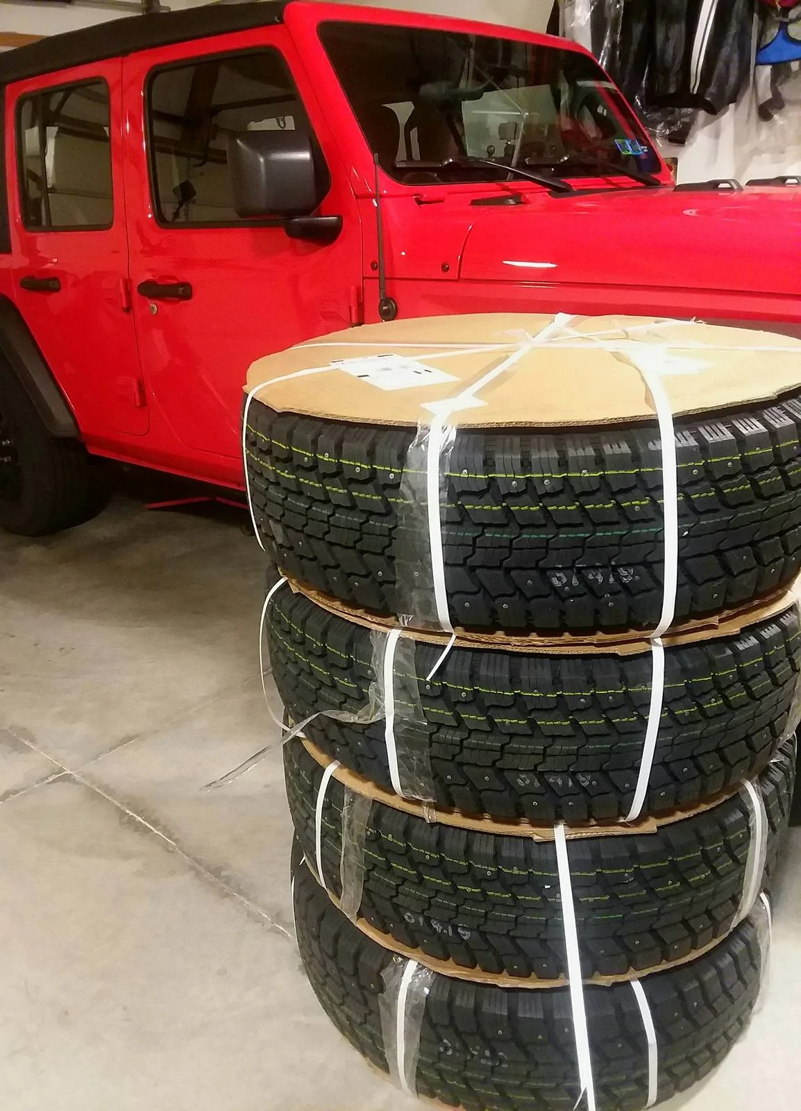

For those instances when the forecast calls for prolonged snowfall and the temperature trends that will keep it on the ground for a while, I have a set of proper studded snow tires on standby. From experience, I'd prefer not to depend on a tire that claims it can do everything, but rarely does so.
I prioritize peace of mind, but it's understood that each owner makes the choice that he believes best for him. ?
