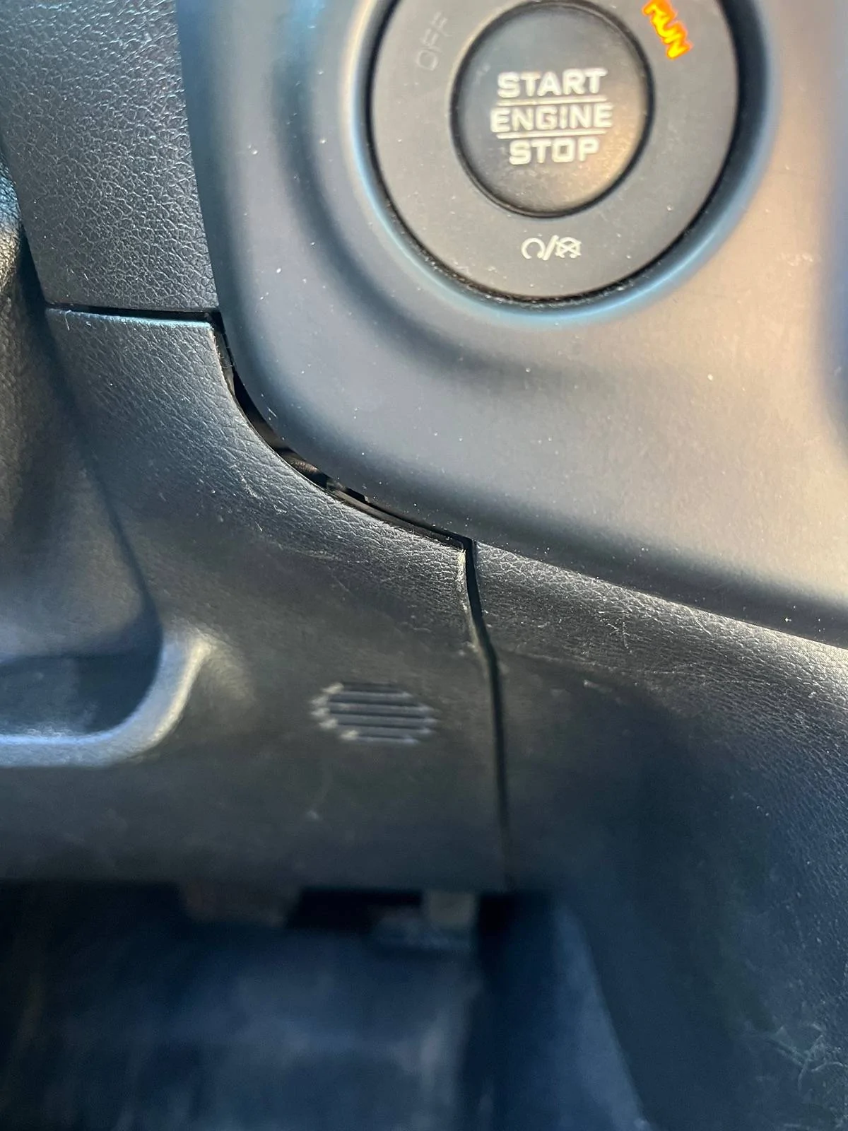

If your air conditioner is on all the time, try cleaning your thermistor as in the picture here, it is at your right knee. You will see a round vent about the size of a quarter. If you pop that bottom panel straight off, it just pulls straight off, Then take some map airspray cleaner and spray the thermistor to clean it. This is a humidistat and
it gives bad readings when dirty and will leave your air conditioner on all the time.
Jeep Wrangler JL A/C staying on auto IMG_1480

Huh, I always thought one of the microphones in the array was behind there to allow the system to filter out the sounds of my knees cracking. Ya learn something new every day.
