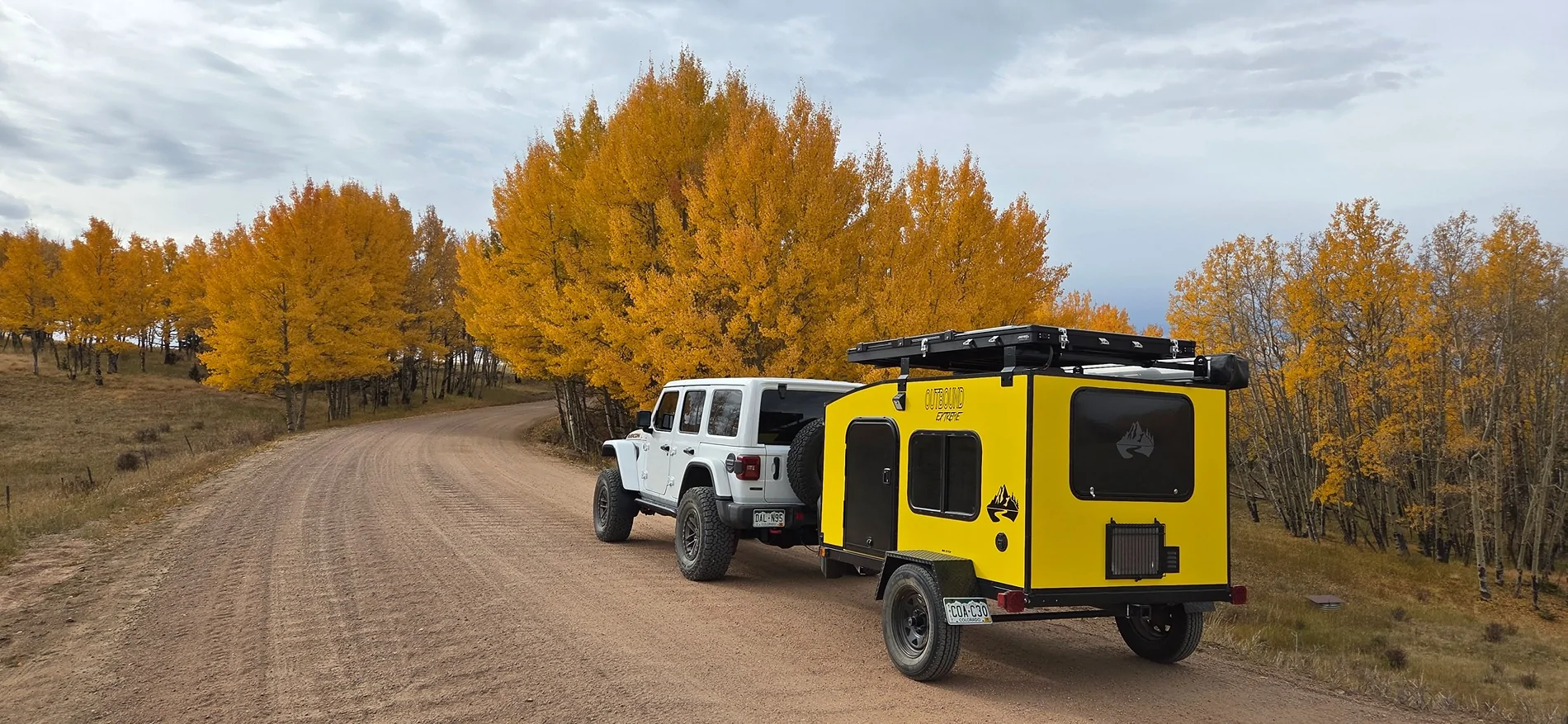

To be clear, im not worried about the weight, more worried about how the trailer will react to not having a controller. I have the tow package so I do have the connector.
Here is what we tow now with no brakes.
If the trailer has electric brakes, they just won’t work without a brake controller. Stopping distance will increase, drive accordingly.
