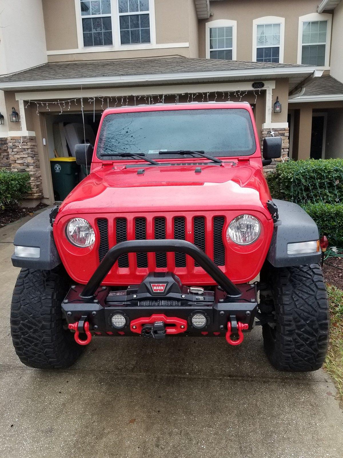

Yeah that is a sweet rig! I'm just hoping to afford to regear and upgrade to 37's when my 35's wear down. I couldn't afford to get a rubi and mods so compromised with a sport with mods.
Does anyone out there have quake tempest series halo headlights? My current lights are yellow and look like dirty teeth next to the nice LED's that came with my bumpers.

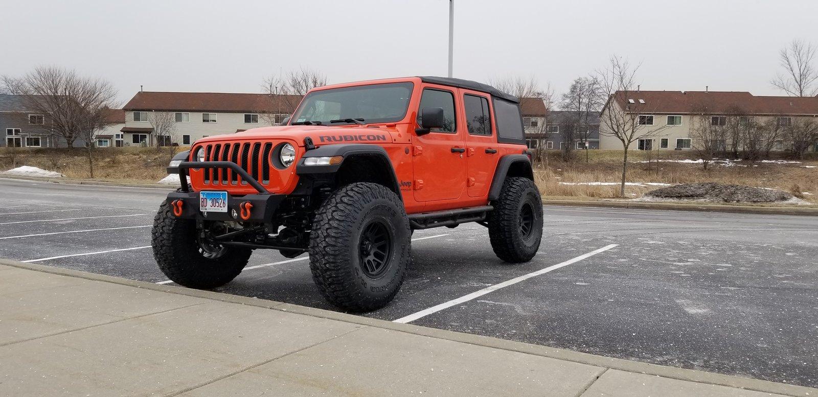

Nice. Can you give us a bit of detail? What lift? How does it drive on the road/highway?
Skyjacker 3.5
Resulted in 5 inches front, 4.5 inches rear
Rancho geometry brackets in front
Core adjustable control arms in rear to push axle back
2.875 backspacing
The steering was super sketchy when the jeep was stock. With the addition of the lift and geometry brackets it has gotten better but still stinks. Brought it in while stock and dealership said the steering was normal... May upgrade all steering components on my own.
I have the Quake Templest Halos. Geri greedy to install the matching fogs (hopefully this weekend)

Nice, they look awesome! Yeah I'm gonna put in that order next week when I get paid.
When the all of the lights and halos are on, does it look very bad that the fogs don't have Halo's or do you just have more of a preference in making them match?
When I bought my bumpers they included some really nice fog LED's in the package, they just aren't Halo's. I'm hoping to just change the main headlights unless they end up really not looking good together.

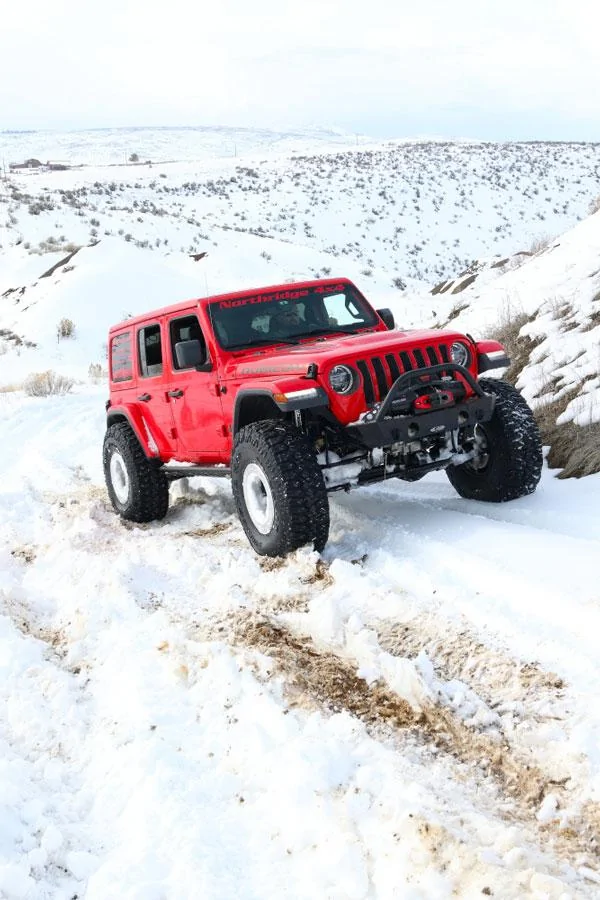

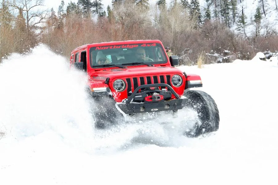

First run with 40" Patagonia MTs on the Boss' JLUR this past weekend.
Jeep Wrangler JL 40'S on your JL David-JL
They definitely can kick up the snow!
Jeep Wrangler JL 40'S on your JL David-JL-3
