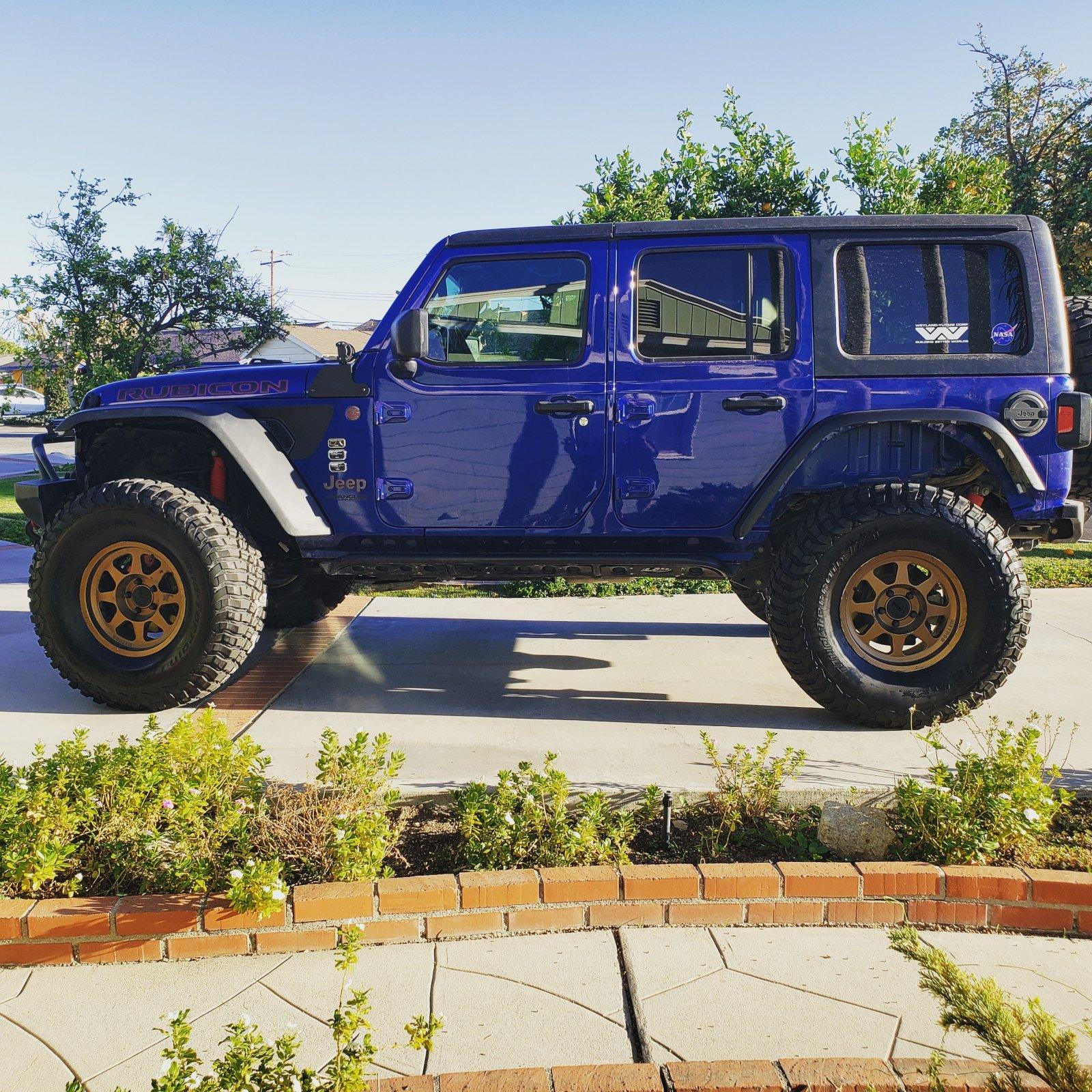

Will my axles last? Time will tell, not really worried about the shafts, tubes and ball joints since I'm trussed, running RCV's and cromos and dynatrac ball joints, it's the Ring and Pinion but I do like the tires. I wheel nice and slow but do run some difficult trails.
They meausure out to 37.5 mounted.

Looks good...Are you running 4.75 backspaced Methods with 39s?

Axle wear aside, those shoes looks BOMB?

Gotcha...I imagine your mileage didn't take a hit bc 5.13s with 37s is geared more for performance. 5.13s with 39s is closer to stock gearing. :beer:
Yes when I go to 60's I'll go to 5.38, I am still a little better than stock though.
