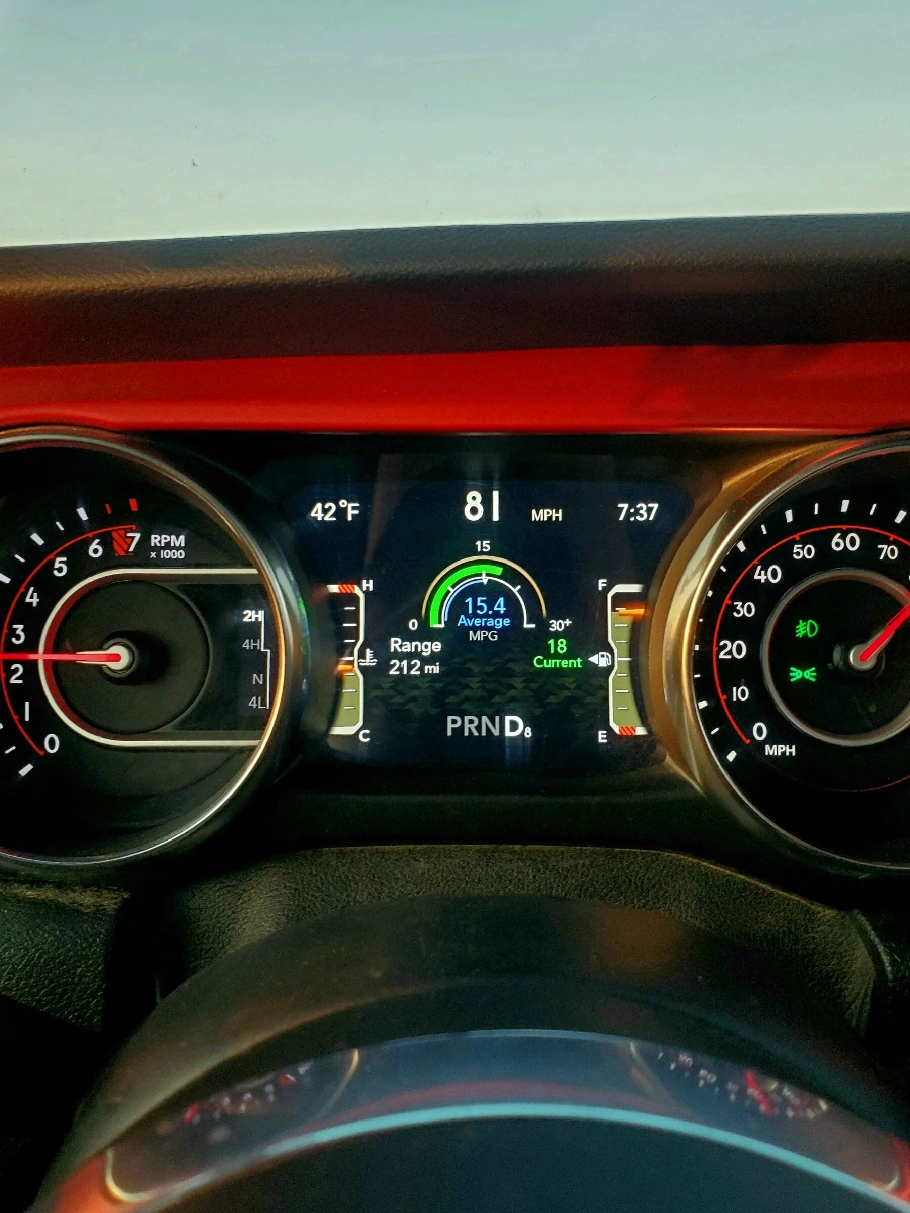

JLUR 4Door 3.6L Auto
Metalcloak 3.5"
Nitto 38x12.50R17LT
Dana Spicer 4:88
Tazer Mini adjustments to Tires & Gears
(Full Build in Showcase)
HWY Flat drive here in pic.

I was gna be like how on earth do you get ~15mpg avg with 38”s but then I saw the 4.88:1 regear. My 3.6auto JLUR gets ~15mpg on 35” ko2s on my stock 4.10:1. Although, It was about the same ~15mpg even on stock 33” ko2s so I didn’t see much of a drop.

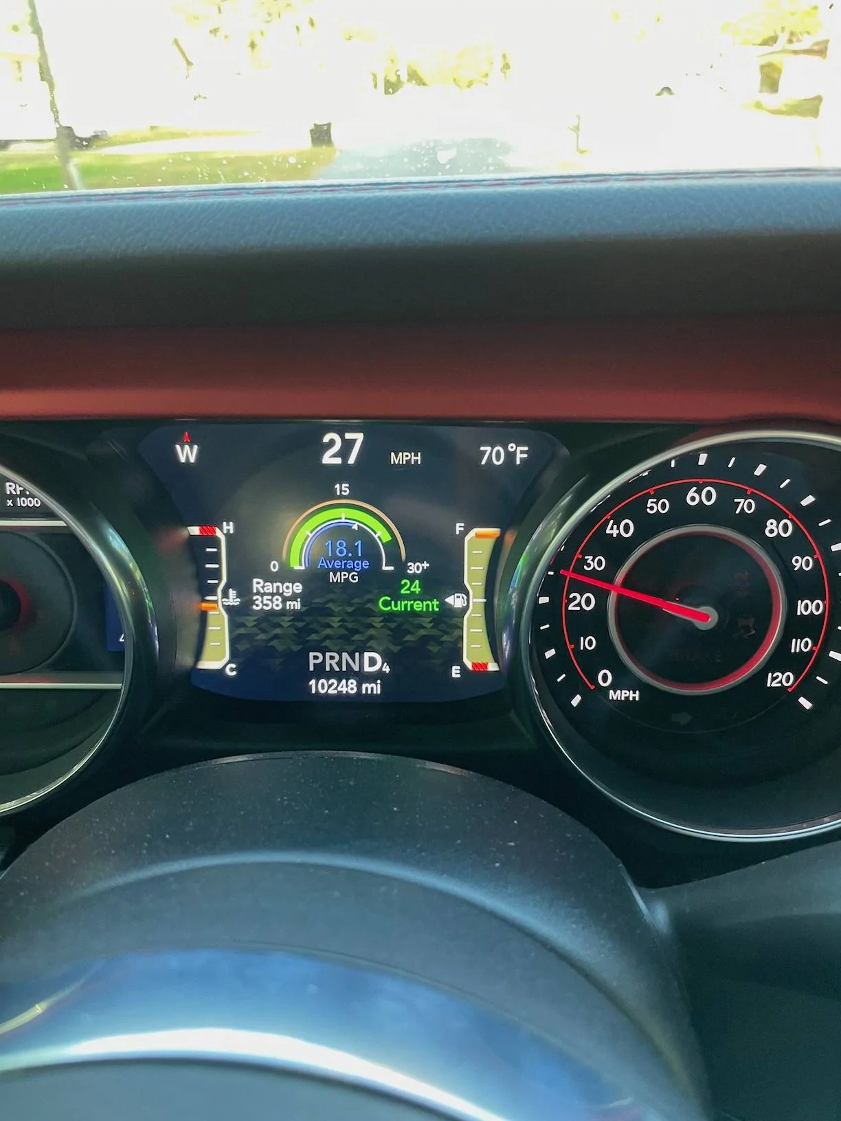

Currently driving a 2020 Rubicon JLU on 37x12.50x17 Trail Grappler shoes with stock 4.10s… I’ve not had any problems. Moving to 4.88 gears as an “immediate need”… No. You may not see eighth gear unless you’re on a level grade with a tailwind., but it’s not been an issue for me. Right now it’s mostly trails and pavement. Once I start doing more overlanding and rocks, I will move to 4.88s, but axles and other items will also drive that move too. Hope this helps.
There are lot's of variables, but is it an "immediate need" - no, will your personal Jeep experience be better re-gearing - absolutely yes!
I'm driving a 2020 JLUR, 3.6, Auto, heavy 37"s (Ridge Grapplers), Bead Locks, 3.5 lift, tazer.
Started out with 35's and 4:10's, then moved to 37 Ridge Grapplers/Bead Locks and 4:10's for about 8 months. Drivable yes, but didn't see 8th much, on a trip couldn't hold 8th with any incline or a head wind, in fact even on a flat had to use "manual" to keep in 8th, mileage 15-17, sluggish getting going. Off road, just Ok. Obviously changing to 37"s will add more stress to the drivetrain and your wallet. IMHO this is a no-brainer driving the 3.6 JLUR, you will want to and certainly be happier re-gearing (I am). Start saving, and move to either 4:88's or 5:13's dependent upon your use/environment (do the math but also account for rolling mass, extra weight for aftermarket goodies and what/where you'll be going (highway, trail, rocks or a combo).
So was in some traffic, but IMO getting good MPG and shift points are excellent running 4:88's and 37's.
