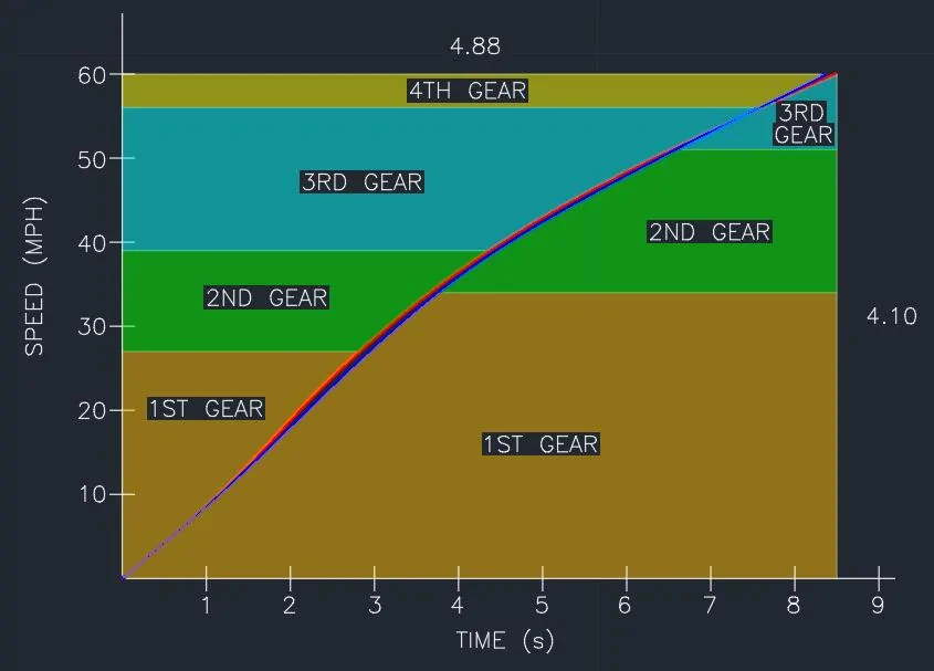

RE-gearing will just get you to the next gear quicker. With that there are probably benefits in climbing and perhaps MPG but for me, there was little to no difference in acceleration and 0-60 time between 4.10 and 4.88 with 37" tires:
