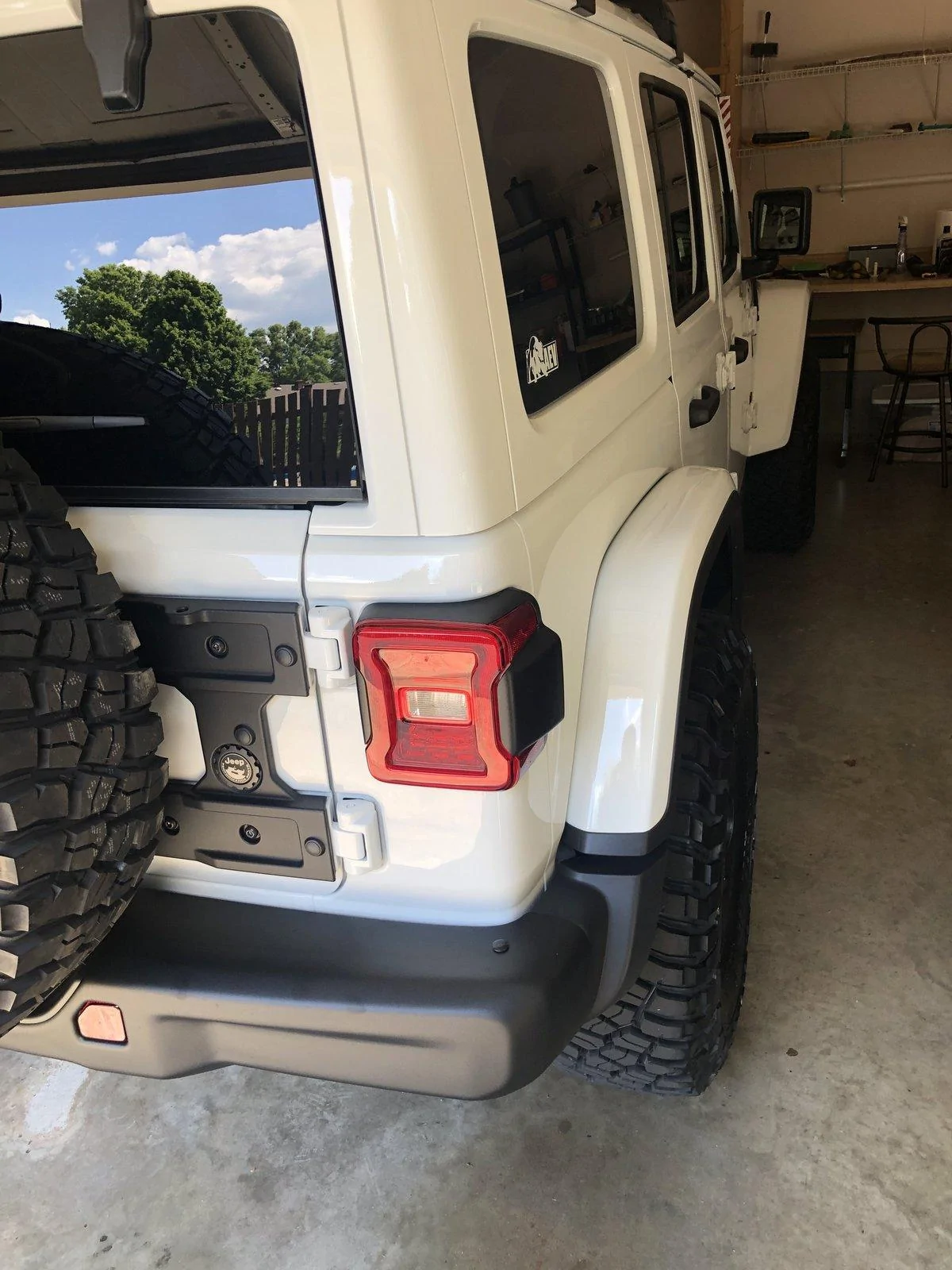

I think you’d be ok with nothing but the tailgate might sag and bend over time. I have similar weight and just did the reinforcement piece and not the oversized carrier. The OE brake light can be moved up. Many think the reinforcement is a waste. If you have the money I do not think that. It makes the tailgate beefier to prevent that bend and sag. It doesn’t address the hinges though and from what I’ve told that’s ok. The reinforcement can be found on eBay for like $480-490 which is $100-150 cheaper than online. Falls city Mopar is who I got mine from. Hope this helps.
