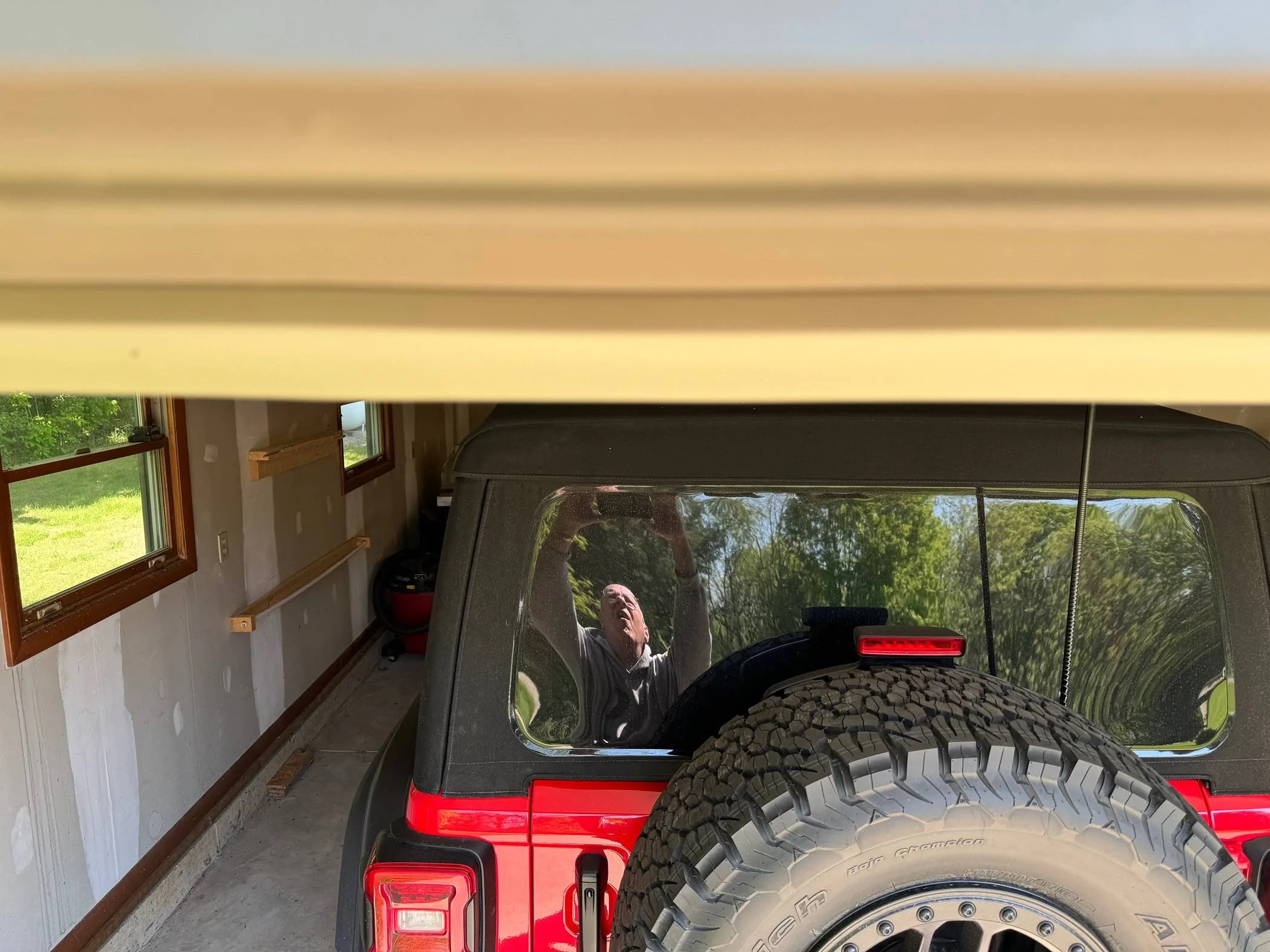

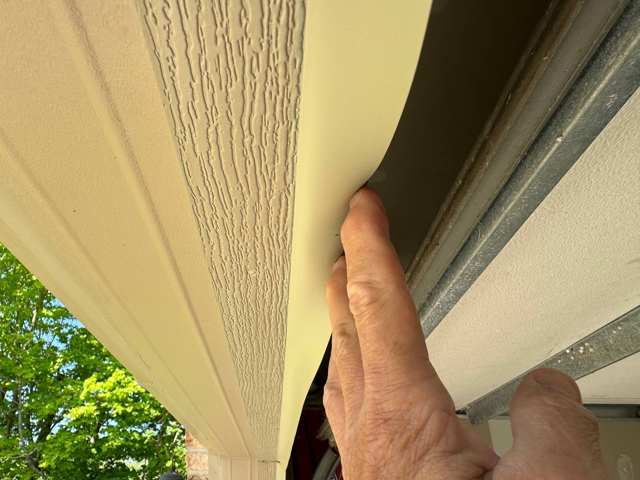

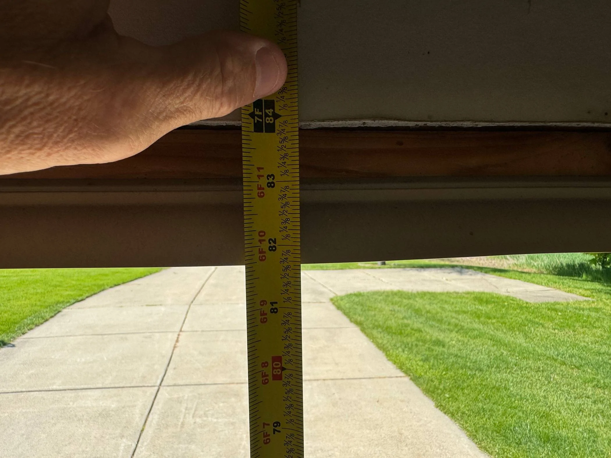

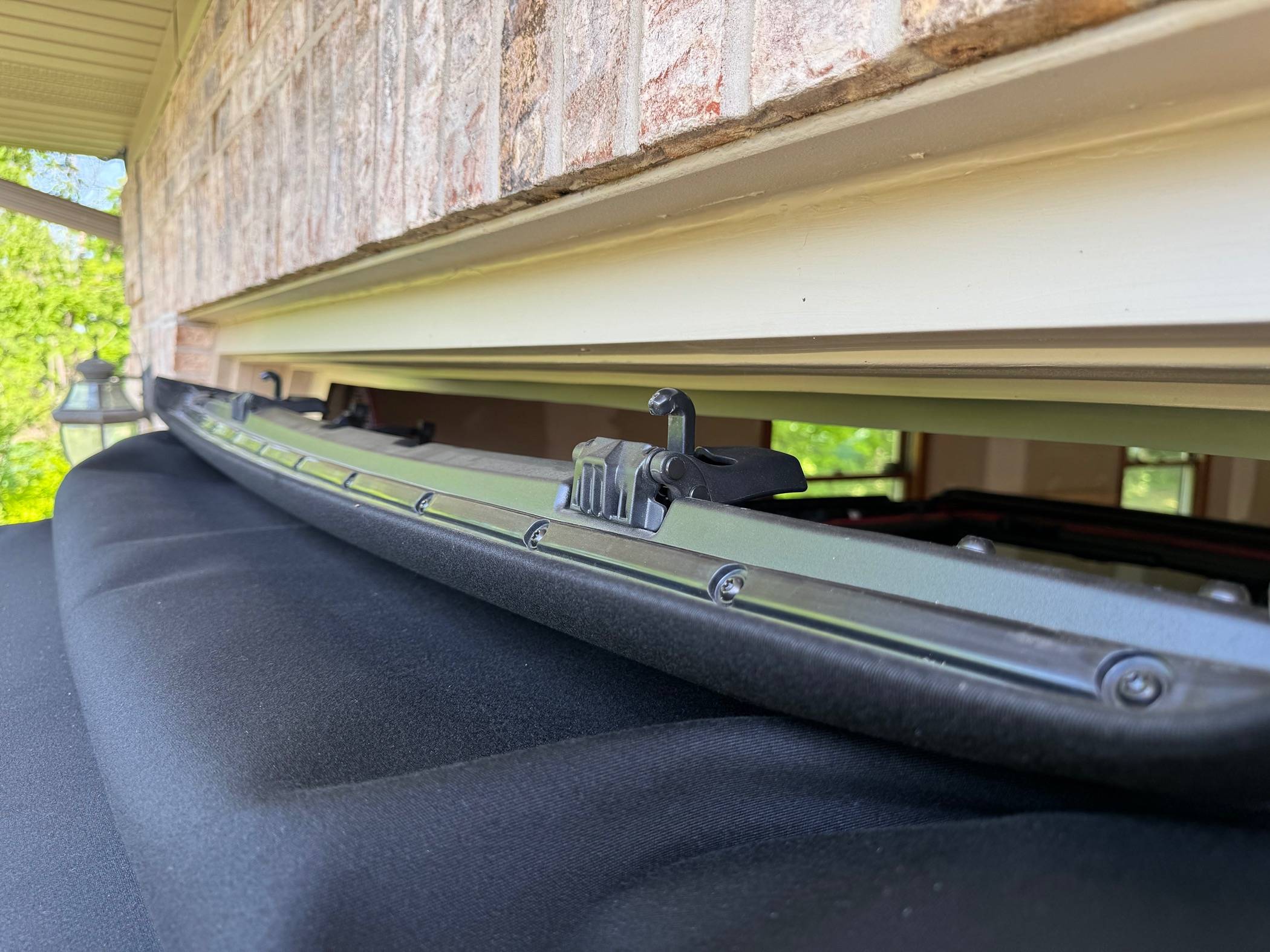

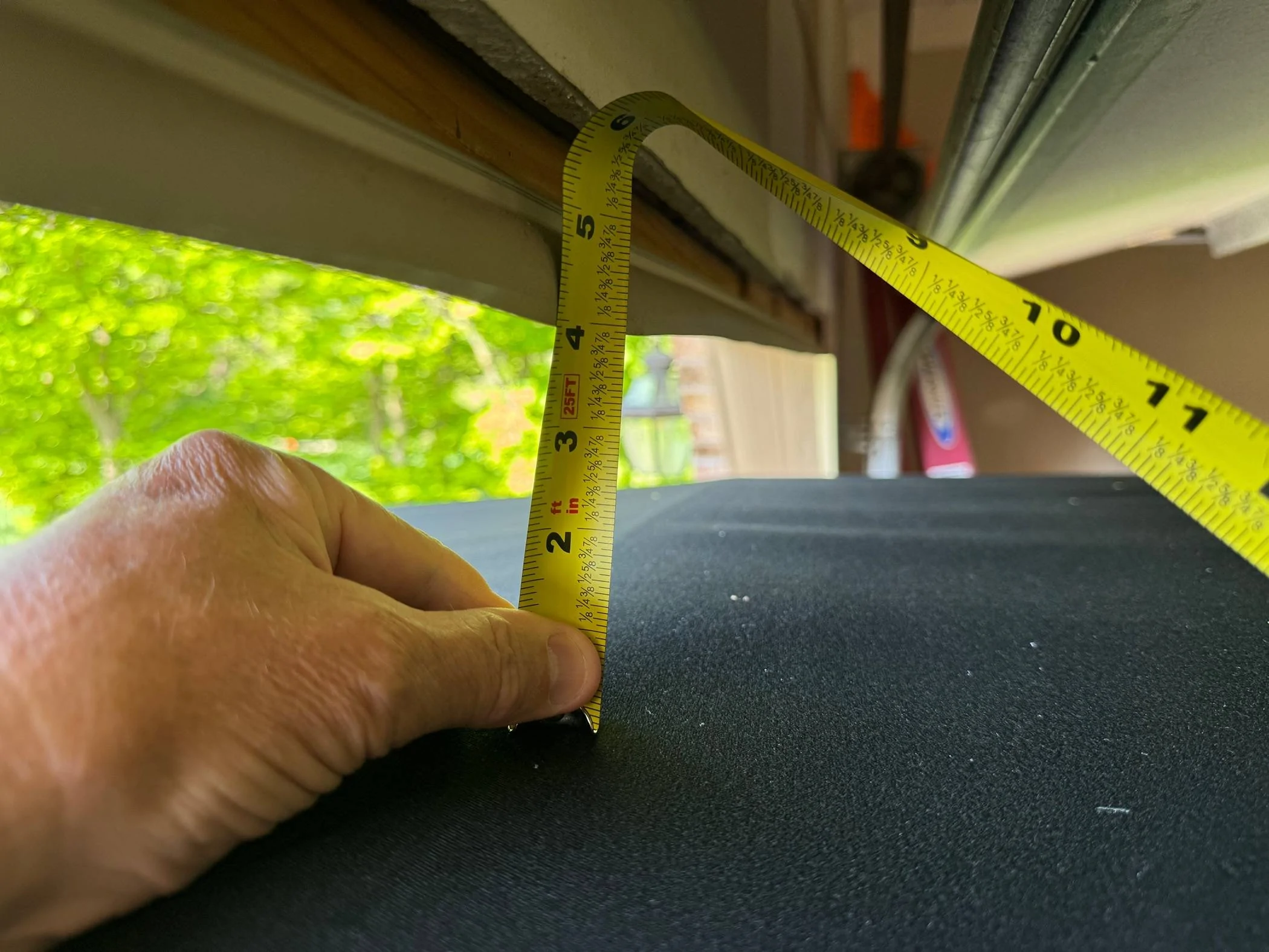

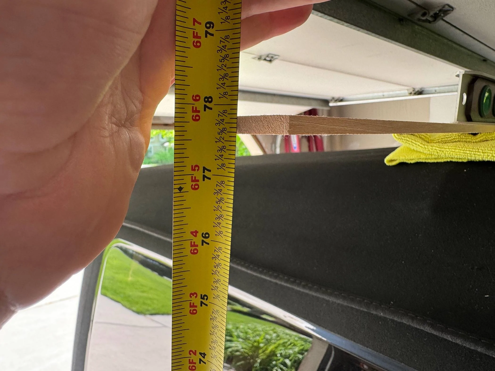

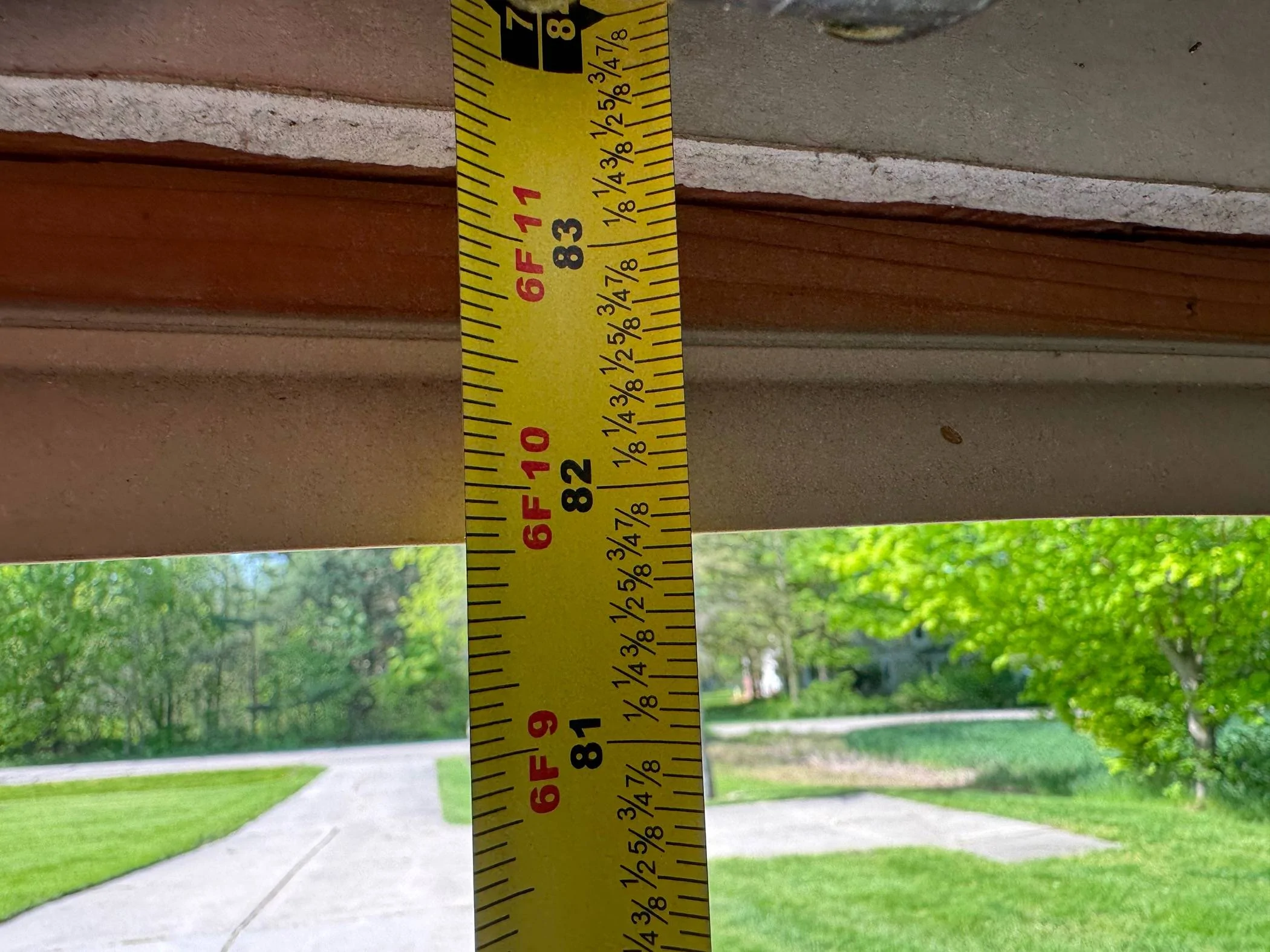

It’s close. I have a 2022 Rubicon with the XR package and 315/70 tires. Door opening to the rubber weather strip is 82 inches. There is about 3.5 plus inches of clearance to the tallest part of the soft top. I cannot get it in or out of the garage with the sunrider section open. Simply not enough clearance. I have to open the sunrider outside of the garage and close it before I go inside the garage. I almost forgot to stop once because my wife beat me home and left the overhead door open making me think I could just drive in. Generally if I open the door myself, I’m more inclined to stop. It would be a disaster if I didn’t.

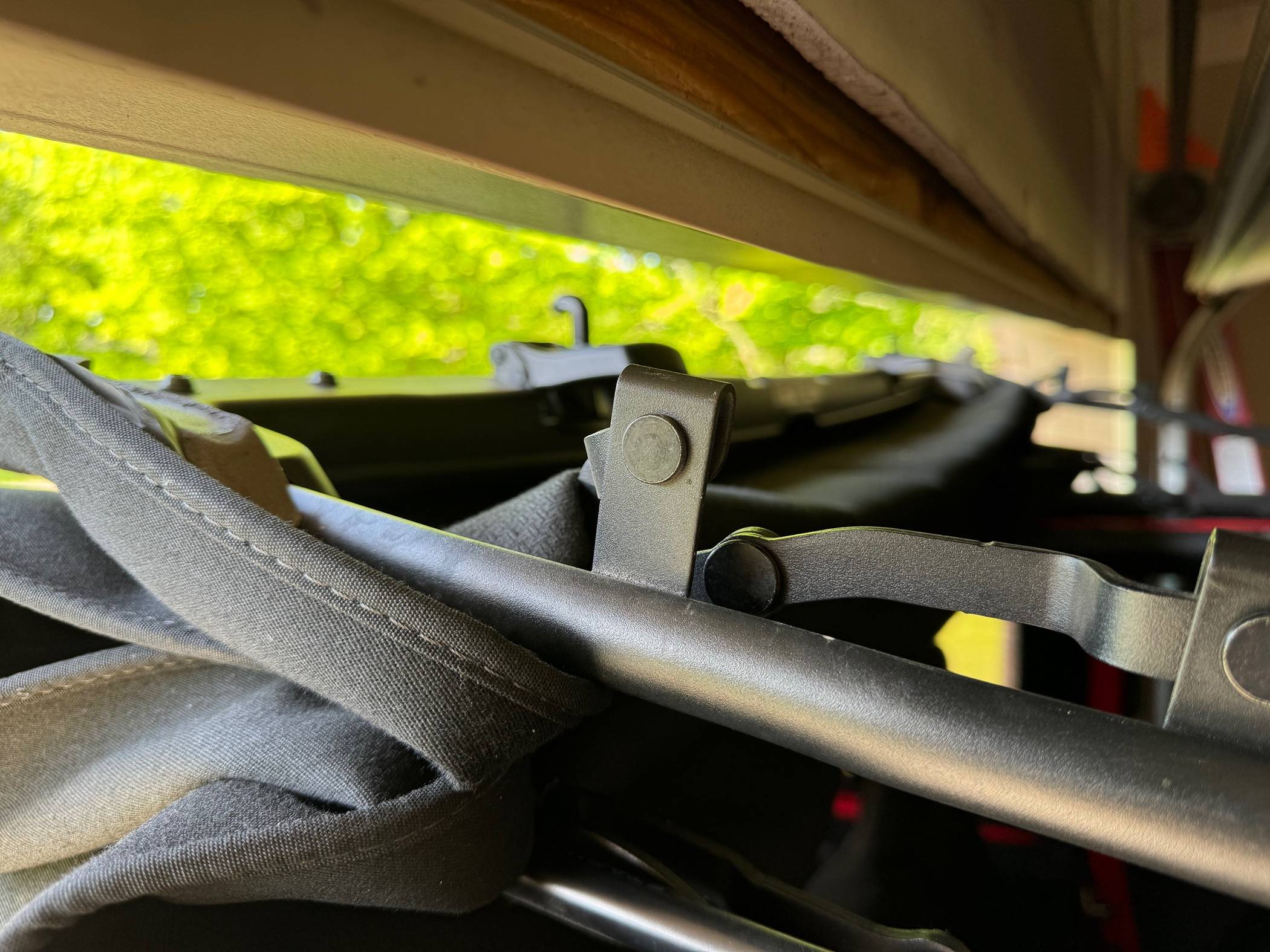

I have a 2023 Rubicon with XR (35s) with soft top. Mine does clear inside a 7ft garage door with the top closed, however it does NOT clear with the sunrider open, the latches strike the trim, it was very close. Unfortunately I learned the hard way , but no damage was done when pulling into the garage.
That's super close! Is this a 7ft garage? Maybe my memory is off and I actually have a 8ft garage because it clears with a ton of room to spare. I cant imagine one of these cookie cutter builders actually used something non standard for once lol.
I also can't operate the sunrider feature inside the garage though, have to open and close it outside just like you.

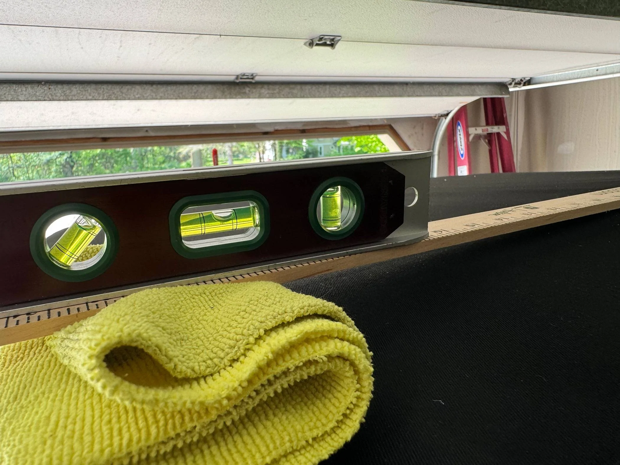

Yes it is a 7 foot tall Overhead Door Company door (4 sections). The rough opening is about 83 inches. The door molding with the rubber strip allows about 81 3/4 inches of clearance into the garage however the rubber strip itself is about 1 1/4 inches. If you’re at 81 plus inches tall, that’s close; too close in my opinion. However there is 3.5 inches of clearance to the rubber strip when driving the Jeep in and out.

Same, had to have the wife climb in and hold it down while I pushed it out. Hopefully I never forget again!

My opening to the bottom of the rubber strip is 81 3/4 inches. The tallest part on the Jeep (center of the top left to right) is 77 1/2 inches. It’s close, but it does fit. My 2022 2 door Rubicon with 315/70 tires and 2.5 inch lift would go in and out of the garage with the sunrider open; but it has a smaller opening so doesn’t open as tall.
