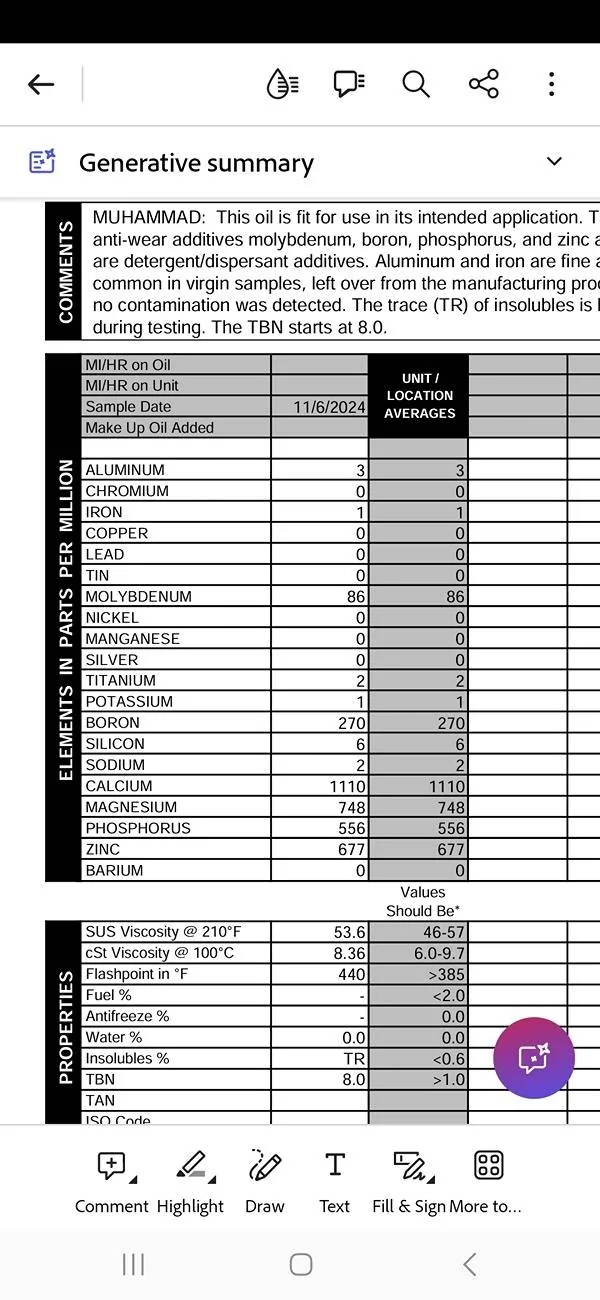

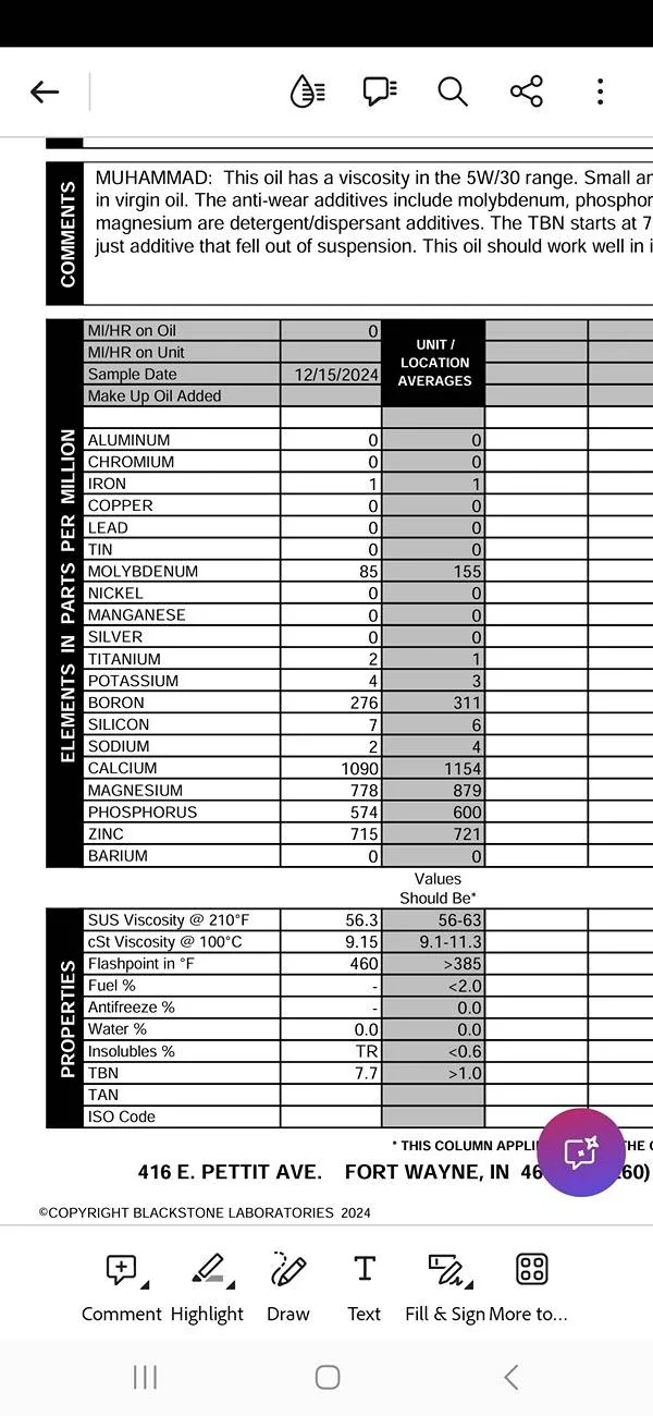

So I just received the report from Blackstone on virgin oil analysis of PUP 5W30. Compare it against the PUP 0w20 that I received 3 months ago. The difference is so tiny. Why would anyone even bother running 0w-20?
Jeep Wrangler JL 3.6 longevity solution Screenshot_20241226_160330_Adobe Acrobat
Jeep Wrangler JL 3.6 longevity solution Screenshot_20241226_160430_Adobe Acrobat
Like I said, tenths difference between 0 & 5w.
It’s not about engine longevity. They need every tenth of a tenth mpg fleet average they can get.

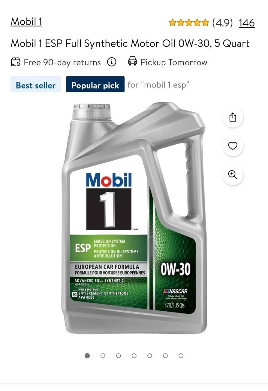

I would run this in Canada. 1000 ppm Zinc 🤩
Jeep Wrangler JL 3.6 longevity solution Screenshot_20241225_223912_Walmart

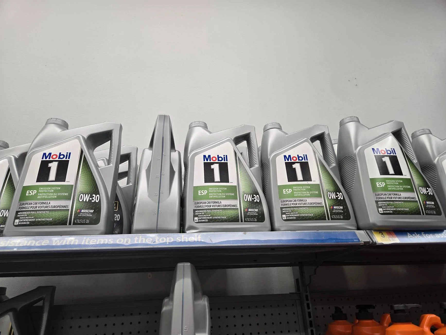

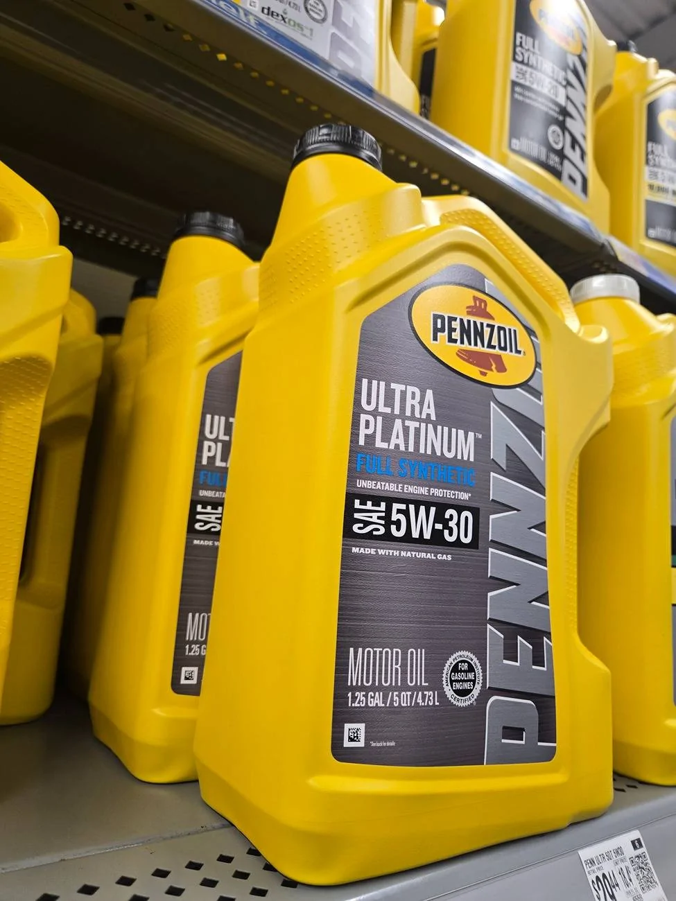

So this is my final decision. Mobil 1 ESP 0w30 in Nov, Dec, Jan and Feb. PUP 5w30 rest of the year. I think I like my decision as Walmart has the two by the truckloads 😄
As I reply earlier, I think a look at the error margin maybe in order as the virgin sample of 5w30 is coming back as 9.15 while my 3k miles use sample of the same oil came back as 9.7.
But the difference between 5w30 and 0w20 is still obviously tiny. No?

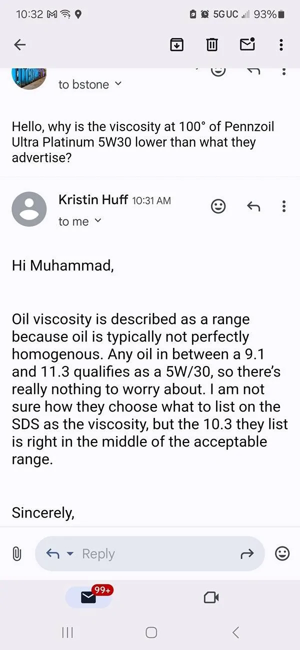

Jeep Wrangler JL 3.6 longevity solution Screenshot_20241227_103229_Gmail
