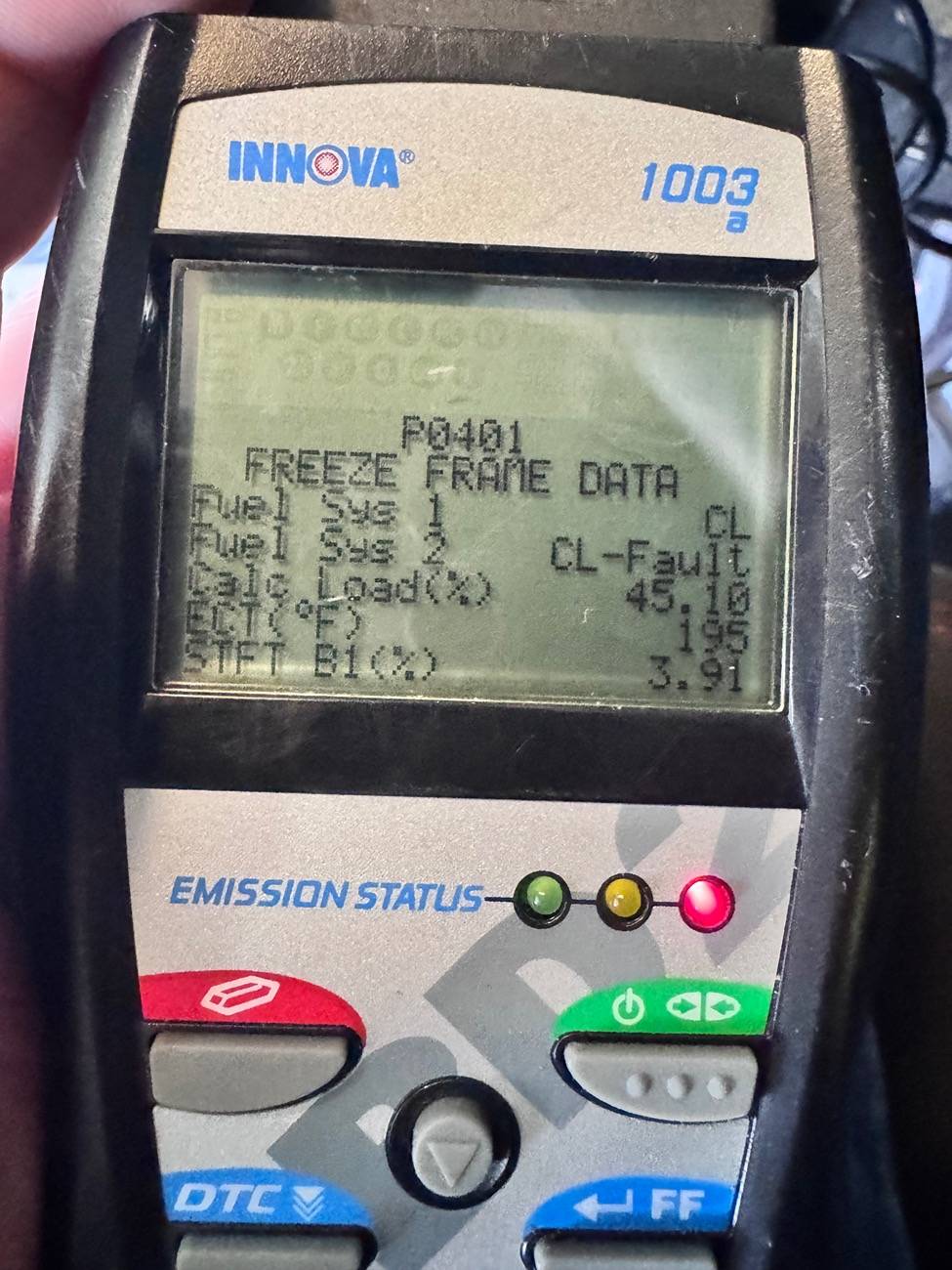

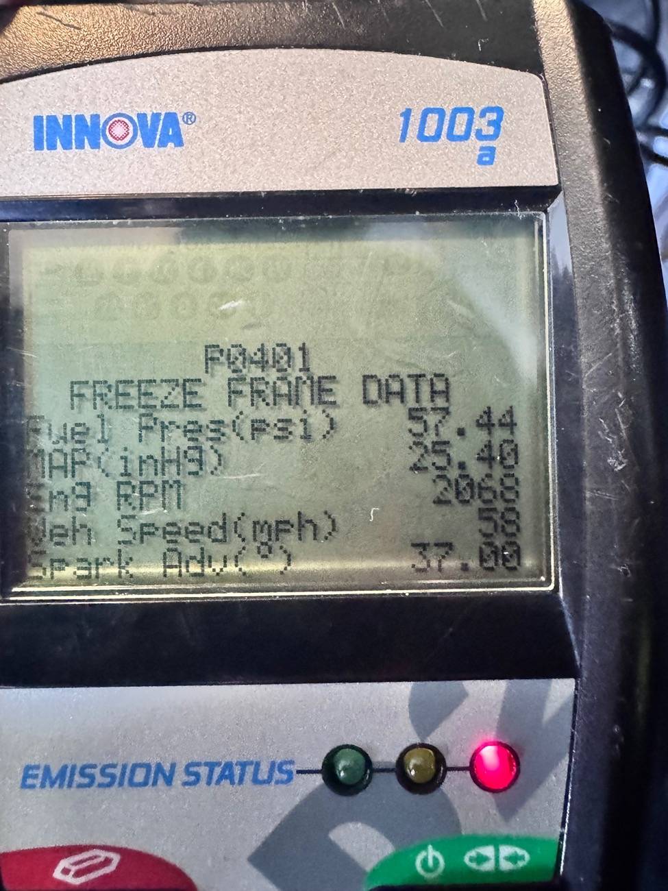

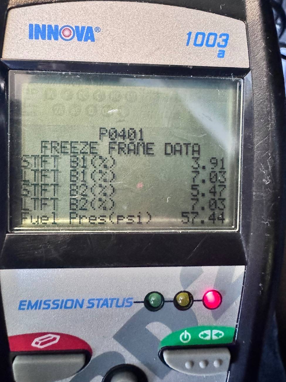

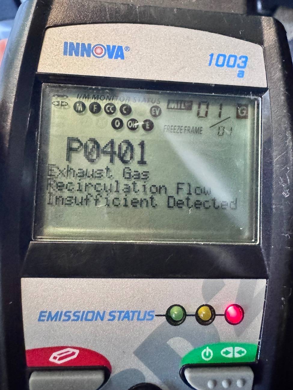

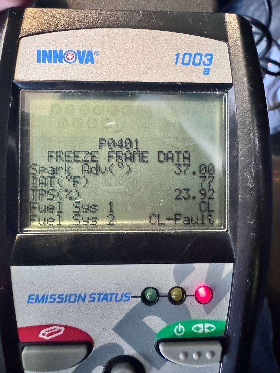

Replaced egr valve 1 week ago . Code cleared its self . Ran for a week and now same code 401 . This is my freeze frame can anyone see issue?

So I had replaced egr valve but code would pop up every 900 miles found out you have to do egr replace function on quality diagnostic scanner so I bought one and all good now .
