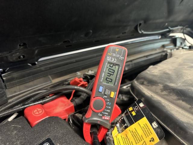

Took it back to the delaer and they said the main battery was still good but they had to replace the starting battery for the third time. The main battery was only replaced once, that was when the Jeep was a year old. They have changed out the starting battery 3 times, aprox once a year.
I got a DC amp meter and tested after the jeep has been sitting for a couple hours. The meter jumps arround. It sits at 0.5 for like 10 seconds, then jumps to 4.0 for a few seconds then to 1.0 or 2.0, then back to 0.5.
