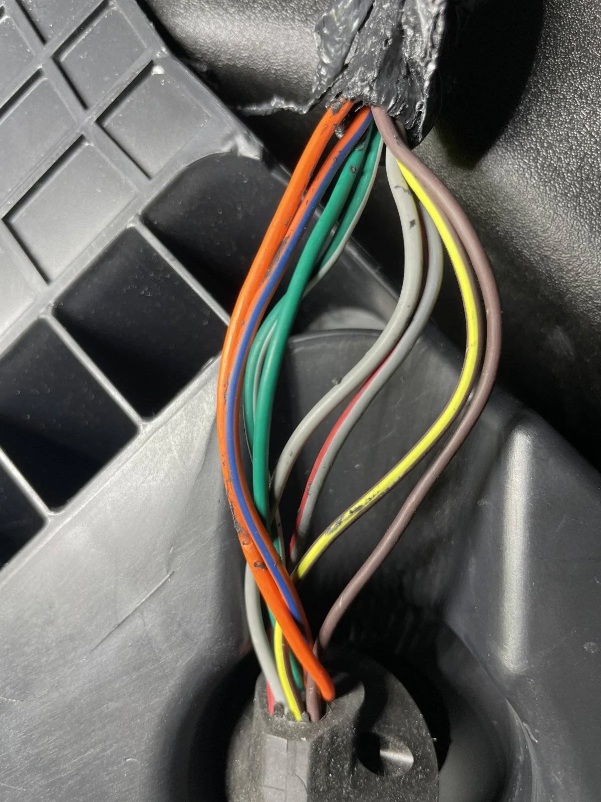

Hey everyone, I’m trying to find the color code for a 2019 JL 2 door (in floor) subwoofer. Any help would be appreciated…
I want to use the wires to feed the high inputs on an under seat subwoofer?

Thanks, but the diagram doesn’t match! There are four sets of wires just like in the diagram however, the colors are solid green/green with white stripe, solid gray, gray with red stripe, solid orange, orange with blue stripe, solid brown, brown with yellow stripe. As happens sometimes, the diagram doesn’t fit at all.
Looks like the stripes are positive, so when I hook up the new sub woofer I’m just wondering how many of the 4 positive wires should I Connect to the sub woofers hi input positive?
All of the wiring diagrams are in this forum. You can look here: https://www.jlwranglerforums.com/forum/threads/jeep-jl-wrangler-wiring-diagrams.19185/
I can look in my system tomorrow to see if there are any differences between these diagrams and what FCA provided to Mitchell.
