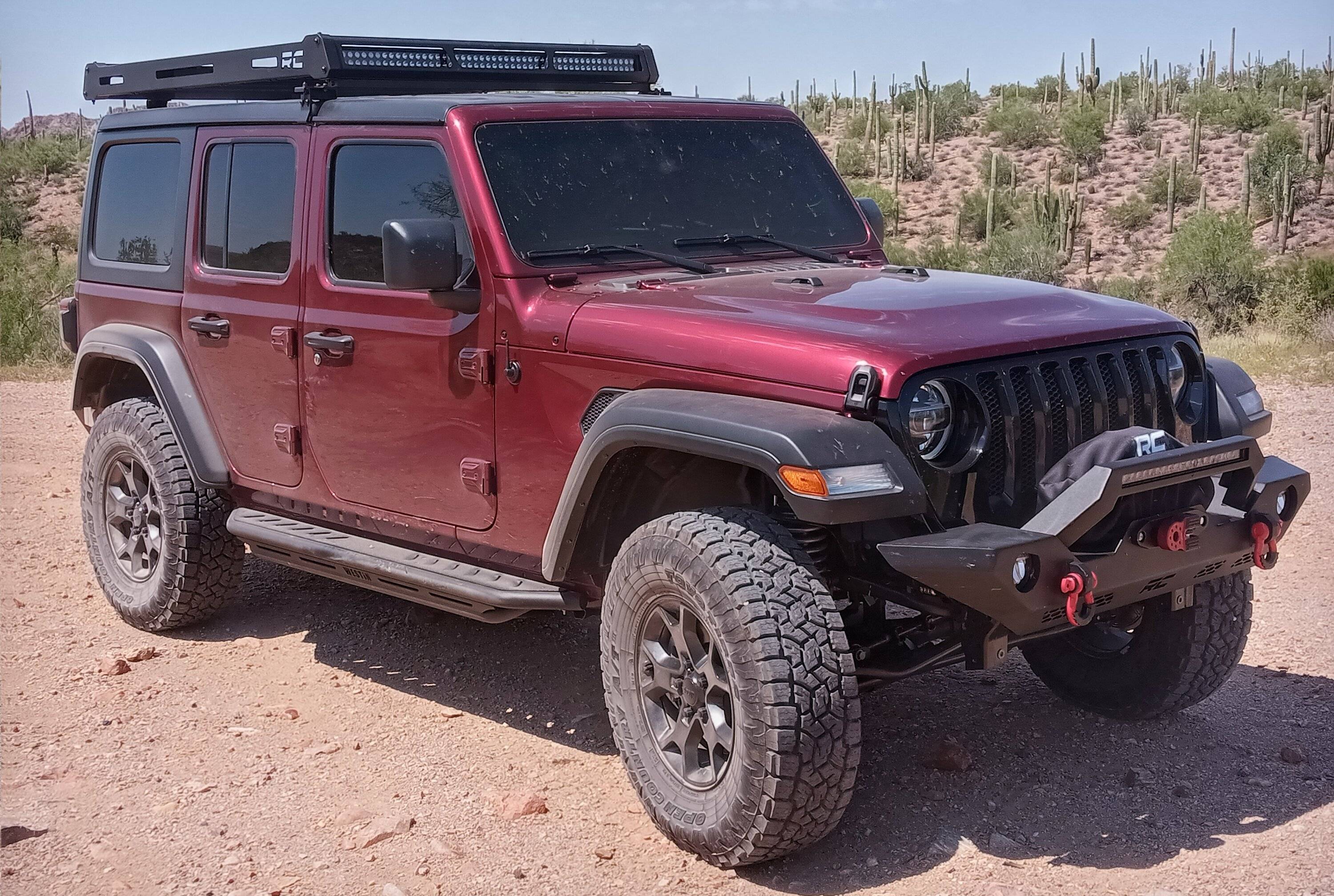

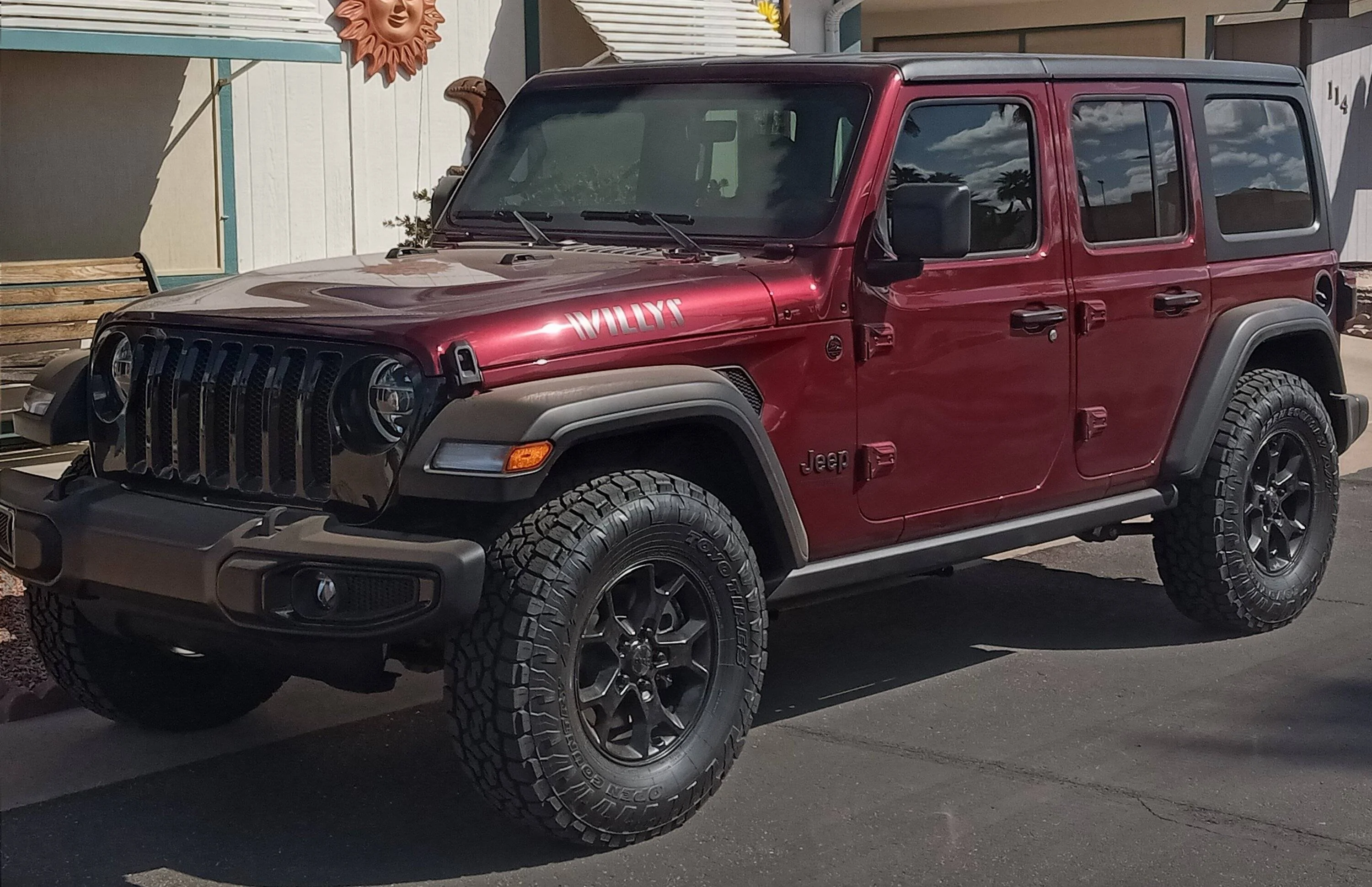

My Willys with 285/75R17 on stock 17 x 7.5" Moab wheels - stock height:
Jeep Wrangler JL 285/75 question 20210304_104806
With a 2.5" lift and a few other mods:
Jeep Wrangler JL 285/75 question 05
Jeep Wrangler JL 285/75 question 20211023_114323
