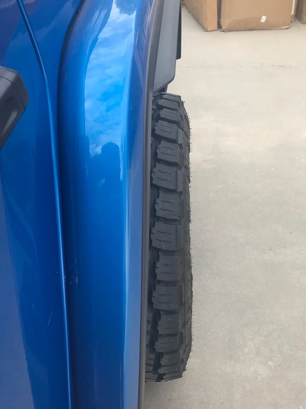

about 1/2” in, the wheel difference is centered with the tread wider so hopefully no rubbing. I would go the other way 1/2” out to ~0 … 8.5” -1mm
Jeep Wrangler JL +25 offset. IMG_1714

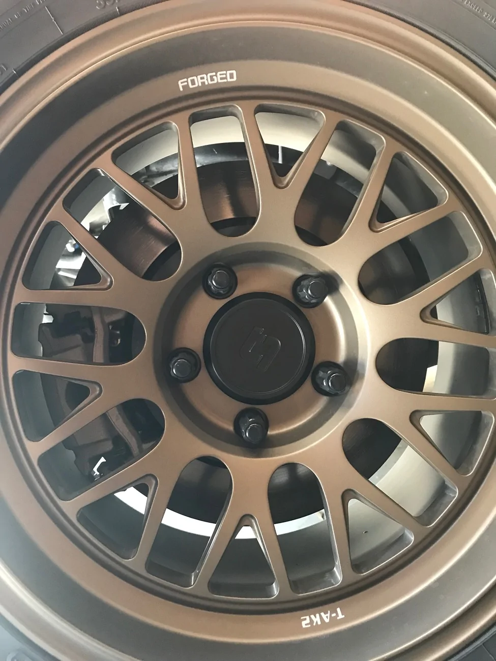

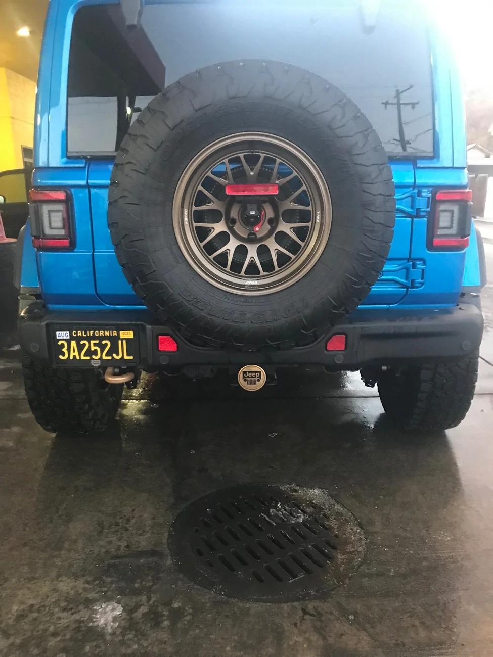

Of course, you will Never want 37’s, will you ?! That’s what they all say, including me. 37’s next time 🙃 I wouldn’t take the chance… Same width axles…… Titan 7, T-AK2 Bronze
Jeep Wrangler JL +25 offset. IMG_2572
Jeep Wrangler JL +25 offset. IMG_1792
At 21/3 lbs, my combo with 59 lb Toyo AT3’s is the same or a couple lbs lighter than the stock 7.5” 44mm BCD’s and 285/70 KO2’s ~80/82 lbs. ….. specs 21 lbs at purchase but their site now shows 23 lbs 🤷🏼‍♂️

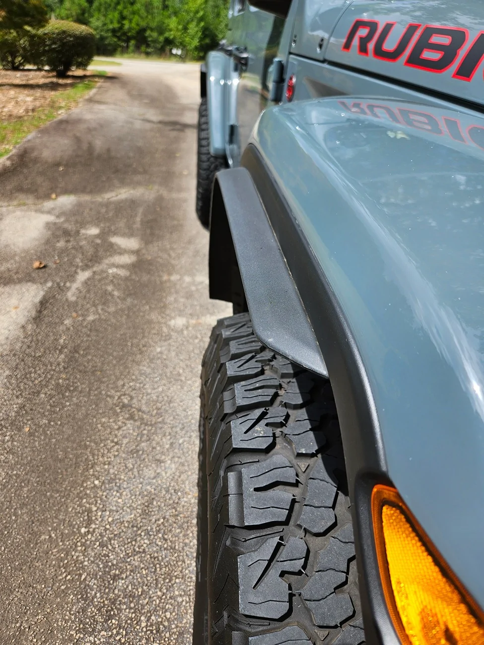

Jeep Wrangler JL +25 offset. 20260722_154238
that's stock
