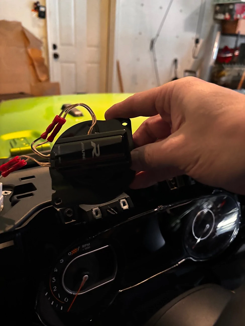

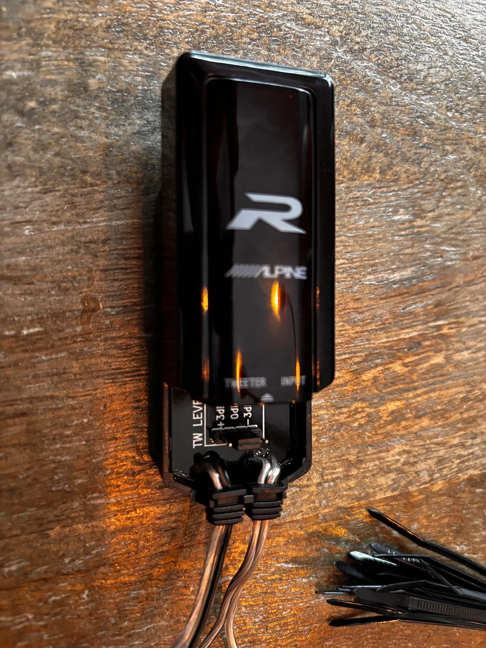

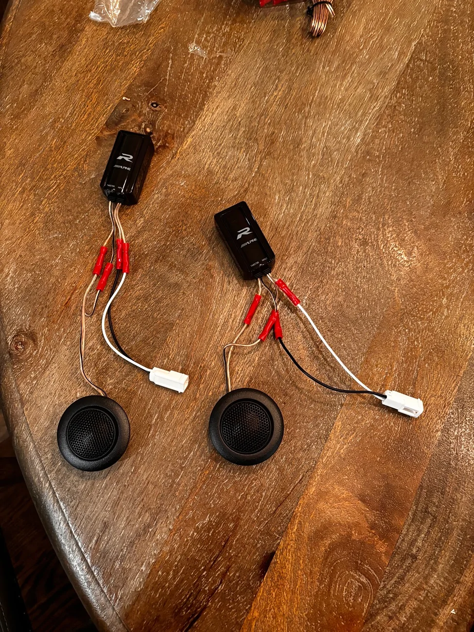

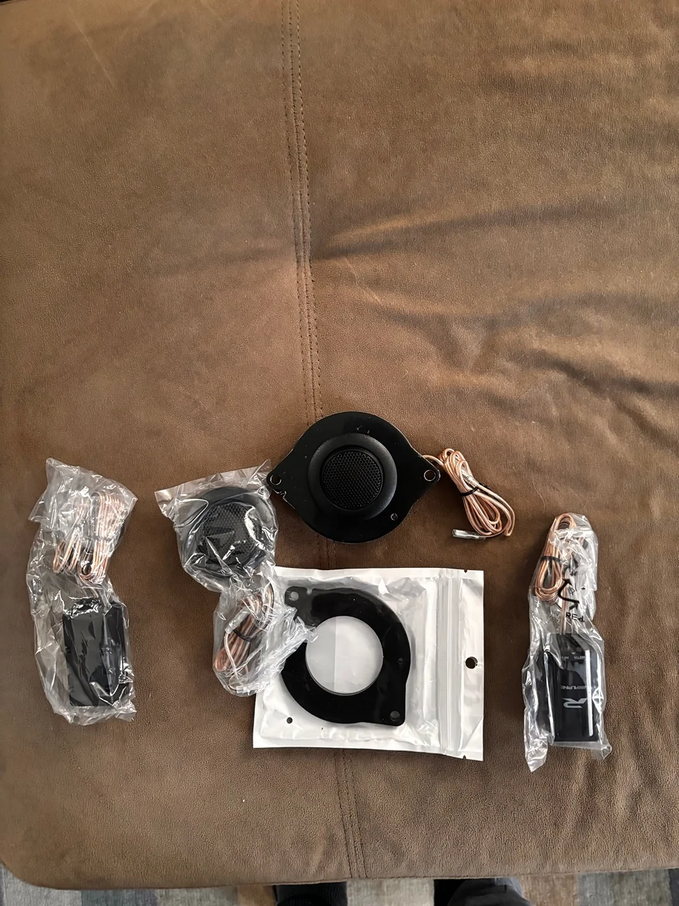

Some pics of the tweeters. I mounted the crossover to the bottom and the fit perfect in the dash. I also wired everting using Metra adapters to connect to all the OEM connectors.

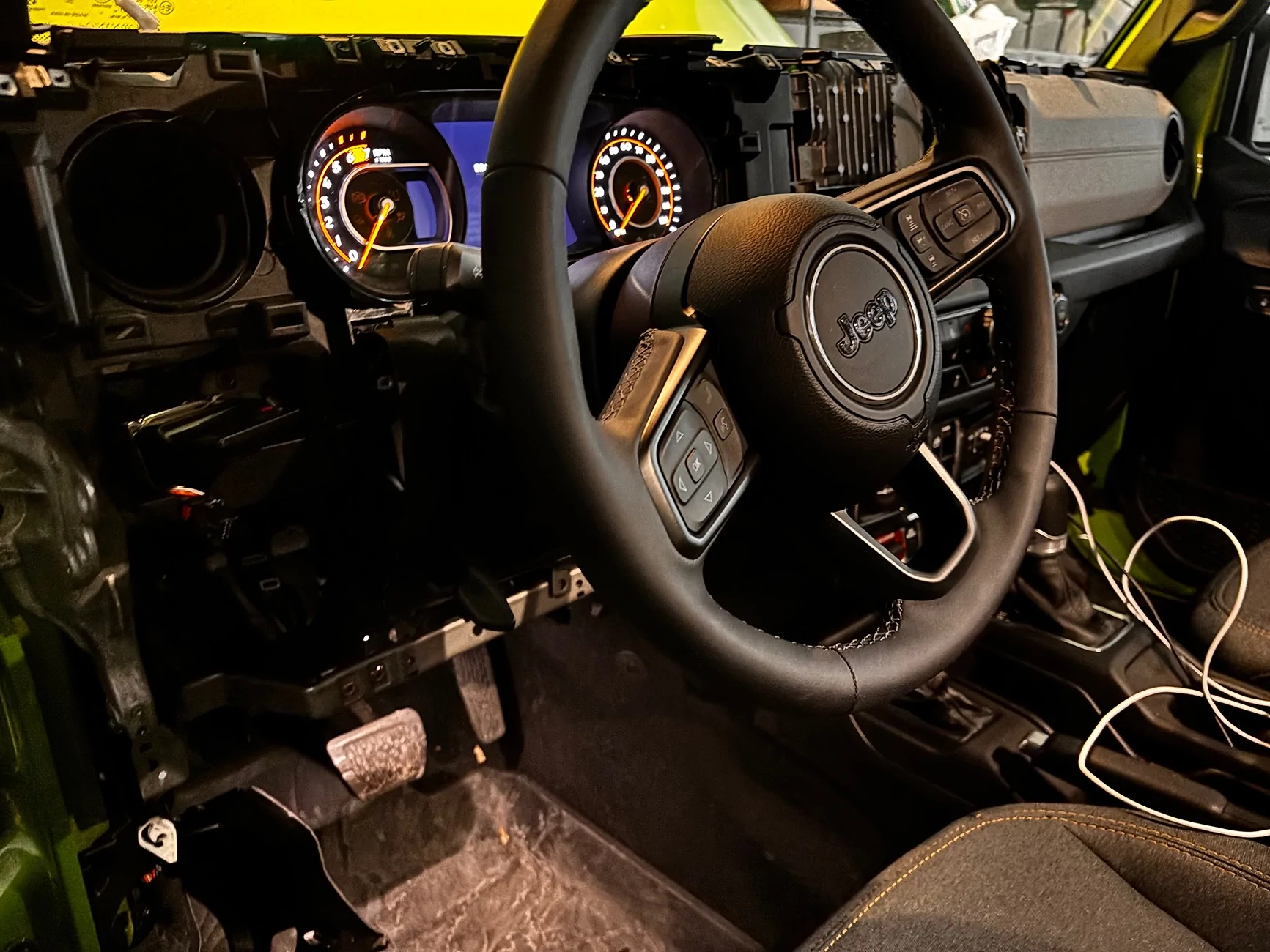

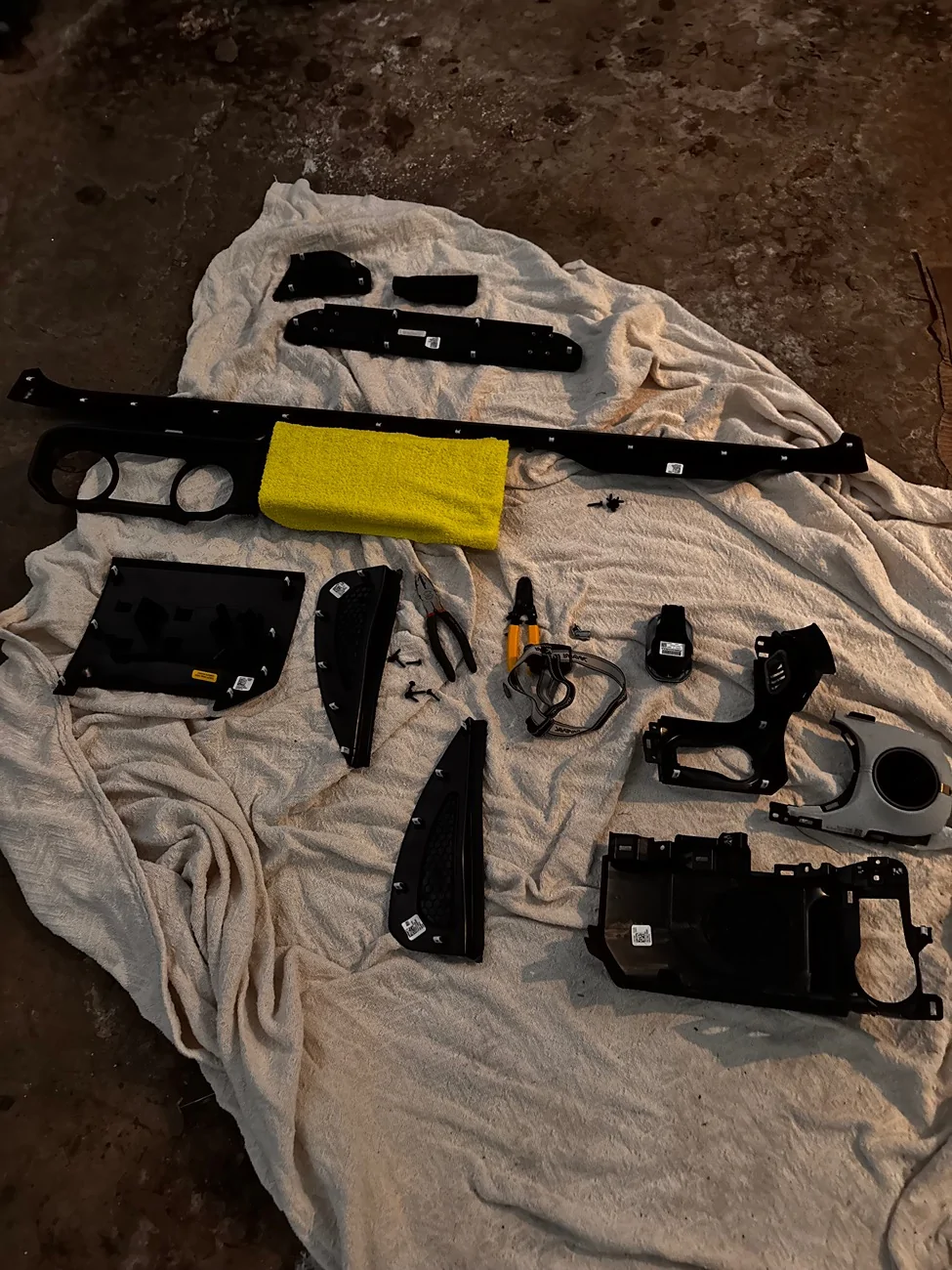

These are all the panels I had to remove to get to those damn pods. It looks worse than it is.

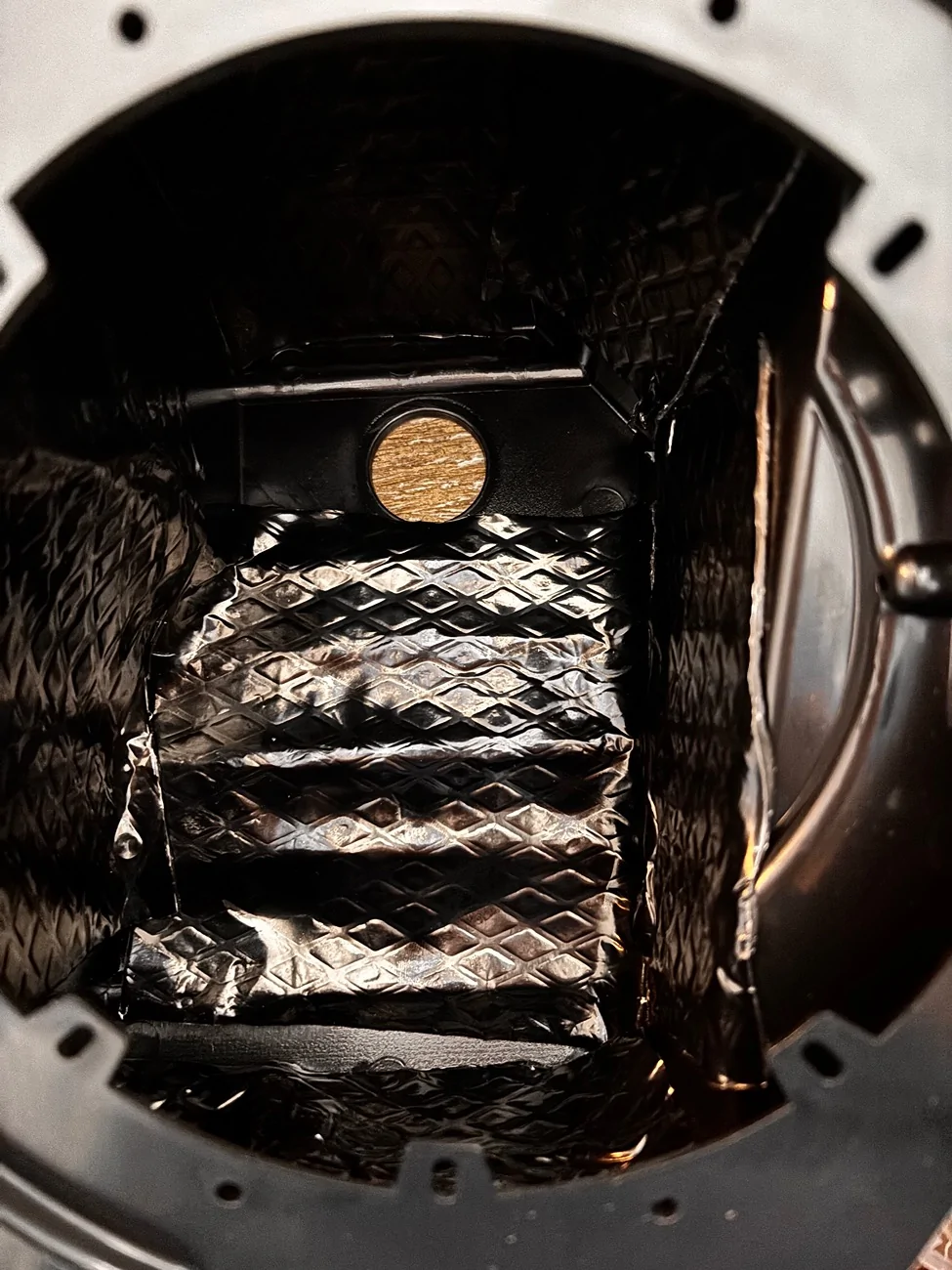

I used sound deadening on the hollow pods and the soundbar.

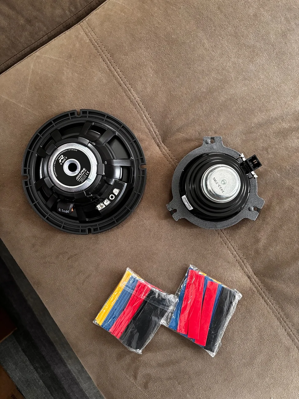

A pic of the 6.5” Alpine R component vs stock 4”.. Pictures are worth a thousand words.
