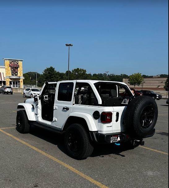

To those who have 2024s and have changed wheels and tires: are there 2024 specific sensors? I know in my 2022 JT there was the year split for sensors so when I ordered my wheels and tires for my 2024 JLU I got the newest sensors. Of course, after some driving they are not reading. Do I need to do a learn procedure? (wake them up, drive, etc)?
Also, has anyone with a 2024 changed speakers? I got a 4xe sport S - basically because I didn't need to go higher trim for my daily and the non-Alpine system is garbage. I want to upgrade speakers (i realize that an amp is needed to get great sound but I'm certain an aftermarket speaker option will be at least measurably better than factory) but I dont know what sizes to get. I have to assume they are the same as 2023 despite the soundbar redesign. mall crawling PFA
