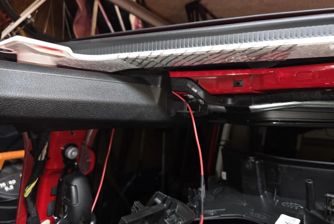

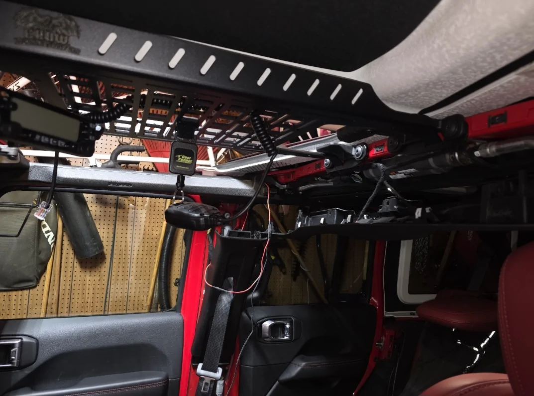

I'm planning on mounting a Icom 2730 head unit, Icom mic, Icom speaker, & a USB power outlet to Overhead Molle panel. The Icom main unit will be in the glove box.
My question is how have folks wired the molle panel mounted radios, accessories, etc? What cable routing have you used....via the "A" pillar or "B" pillar? I would prefer the "B" pillar but the side curtain airbag trim panels don't allow any extra room. I did run a single red wire in a small gap next to the pax side "B" pillar, airbag, & roll cage, but there is not enough room for the speaker & RJ11 cables for the radio. (see pics)

How did you get the upper piece of the B pillar plastic popped free?

I've got the Epic Adventures CROW overhead panel. Ran all the wiring for my Switch panel, Radio, Red LED lights, etc. up the passengerside A Post behind the grab handle and under the plastic moulding straight to the rearview mirror area and out.
Some wiring came from the engine compartment through the cowl and up and the rest from the rear along and under the bottom door panels. Tilted out the windsheild to make running it easier.
