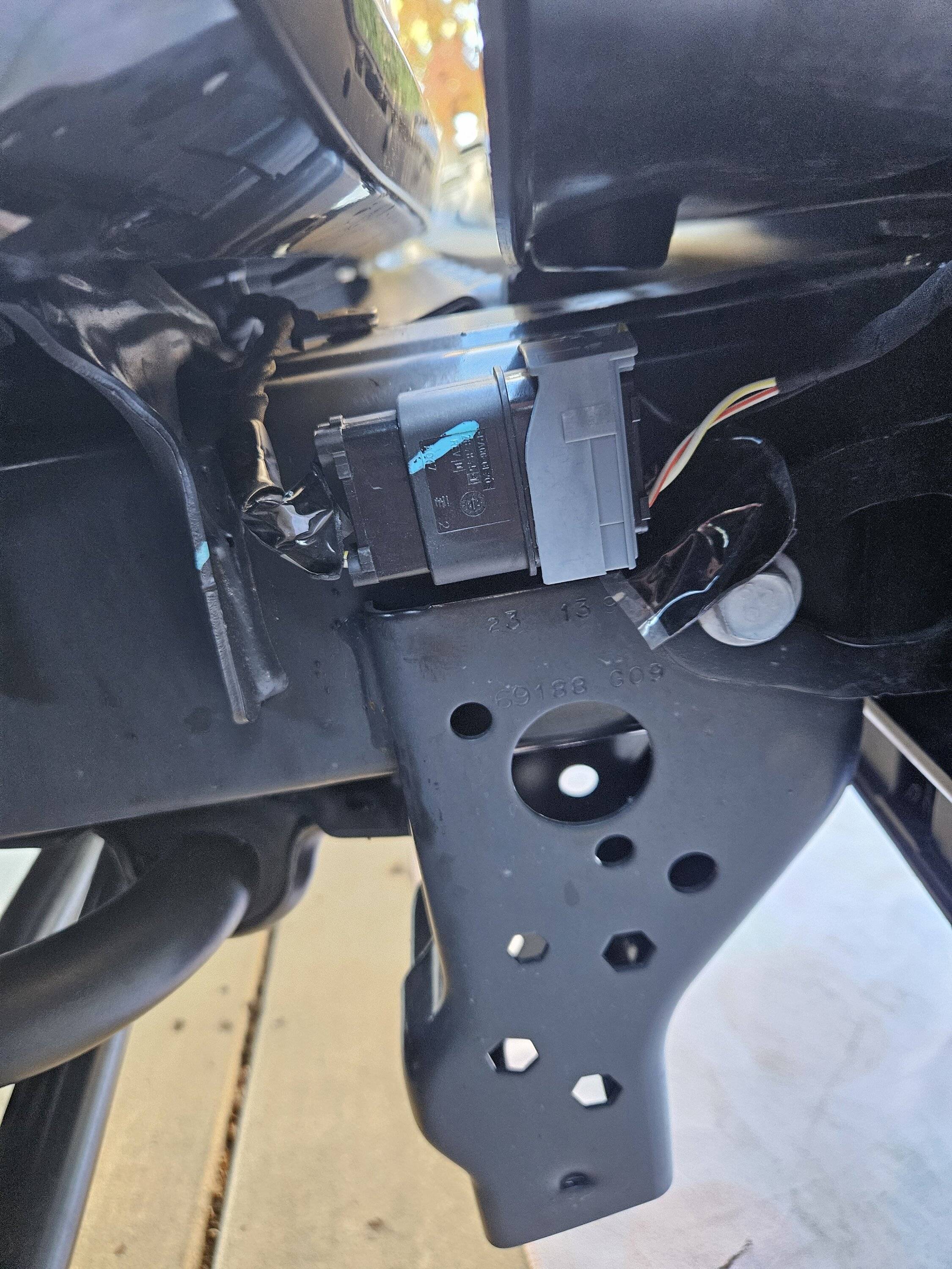

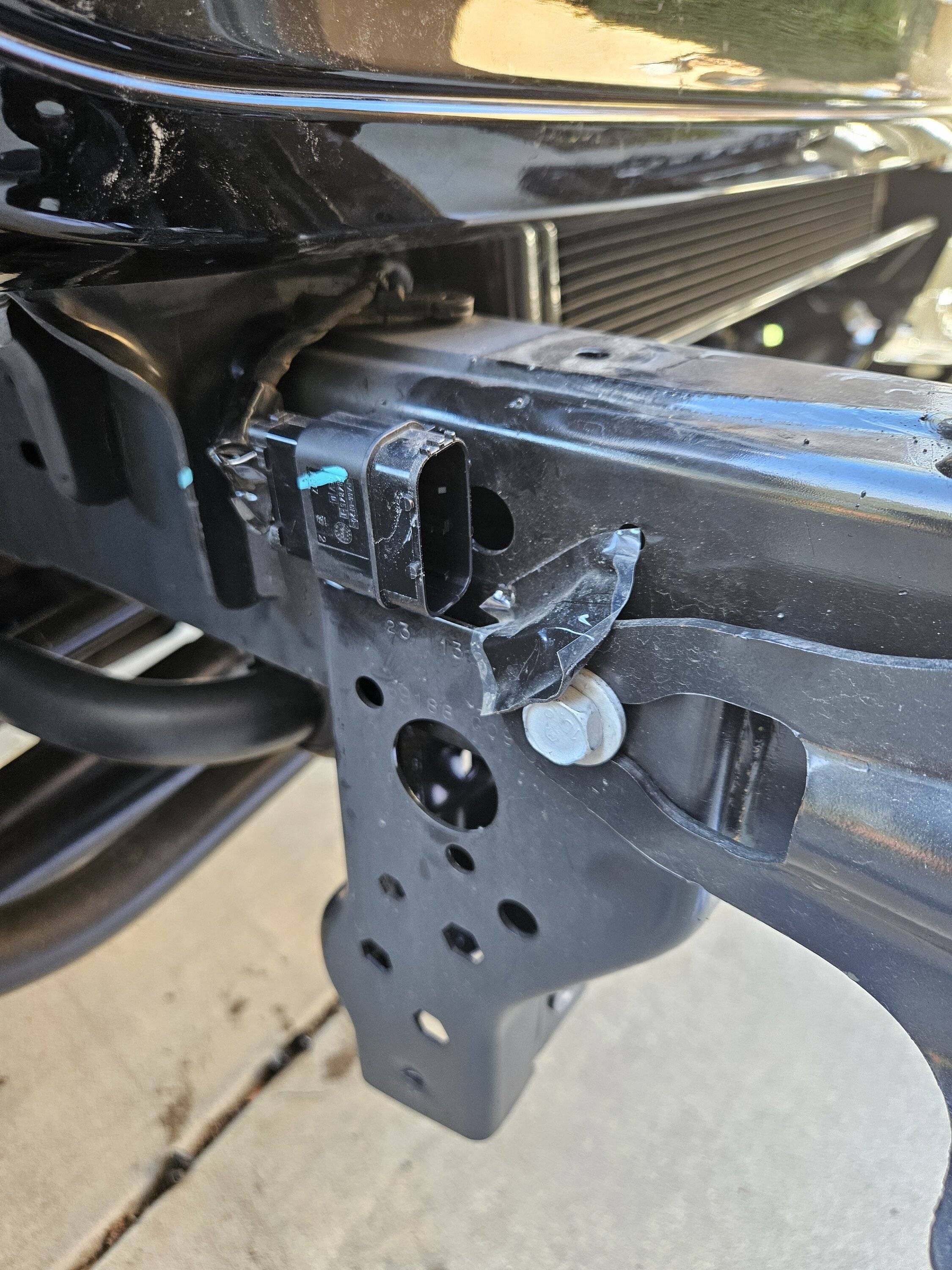

Just got a 2024 Willys and I'm trying to add a Rubicon Steel bumper. The connectors are completely different. I never had this issue with previous years. Any recommendations?

I took the wiring out of my plastic bumper and swapped it into the steel bumper. So stupid that they changed the wiring on the 2024
I’m lost how the hell do you unplug this damn harness

literally just did this 2 days ago. pull up on the gray part(it slides up) after pulling the little tab out a bit and then the connector just unplugs. I just pulled the harness from my stock plastic bumper and swapped it with the one in the steel bumper. after I was done I had a smack myself in the forehead moment. would have been easier to just remove the bumper end plugs and swap them around. the pins/wires can be removed from the connectors with a tiny screw driver or pin release tool.
Wow……. That was so easy…. Thank you sir….
