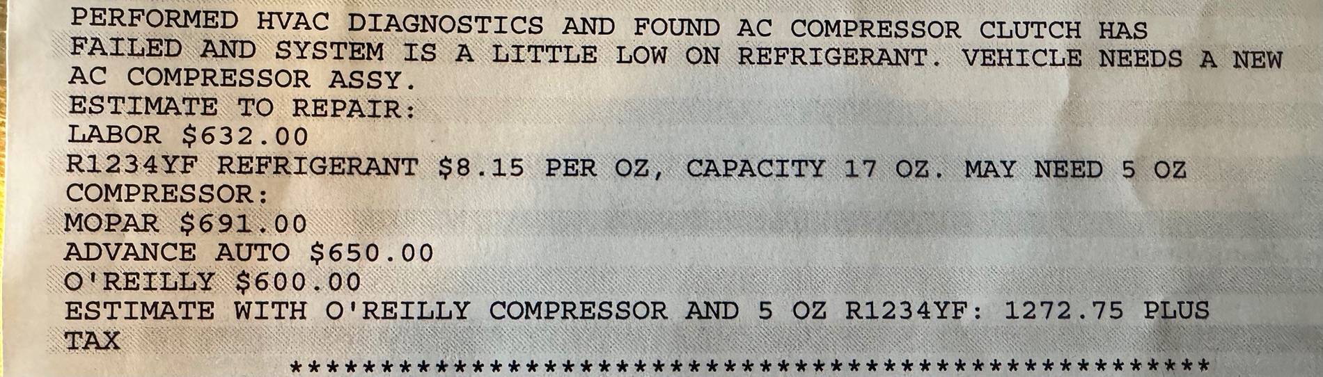

Hey, I need some advice. I was surprised to find out my Jeep had a AC clutch failure and was quoted 1200 to fix it. I can’t spend that much to fix it but wanted to try here for ideas. Unfortunately I’m over on miles for my warranty.
Is this something that you need to get a mechanic to fix or is it reasonable to attempt yourself?
Thanks

Sorry it’s the air conditioning clutch. I’m going to get the quote I will post it soon.

So I just spoke with the shop and he told me that you have to buy the compressor and the clutch as an assembly. I’m hoping he’s wrong just don’t know enough about them and struggled finding people with the same issue online.
I’m going to try and be optimistic and look on YouTube for those videos thanks for your reply!

I'm sorry, I'm just seeing that the shop already diagnosed the clutch as bad. If you trust the diagnosis, grab a kit like the one I linked earlier and swap it out. While you're there, swap out the coil and pulley as well.

Luckily the dealer decided to wave costs. Only had to pay 200 for a new AC Clutch assembly with labor.
