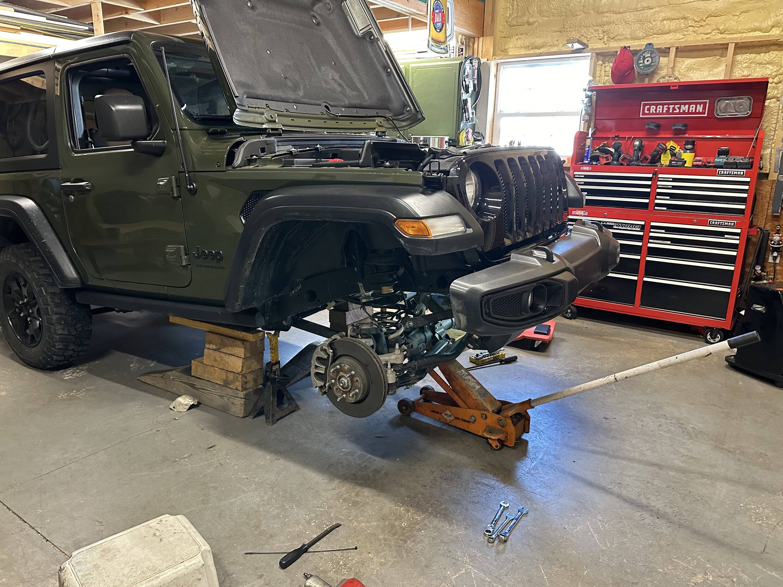

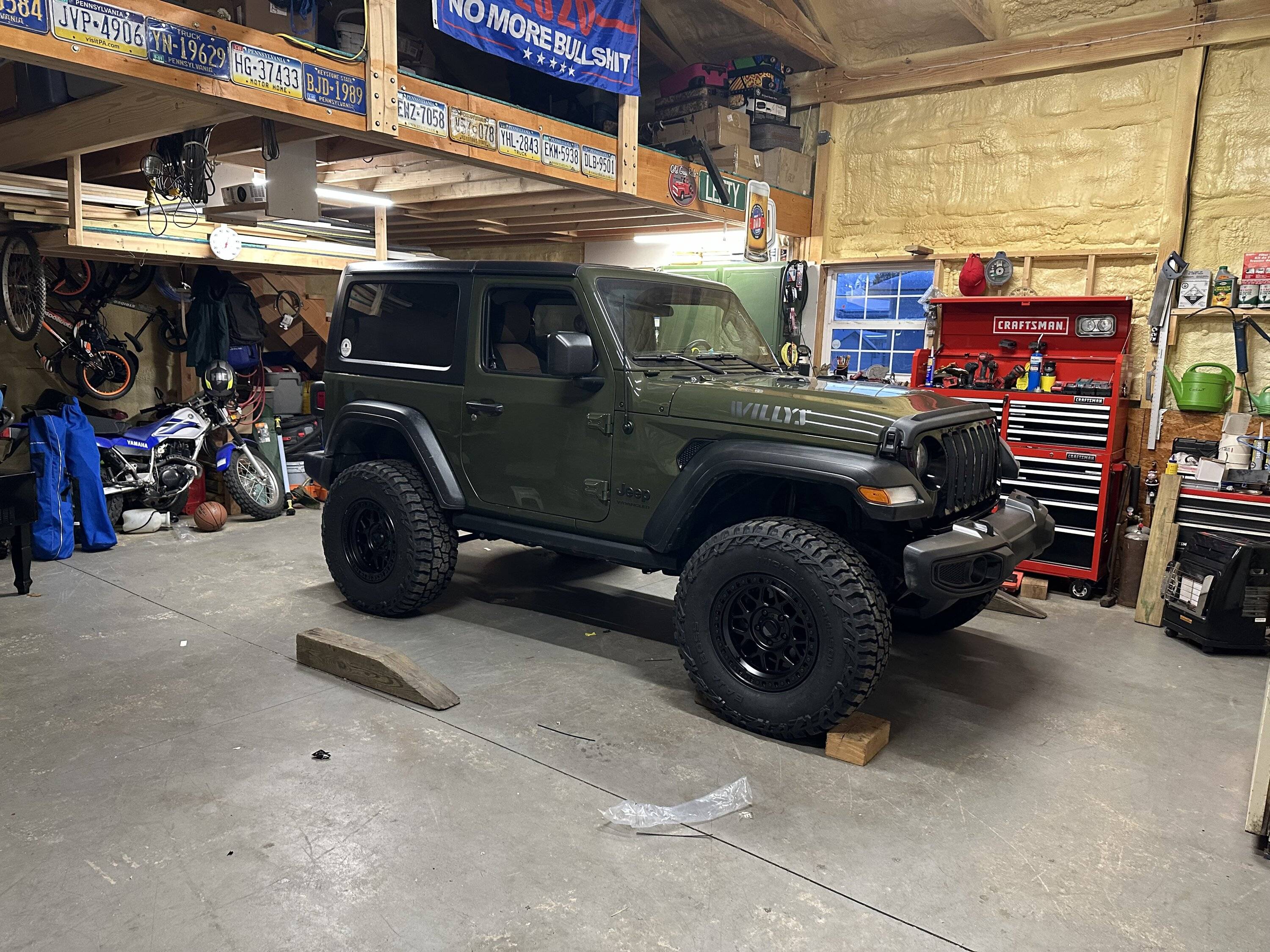

This weekend I did a 2.5 metal cloak true dual rate lift with the rock sport shocks.
35x12.5 KMC GRS wheels wrapped in MT Baja boss At tires.
next up is a bumper, and winch
gained probably around 4.5” tot
It actually rides significantly better than factory.

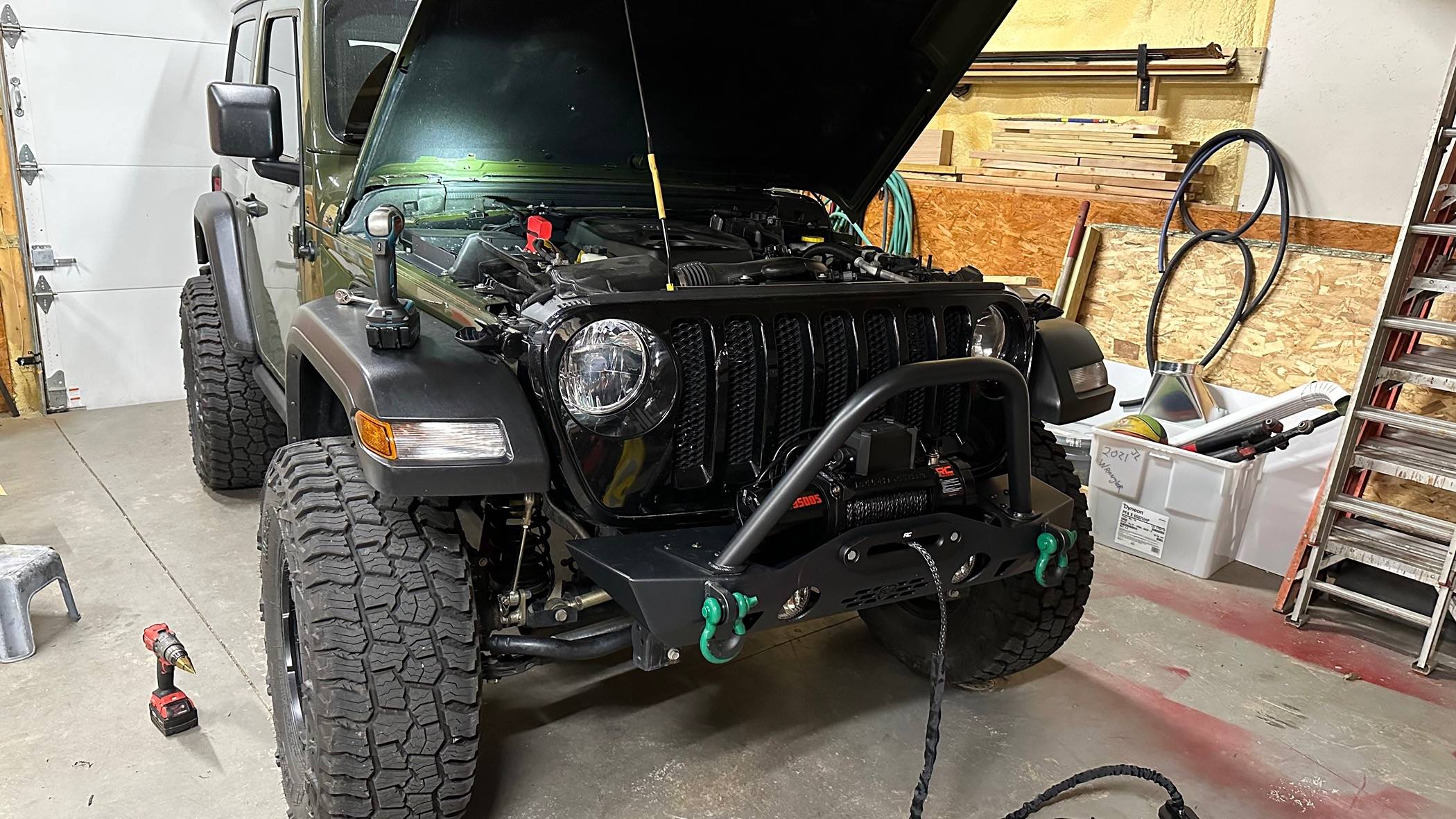

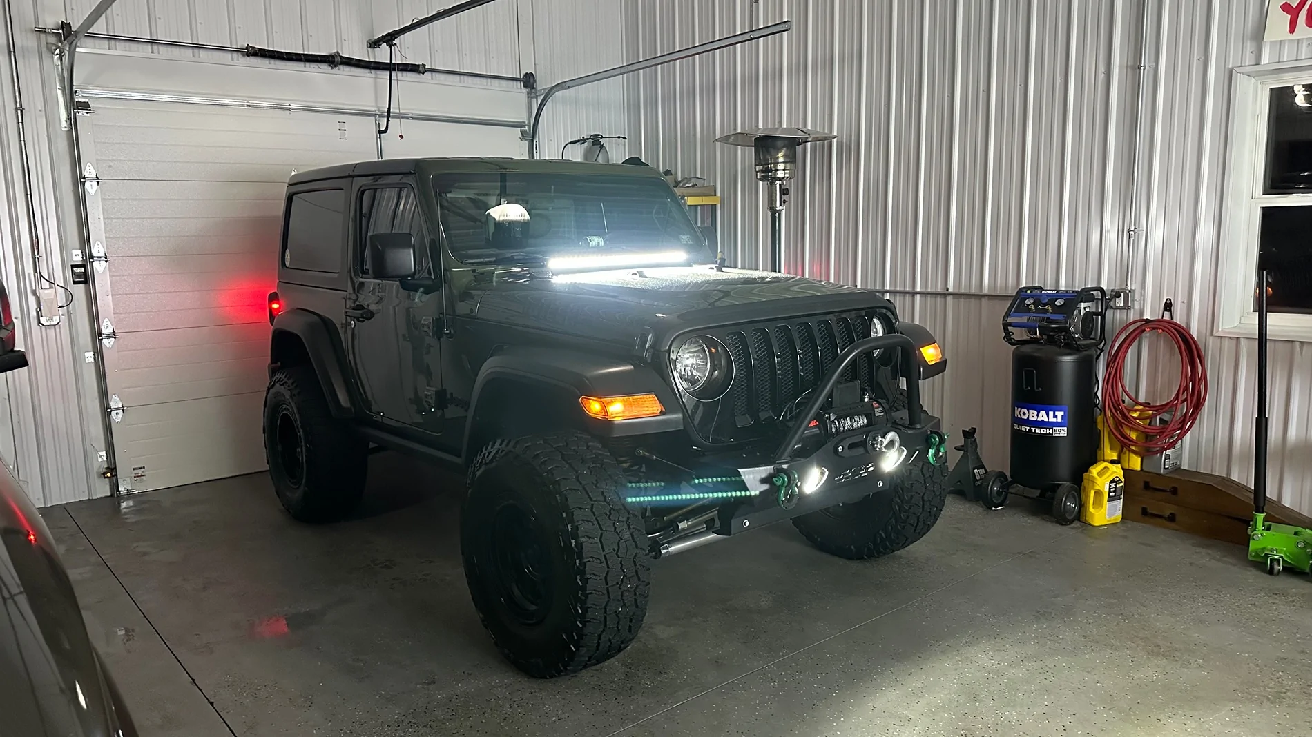

Put the last few touches on this project for now. Time to enjoy!
JCR Mauler stubby
RC 9500lb pro series winch
RC 30” hood mount light bar

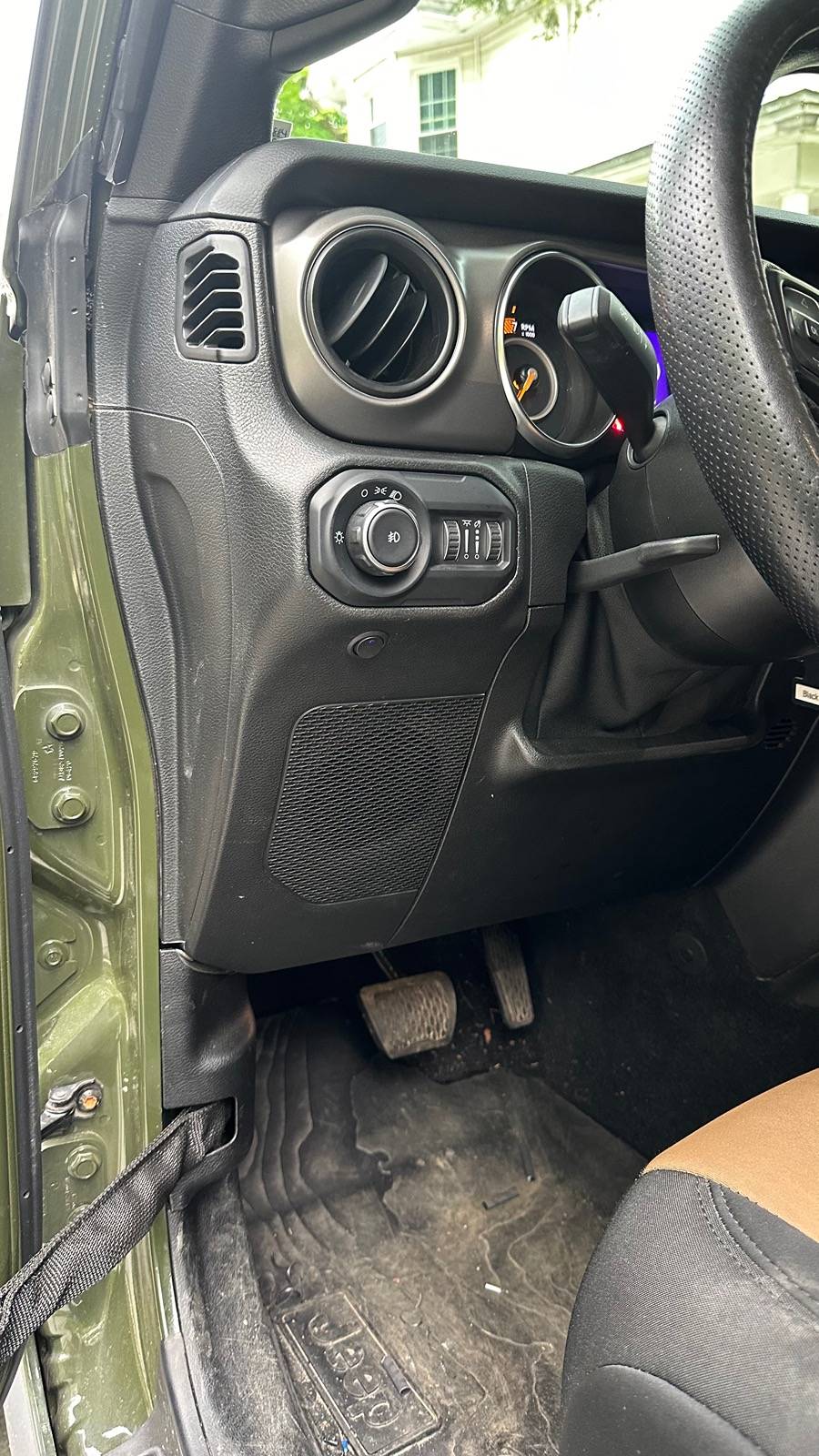

got the winch and light bar wired to switches I installed in the cab. Didn’t like the way rough country’s switch looked
Winch is on a solenoid to break 12v from battery. Have to finish that up yet to be 100%

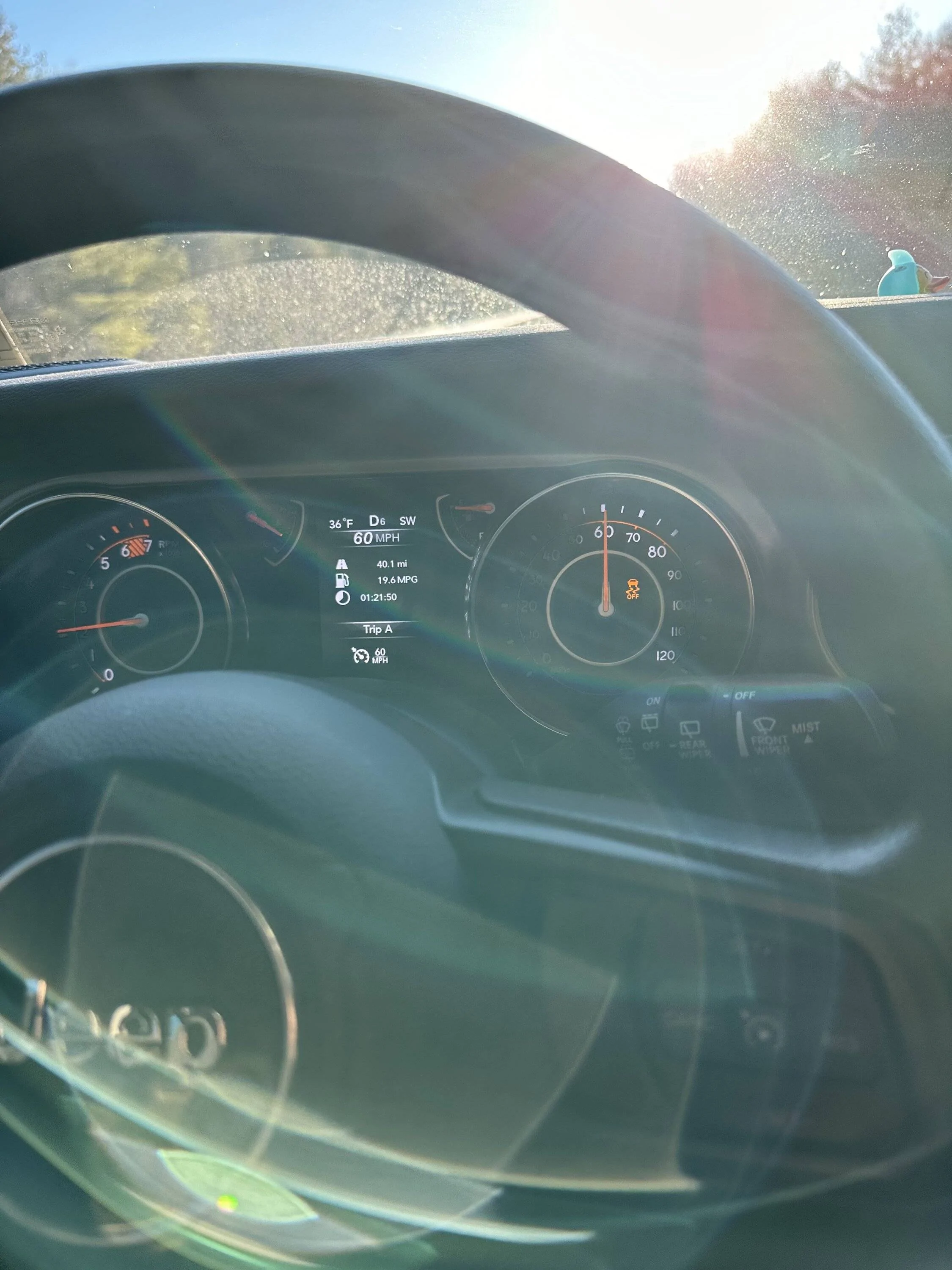

Yep, stock ratio. To be honest with you, it’s really not bad. I lost a few MPG with the lift and tires as well as the frequency of 8th gear (it still does see it)
Other than that it’s great
2.0T still has plenty of get up and go
These particular tires are much quieter than the factory MT’s.

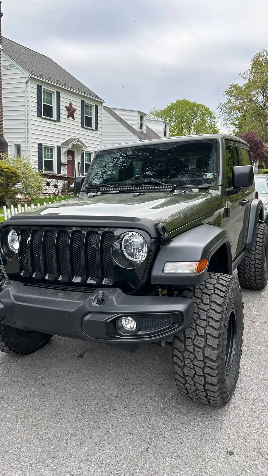

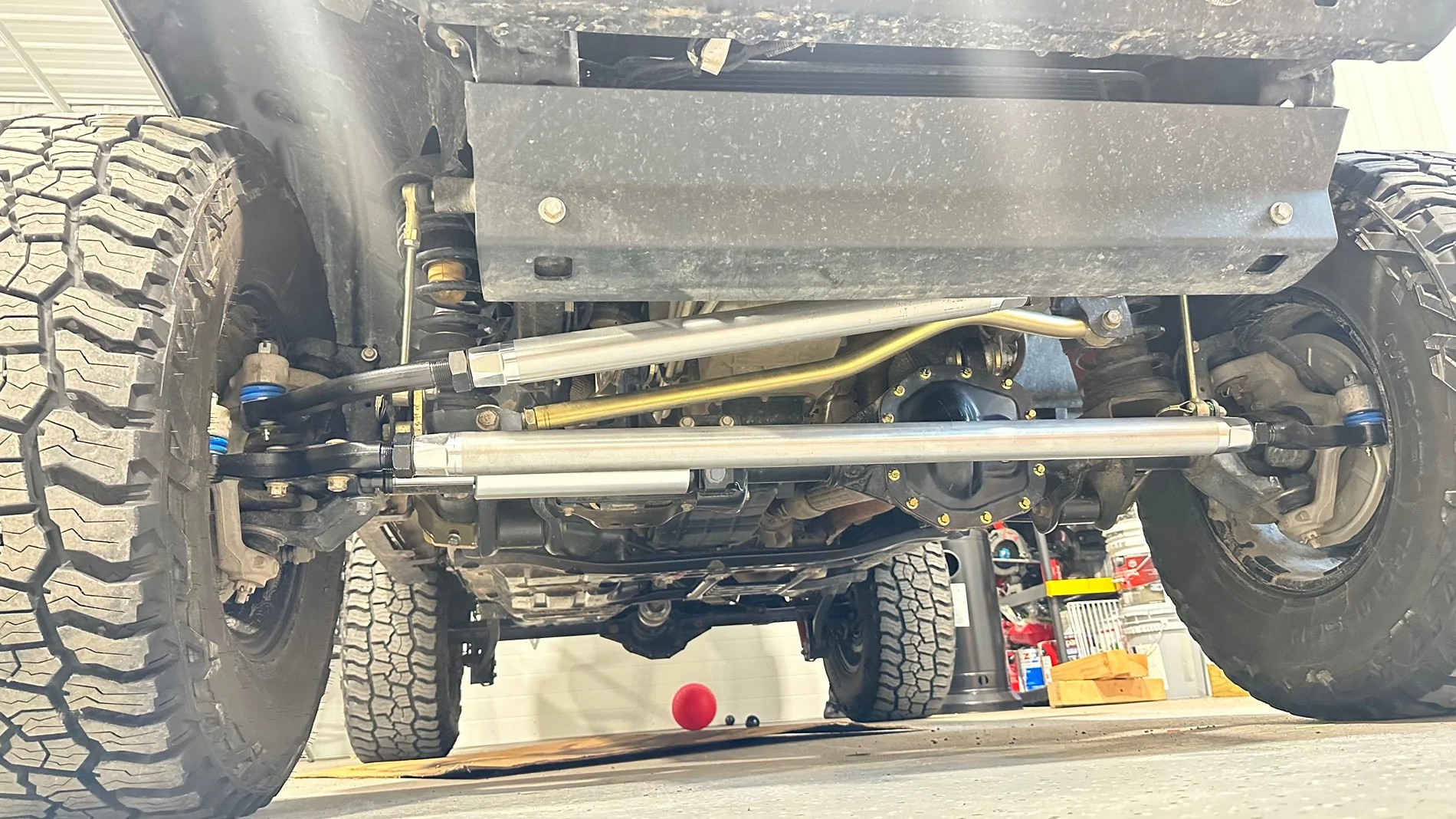

Some updates as of Recent include Cav Fab 2.5 ton steering as a got the wobbles after a hunting trip. Solved it but I still get a little shimmy/slop over a bump. Plan to replace the ball joints. Ordered up a set of Apex non knurled.
