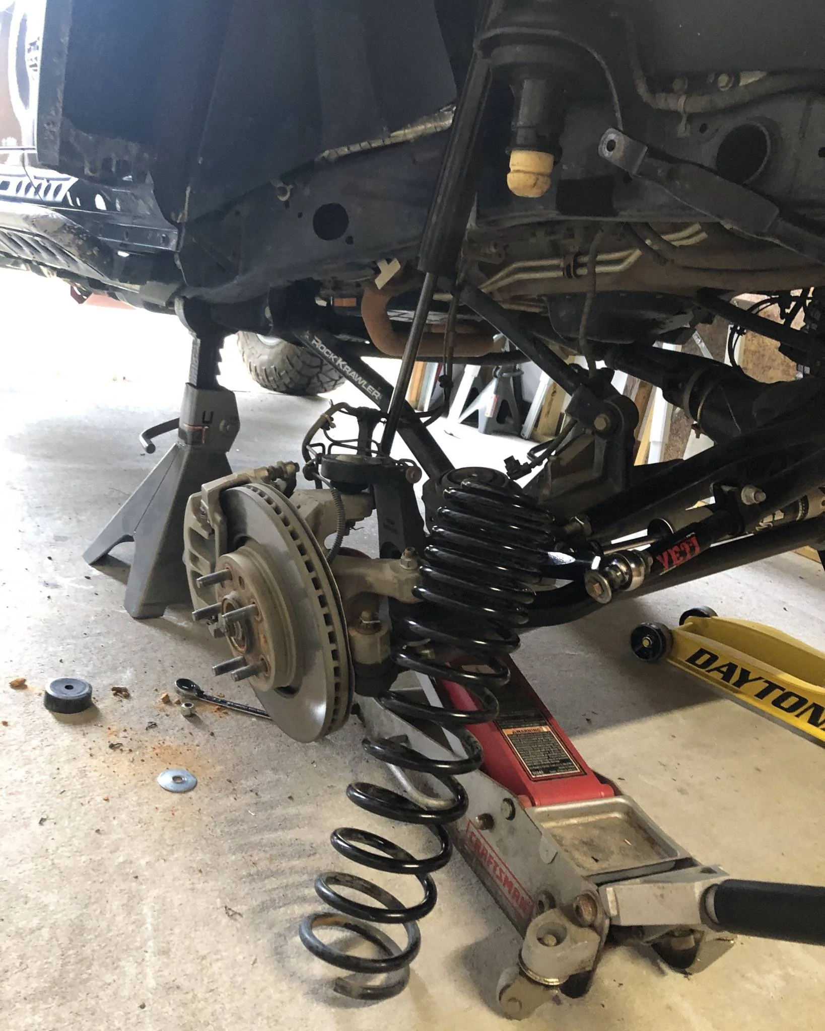

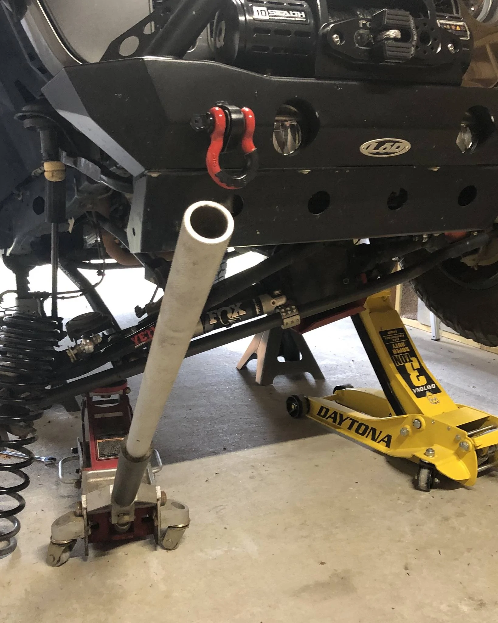

You can drop it enough…..remove the tires and jack up as high as you can and put jack stands under frame rails behind lca brackets. Then I use two floor jacks to manipulate axle . You might have to jack up opposite side to force axle down…….
Jeep Wrangler JL 2021 JLUR front springs need spring compressor? 9D544FE6-CCB7-4AD7-95F0-5A5CFE6613B4
Jeep Wrangler JL 2021 JLUR front springs need spring compressor? 6006C79F-CE31-49D9-9790-88A6064E933E
Thanks and great for adding pictures.
