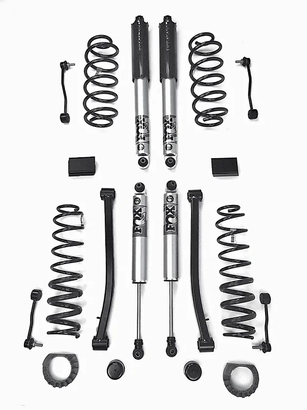

Up first, give this girl some new legs. Installing tomorrow:
  • Mopar 2" lift with Fox shocks (PN 77072522).
    • justforjeeps.com (best price, but I think I accidentally paid for shipping)

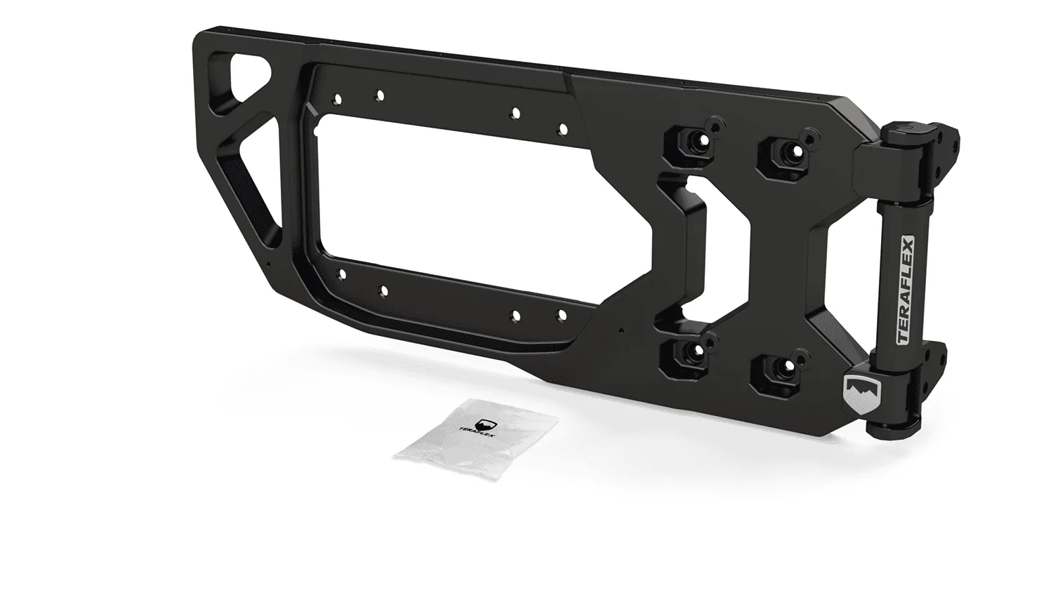

  • Teraflex Alpha HD Hinged Spare Tire Carrier Kit
  • Teraflex Alpha HD Adjustable Spare Tire Mount Kit w/ Brake Light & Camera Mounts
    • Off Road Warehouse locally

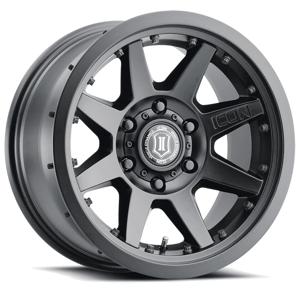

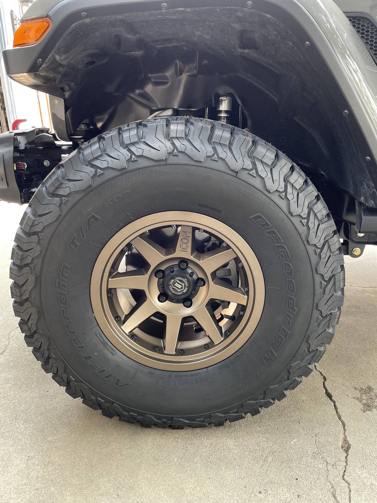

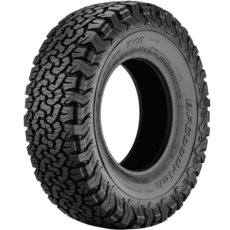

  • Icon Rebound Pro Satin Black
  • 37" BFG KO2s

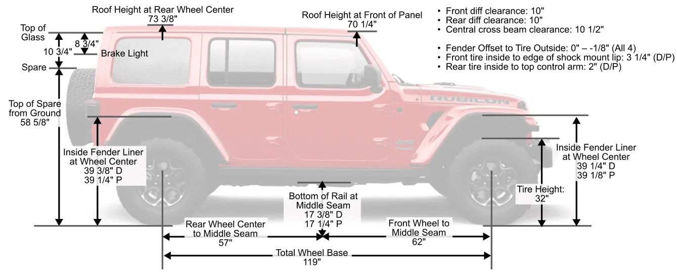

I couldn't get any straight information on the 4xe Rubicon dimensions before I bought mine. I saw that it was one inch taller than other JL Rubicons, but couldn't get total numbers. So, I measured everything in preparation for the lift. I'll post the updated dimensions after, but here is the "Before."
Jeep Wrangler JL 2021 Firecracker Red 4xe Rubicon 1627797629751
Heights:
  • Roof Height at rear wheel center, vehicle center: 73 3/8"
  • Roof Height at front side of freedom panel, passenger side: 70 1/4"
  • Tire Height 32"
  • Inside front fender at edge of liner: 39 1/4" Driver, 39 1/8" Passenger
  • Inside rear fender at edge of liner: 39 3/8" Driver, 39 1/4" Passenger
  • Top of spare tire height from ground: 58 5/8"
  • Top of spare to top of glass: 10 3/4"
  • Top of third brake light to top of glass: 8 3/4"
Clearances:
  • Rail clearance at middle body seam: 17 3/8" Driver, 17 1/4" Passenger
  • Front diff clearance: 10"
  • Rear diff clearance: 10"
  • Central cross beam clearance: 10 1/2"
Wheelbase:
  • Total wheelbase: 119"
  • Rear wheel center to middle body seam: 57"
  • Front wheel center to middle body seam: 62"
Tire width and spacing:
  • Fender Offset to Tire Outside: 0" – -1/8" (All 4 tires are slightly inset or flush with fender)
  • Front tire inside to edge of shock mount lip: 3 1/4"
  • Rear tire inside to top control arm: 2"
